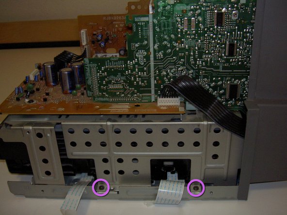

  16. Panasonic SA-PM17 CD Tray Unit Replacement: crwdns2935265:016crwdnd2935265:01crwdnd2935265:02crwdne2935265:0 Panasonic SA-PM17 CD Tray Unit Replacement: crwdns2935265:016crwdnd2935265:02crwdnd2935265:02crwdne2935265:0
    • Using a philips screwdriver, remove the four 9.5 mm screws indicated and place aside.

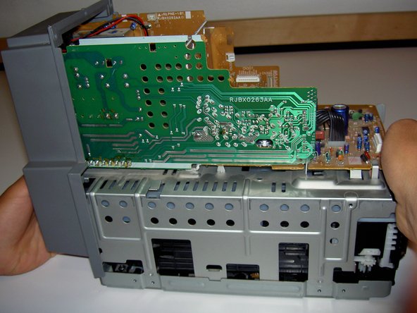

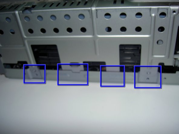

  17. Panasonic SA-PM17 CD Tray Unit Replacement: crwdns2935265:017crwdnd2935265:01crwdnd2935265:03crwdne2935265:0 Panasonic SA-PM17 CD Tray Unit Replacement: crwdns2935265:017crwdnd2935265:02crwdnd2935265:03crwdne2935265:0 Panasonic SA-PM17 CD Tray Unit Replacement: crwdns2935265:017crwdnd2935265:03crwdnd2935265:03crwdne2935265:0
    • Lift the body directly up off of the base and place aside.
    • Note the proper locations of the various tabs in the last picture.

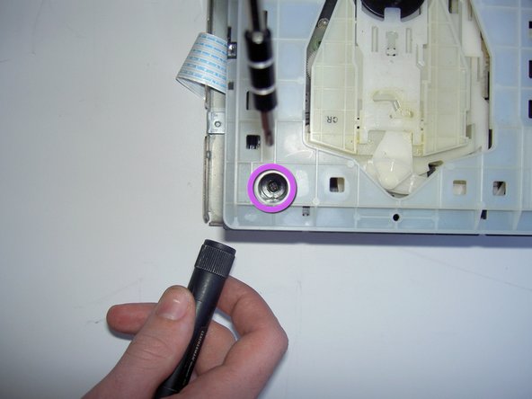

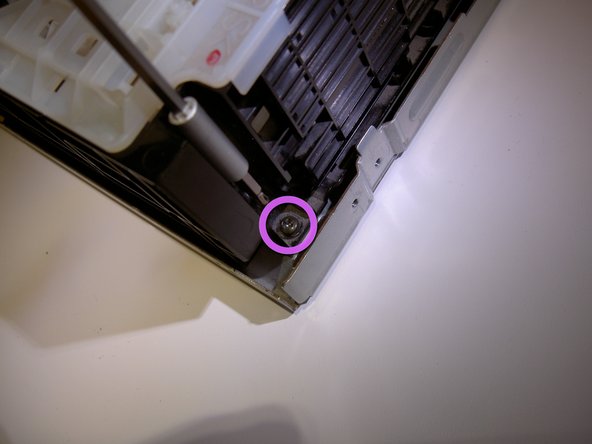

  18. Panasonic SA-PM17 CD Tray Unit Replacement: crwdns2935265:018crwdnd2935265:01crwdnd2935265:03crwdne2935265:0 Panasonic SA-PM17 CD Tray Unit Replacement: crwdns2935265:018crwdnd2935265:02crwdnd2935265:03crwdne2935265:0 Panasonic SA-PM17 CD Tray Unit Replacement: crwdns2935265:018crwdnd2935265:03crwdnd2935265:03crwdne2935265:0
    • Remove the two 9.5 mm screws indicated using an extended screwdriver.
    • Use a flashlight to view the screw on the left.
  19. Panasonic SA-PM17 CD Tray Unit Replacement: crwdns2935265:019crwdnd2935265:01crwdnd2935265:02crwdne2935265:0 Panasonic SA-PM17 CD Tray Unit Replacement: crwdns2935265:019crwdnd2935265:02crwdnd2935265:02crwdne2935265:0
