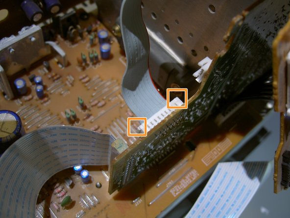

  7. Panasonic SA-PM17 CD Tray Cover Replacement: crwdns2935265:07crwdnd2935265:01crwdnd2935265:01crwdne2935265:0
    • Using forceps or fingers, remove the small black wire indicated.
    • Grip the wire near its base and pull gently but firmly until it pops out of the slot.

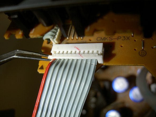

  8. Panasonic SA-PM17 CD Tray Cover Replacement: crwdns2935265:08crwdnd2935265:01crwdnd2935265:03crwdne2935265:0 Panasonic SA-PM17 CD Tray Cover Replacement: crwdns2935265:08crwdnd2935265:02crwdnd2935265:03crwdne2935265:0 Panasonic SA-PM17 CD Tray Cover Replacement: crwdns2935265:08crwdnd2935265:03crwdnd2935265:03crwdne2935265:0
    • This step deals with the indicated area of the device.
    • Using fingers or tweezers, lift the indicated tabs out until the cord's restraint looks like the final picture.
    • Gently pull on the cord near its base until it comes free of the restraint.

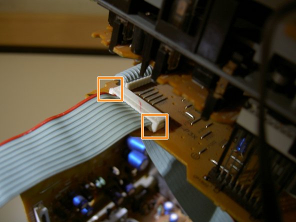

  10. Panasonic SA-PM17 CD Tray Cover Replacement: crwdns2935265:010crwdnd2935265:01crwdnd2935265:03crwdne2935265:0 Panasonic SA-PM17 CD Tray Cover Replacement: crwdns2935265:010crwdnd2935265:02crwdnd2935265:03crwdne2935265:0 Panasonic SA-PM17 CD Tray Cover Replacement: crwdns2935265:010crwdnd2935265:03crwdnd2935265:03crwdne2935265:0
    • This step deals with the indicated portion of the the device.
    • Lift the indicated tabs out until they look like the final picture.
    • Gently pull on the cord until it comes free of its restraint.

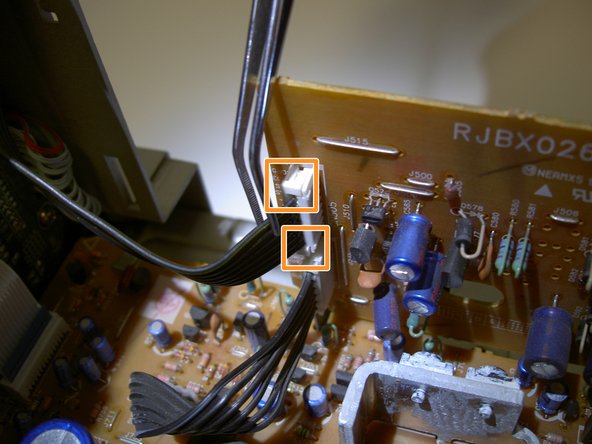

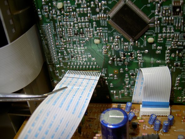

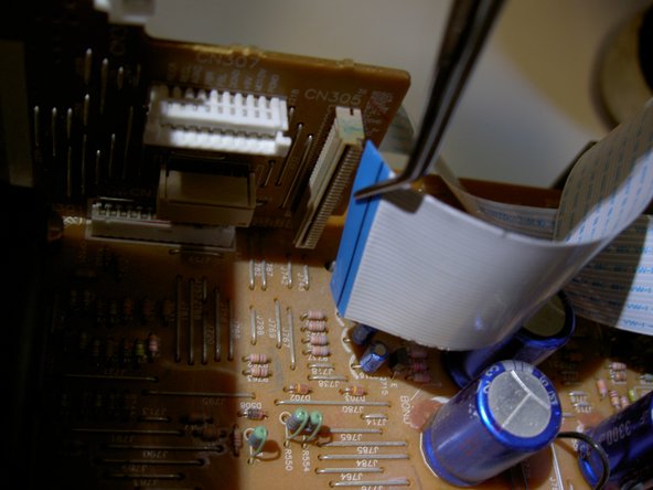

  11. Panasonic SA-PM17 CD Tray Cover Replacement: crwdns2935265:011crwdnd2935265:01crwdnd2935265:03crwdne2935265:0 Panasonic SA-PM17 CD Tray Cover Replacement: crwdns2935265:011crwdnd2935265:02crwdnd2935265:03crwdne2935265:0 Panasonic SA-PM17 CD Tray Cover Replacement: crwdns2935265:011crwdnd2935265:03crwdnd2935265:03crwdne2935265:0
    • Neither of the indicated cords have restraints on them like the previous ones. Use tweezers or fingers to pull firmly on the base of each cord until it comes free.

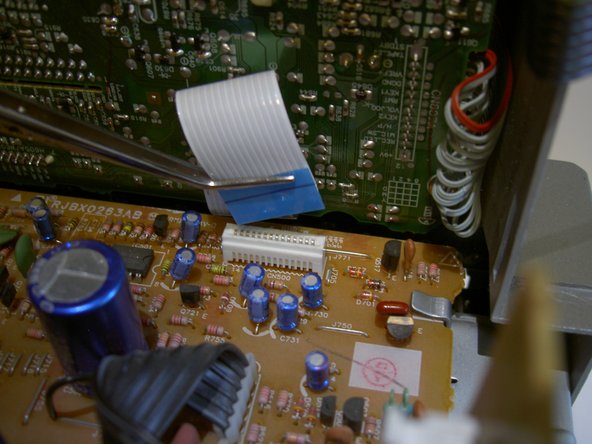

  12. Panasonic SA-PM17 CD Tray Cover Replacement: crwdns2935265:012crwdnd2935265:01crwdnd2935265:02crwdne2935265:0 Panasonic SA-PM17 CD Tray Cover Replacement: crwdns2935265:012crwdnd2935265:02crwdnd2935265:02crwdne2935265:0

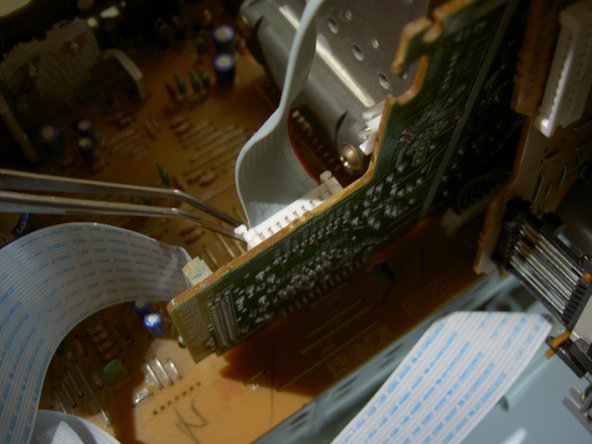

    • Use tweezers or fingers and firmly pull straight out on the cord until it comes free.

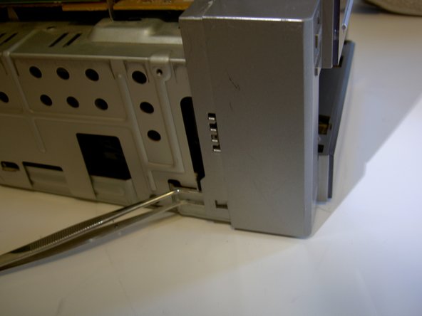

  13. Panasonic SA-PM17 CD Tray Cover Replacement: crwdns2935265:013crwdnd2935265:01crwdnd2935265:03crwdne2935265:0 Panasonic SA-PM17 CD Tray Cover Replacement: crwdns2935265:013crwdnd2935265:02crwdnd2935265:03crwdne2935265:0 Panasonic SA-PM17 CD Tray Cover Replacement: crwdns2935265:013crwdnd2935265:03crwdnd2935265:03crwdne2935265:0
    • Using tweezers or fingers, lift gently on the tab indicated to free the front from the body of the device.
    • Rotate device 180 degrees and repeat for other side.
    • Rotate the front slightly forward to keep the tabs from re-engaging on their hooks.

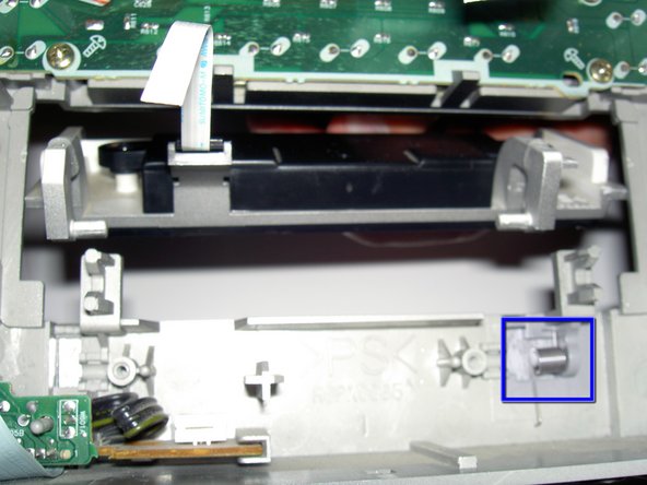

    • Remove the two 11.5 mm screws indicated and set aside in a safe place.

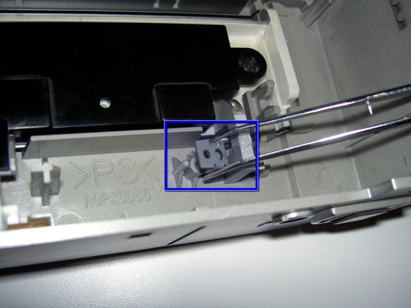

  16. Panasonic SA-PM17 CD Tray Cover Replacement: crwdns2935265:016crwdnd2935265:01crwdnd2935265:02crwdne2935265:0 Panasonic SA-PM17 CD Tray Cover Replacement: crwdns2935265:016crwdnd2935265:02crwdnd2935265:02crwdne2935265:0
    • Using tweezers, remove the two restraints indicated and place with the screws removed in the previous step.

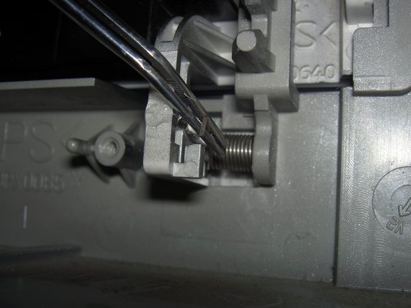

    • Remove the spring from its slot using tweezers.

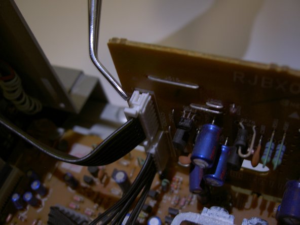

  18. Panasonic SA-PM17 CD Tray Cover Replacement: crwdns2935265:018crwdnd2935265:01crwdnd2935265:01crwdne2935265:0
    • Using tweezers or fingers, pull firmly on the base of this cord until it pops out of its slot.

    • Lift the pegs of the cover up while rotating the rest of the part down and out of the device.
    • If at first the cover does not come free, wiggle it around a bit until it does, but do not force it out.
    • Do not to lose this spring while replacing the cover.
