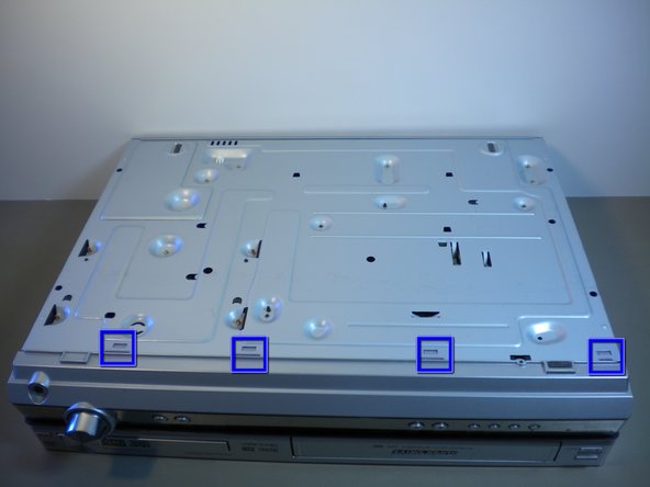

  4. Panasonic SA-HT810V VHS Drive Replacement: crwdns2935265:04crwdnd2935265:01crwdnd2935265:03crwdne2935265:0 Panasonic SA-HT810V VHS Drive Replacement: crwdns2935265:04crwdnd2935265:02crwdnd2935265:03crwdne2935265:0 Panasonic SA-HT810V VHS Drive Replacement: crwdns2935265:04crwdnd2935265:03crwdnd2935265:03crwdne2935265:0
    • Pull up the two tabs on top
    • Pull the the three tabs on the side there is one on the left and two and the right side of the device when it is facing you.
    • Depress the four tabs on the bottom of the device.

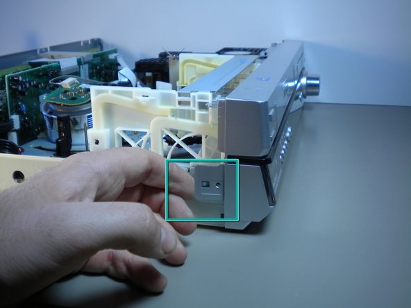

  5. Panasonic SA-HT810V VHS Drive Replacement: crwdns2935265:05crwdnd2935265:01crwdnd2935265:01crwdne2935265:0
    • Carefully pull off the front panel of the device.
    • The front is attached to the device with cables so be careful when removing.

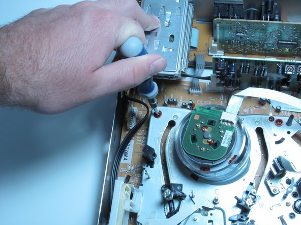

  6. Panasonic SA-HT810V VHS Drive Replacement: crwdns2935265:06crwdnd2935265:01crwdnd2935265:02crwdne2935265:0 Panasonic SA-HT810V VHS Drive Replacement: crwdns2935265:06crwdnd2935265:02crwdnd2935265:02crwdne2935265:0
    • With the device front facing you remove the six screws with a phillips head screwdriver around the VHS drive.
  7. Panasonic SA-HT810V VHS Drive Replacement: crwdns2935265:07crwdnd2935265:01crwdnd2935265:01crwdne2935265:0
    • Remove the three cables attaching the VHS to the Mother Board.
    • Carefully pull the VHS drive out of the device and follow the steps in reverse to place the new one in.
    • Make sure the cables connecting the VHS Drive are fully inserted before powering the machine on to prevent damage to the internal components.
