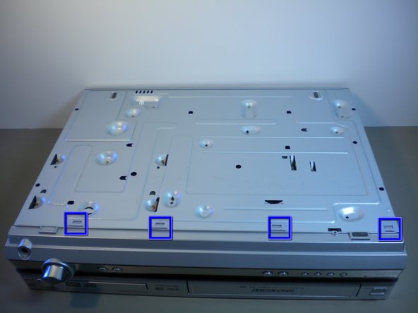

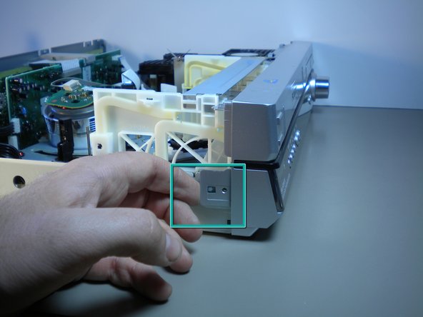

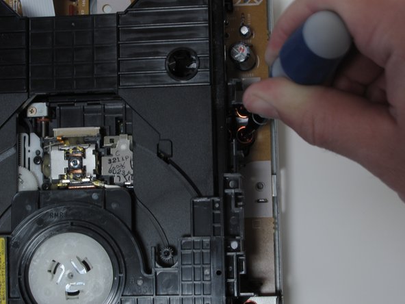

  4. Panasonic SA-HT810V DVD Drive Replacement: crwdns2935265:04crwdnd2935265:01crwdnd2935265:03crwdne2935265:0 Panasonic SA-HT810V DVD Drive Replacement: crwdns2935265:04crwdnd2935265:02crwdnd2935265:03crwdne2935265:0 Panasonic SA-HT810V DVD Drive Replacement: crwdns2935265:04crwdnd2935265:03crwdnd2935265:03crwdne2935265:0
    • Pull up the two tabs on top
    • Pull the the three tabs on the side. One is on the left, and two are on the right side of the device when it is facing you.
    • Depress the four tabs on the bottom of the device with a flat head screwdriver.
