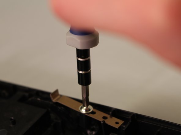

  2. Panasonic RQ-2102 Cassette Holder Spring Replacement: crwdns2935265:02crwdnd2935265:01crwdnd2935265:03crwdne2935265:0 Panasonic RQ-2102 Cassette Holder Spring Replacement: crwdns2935265:02crwdnd2935265:02crwdnd2935265:03crwdne2935265:0 Panasonic RQ-2102 Cassette Holder Spring Replacement: crwdns2935265:02crwdnd2935265:03crwdnd2935265:03crwdne2935265:0
    • Make sure the brass colored spring by the cassette door is in the correct position.
    • Remove the screw that holds the spring if broken.
    • Remove the spring from the device.
  3. Panasonic RQ-2102 Cassette Holder Spring Replacement: crwdns2935265:03crwdnd2935265:01crwdnd2935265:02crwdne2935265:0 Panasonic RQ-2102 Cassette Holder Spring Replacement: crwdns2935265:03crwdnd2935265:02crwdnd2935265:02crwdne2935265:0
    • Replace the old spring with the new spring, making sure that it is installed in the correct position.
    • Insert the screw back into position, ensuring that it holds the spring.
    • If the spring is loose, tighten the screw.
