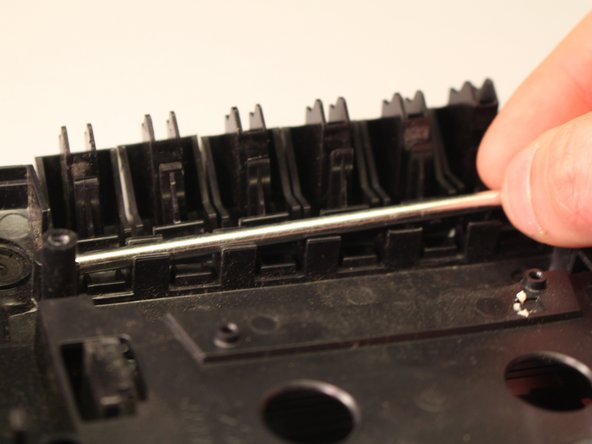

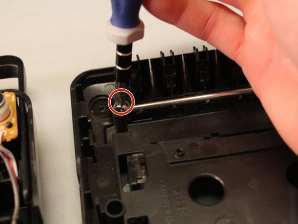

      • Remove screws from the sides of the silver button pin roller.
      • Pry out the silver bar
      • Remove the desired button

      • Insert the new button in place of the old button.
      • Put the silver pin roller back into its place over the buttons.
      • Put screws back into their original places by the sides of the silver pin roller.
