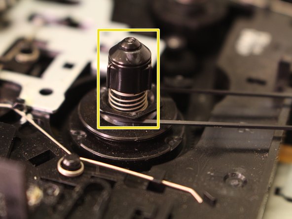

  2. Panasonic RQ-2102 Band on Three Digit Counter Replacement: crwdns2935265:02crwdnd2935265:01crwdnd2935265:03crwdne2935265:0 Panasonic RQ-2102 Band on Three Digit Counter Replacement: crwdns2935265:02crwdnd2935265:02crwdnd2935265:03crwdne2935265:0 Panasonic RQ-2102 Band on Three Digit Counter Replacement: crwdns2935265:02crwdnd2935265:03crwdnd2935265:03crwdne2935265:0
    • Carefully remove the band from the gear spindle.
    • Dispose of the old, broken band.
  3. Panasonic RQ-2102 Band on Three Digit Counter Replacement: crwdns2935265:03crwdnd2935265:01crwdnd2935265:03crwdne2935265:0 Panasonic RQ-2102 Band on Three Digit Counter Replacement: crwdns2935265:03crwdnd2935265:02crwdnd2935265:03crwdne2935265:0 Panasonic RQ-2102 Band on Three Digit Counter Replacement: crwdns2935265:03crwdnd2935265:03crwdnd2935265:03crwdne2935265:0
    • Insert the new band into the gear spindle.
    • Twist the black spindle to make sure the counter works.
    • If the counter does not work, ensure the band is not broken due to installation.
