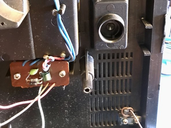

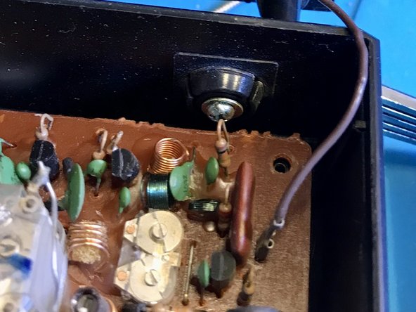

    3. Panasonic RF-1101 Radio Disassembly, Unhook the Antenna Connector ont he right side.: crwdns2935265:03crwdnd2935265:01crwdnd2935265:03crwdne2935265:0 Panasonic RF-1101 Radio Disassembly, Unhook the Antenna Connector ont he right side.: crwdns2935265:03crwdnd2935265:02crwdnd2935265:03crwdne2935265:0 Panasonic RF-1101 Radio Disassembly, Unhook the Antenna Connector ont he right side.: crwdns2935265:03crwdnd2935265:03crwdnd2935265:03crwdne2935265:0
      • Wire on the right is the Antenna Wire. It Attaches to the board by a connector. Unhook it so the back will lay over.
    4. Panasonic RF-1101 Radio Disassembly, Transformer and Battery connector: crwdns2935265:04crwdnd2935265:01crwdnd2935265:02crwdne2935265:0 Panasonic RF-1101 Radio Disassembly, Transformer and Battery connector: crwdns2935265:04crwdnd2935265:02crwdnd2935265:02crwdne2935265:0
      • The transformer for AC and the Battery connector for DC

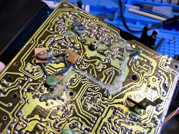

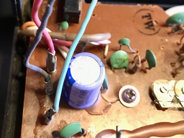

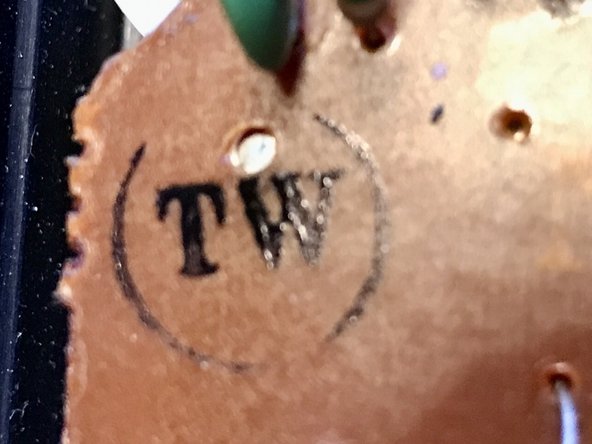

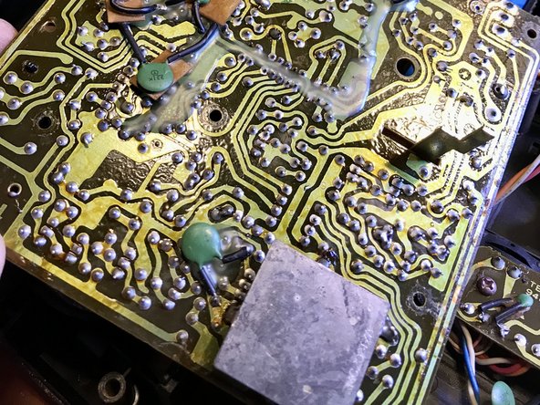

    5. Panasonic RF-1101 Radio Disassembly, Board View: crwdns2935265:05crwdnd2935265:01crwdnd2935265:03crwdne2935265:0 Panasonic RF-1101 Radio Disassembly, Board View: crwdns2935265:05crwdnd2935265:02crwdnd2935265:03crwdne2935265:0 Panasonic RF-1101 Radio Disassembly, Board View: crwdns2935265:05crwdnd2935265:03crwdnd2935265:03crwdne2935265:0
      • Board view of top and bottom of board. Remove 3 screws to take thew board out. Remember the one screw with washer in the left top. Also note the position of the screws as the screws in the back also go through the board.

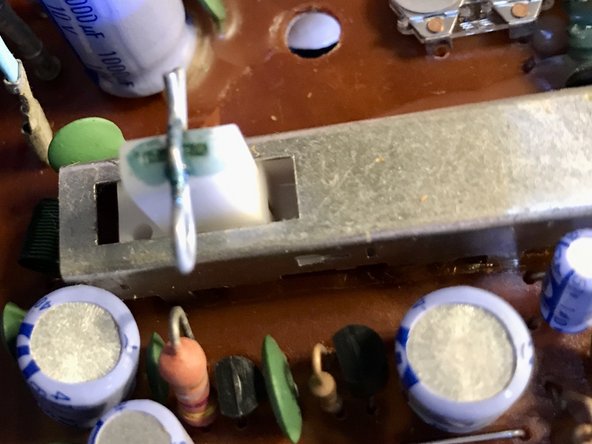

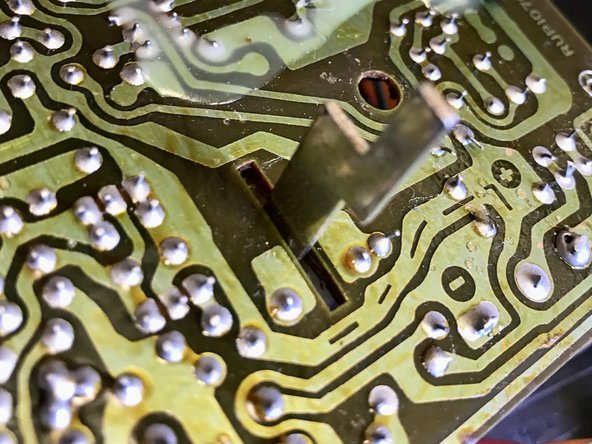

    6. Panasonic RF-1101 Radio Disassembly, Battery or AC selector: crwdns2935265:06crwdnd2935265:01crwdnd2935265:03crwdne2935265:0 Panasonic RF-1101 Radio Disassembly, Battery or AC selector: crwdns2935265:06crwdnd2935265:02crwdnd2935265:03crwdne2935265:0 Panasonic RF-1101 Radio Disassembly, Battery or AC selector: crwdns2935265:06crwdnd2935265:03crwdnd2935265:03crwdne2935265:0
      • The battery, off and AC selector runs through the front on to the back of the unit. Use Deoxit ont he slider in the front and the unit to the back of board. in 3 places. As shown

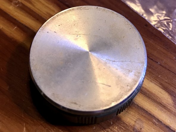

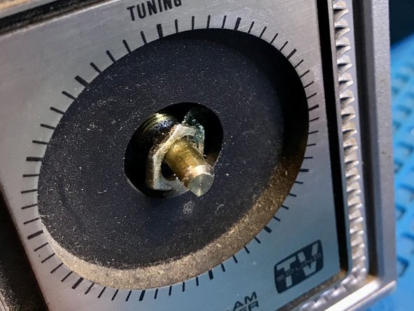

    7. Panasonic RF-1101 Radio Disassembly, Tunner Knob: crwdns2935265:07crwdnd2935265:01crwdnd2935265:03crwdne2935265:0 Panasonic RF-1101 Radio Disassembly, Tunner Knob: crwdns2935265:07crwdnd2935265:02crwdnd2935265:03crwdne2935265:0 Panasonic RF-1101 Radio Disassembly, Tunner Knob: crwdns2935265:07crwdnd2935265:03crwdnd2935265:03crwdne2935265:0
      • Using Deoxit to clean and lubricate the tuning knob to clear up static and crackling.
    8. Panasonic RF-1101 Radio Disassembly, Tunning Knob and volume: crwdns2935265:08crwdnd2935265:01crwdnd2935265:03crwdne2935265:0 Panasonic RF-1101 Radio Disassembly, Tunning Knob and volume: crwdns2935265:08crwdnd2935265:02crwdnd2935265:03crwdne2935265:0 Panasonic RF-1101 Radio Disassembly, Tunning Knob and volume: crwdns2935265:08crwdnd2935265:03crwdnd2935265:03crwdne2935265:0
      • The Tuning knob pulls off front and the tuning mechanism unscrews with the nut. Deoxit clears up the crackling on the volume slider as well.

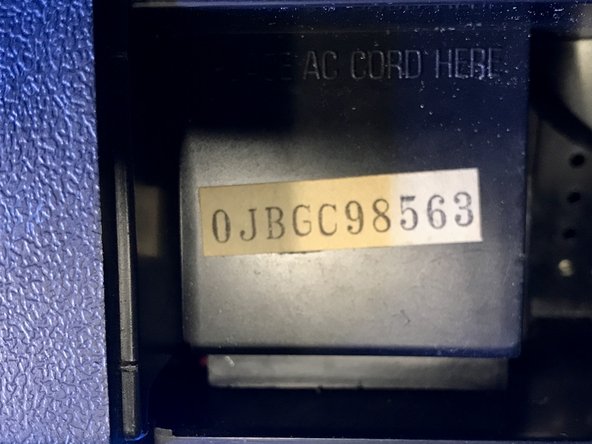

    9. Panasonic RF-1101 Radio Disassembly, Speaker Ohms and Numbers: crwdns2935265:09crwdnd2935265:01crwdnd2935265:03crwdne2935265:0 Panasonic RF-1101 Radio Disassembly, Speaker Ohms and Numbers: crwdns2935265:09crwdnd2935265:02crwdnd2935265:03crwdne2935265:0 Panasonic RF-1101 Radio Disassembly, Speaker Ohms and Numbers: crwdns2935265:09crwdnd2935265:03crwdnd2935265:03crwdne2935265:0
      • Speaker is 8 Ohm and the numbers found on the board and the back of unit.
