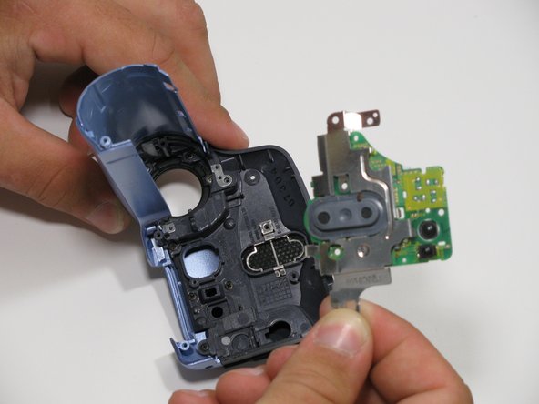

  10. Panasonic PV-GS9 Microphone Replacement, Microphone: crwdns2935265:010crwdnd2935265:01crwdnd2935265:01crwdne2935265:0
    • Using a #00 phillips screwdriver, remove the four 4mm screws holding the circuit board in place.
  11. Panasonic PV-GS9 Microphone Replacement: crwdns2935265:011crwdnd2935265:01crwdnd2935265:02crwdne2935265:0 Panasonic PV-GS9 Microphone Replacement: crwdns2935265:011crwdnd2935265:02crwdnd2935265:02crwdne2935265:0
    • Remove the circuit board containing the ribbon cable, microphone, and infared sensor.
