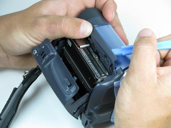

    • Locate the blue plastic tool opener, then remove both the round record/playback and record/power control knobs by prying it open from the camcorder.

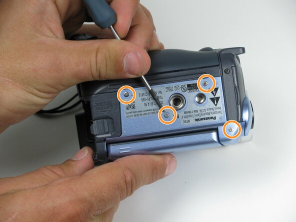

    • Open the tape compartment.
    • Flip over the camcorder and find the two 4.5mm screws, which are approximately 2 inches apart.
    • Using a #00 Phillips screwdriver, remove the screws

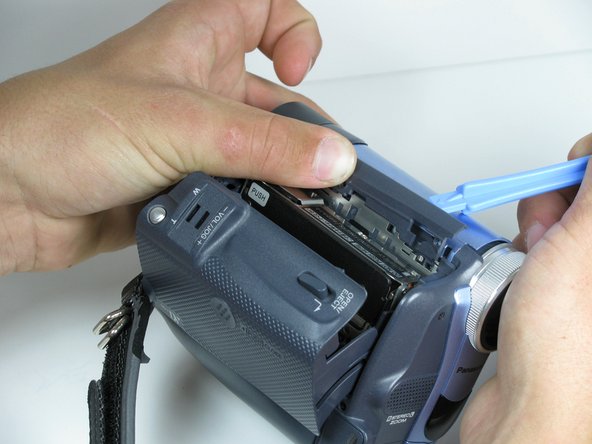

  3. Panasonic PV-GS9 LCD panel replacement: crwdns2935265:03crwdnd2935265:01crwdnd2935265:03crwdne2935265:0 Panasonic PV-GS9 LCD panel replacement: crwdns2935265:03crwdnd2935265:02crwdnd2935265:03crwdne2935265:0 Panasonic PV-GS9 LCD panel replacement: crwdns2935265:03crwdnd2935265:03crwdnd2935265:03crwdne2935265:0
    • Use a plastic prying tool, remove the gray trim piece by opening and gently prying it off from top of the camcorder.
    • Be gentle when removing the trim piece. The plastic parts are fragile and can break easily.

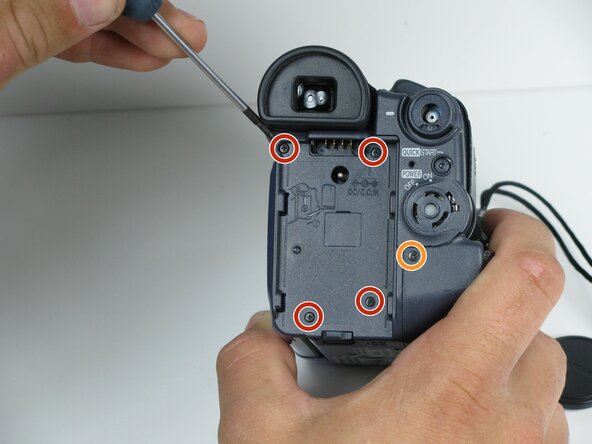

  4. Panasonic PV-GS9 LCD panel replacement: crwdns2935265:04crwdnd2935265:01crwdnd2935265:01crwdne2935265:0
    • Rotate the camcorder so that the camera lens is facing you.
    • Remove the four black 4.5mm screws, sitting behind the battery.
    • Remove the 5th screw to the right of the battery dock.
    • Remove the battery by gently pulling away from the camcorder.
    • Organize the screws in a sorting compartment to avoid losing them.

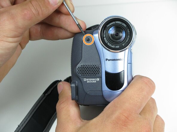

  5. Panasonic PV-GS9 LCD panel replacement: crwdns2935265:05crwdnd2935265:01crwdnd2935265:02crwdne2935265:0 Panasonic PV-GS9 LCD panel replacement: crwdns2935265:05crwdnd2935265:02crwdnd2935265:02crwdne2935265:0
    • Rotate the camcorder so that the tape compartment is facing you.
    • Remove the single 4.5mm black screw above the hook for the hand strap.
    • Undoing the strap on one end may help.
    • Rotate the camcorder so that the lens is facing you.
    • Remove the single 4.5mm black screw from the front panel.

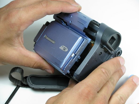

  7. Panasonic PV-GS9 LCD panel replacement: crwdns2935265:07crwdnd2935265:01crwdnd2935265:01crwdne2935265:0
    • Open the LCD screen on the side of the camcorder.
    • Using a #00 screwdriver, remove the two 4.5mm silver screws located on either side of the hinge of the LCD screen.

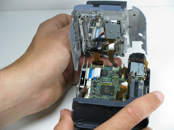

  8. Panasonic PV-GS9 LCD panel replacement: crwdns2935265:08crwdnd2935265:01crwdnd2935265:02crwdne2935265:0 Panasonic PV-GS9 LCD panel replacement: crwdns2935265:08crwdnd2935265:02crwdnd2935265:02crwdne2935265:0
    • Carefully detatch the front cover from the body of the camcorder.
    • This should come apart with relative ease; however, a plastic pryer tool may help remove the panel if it is struggling to come apart.
    • Be careful as there is a ribbon cable attached to the front panel and the camcorder body, DO NOT tug at it when you remove this panel.

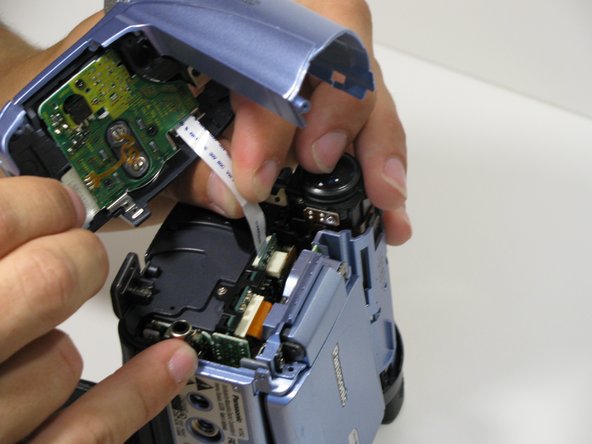

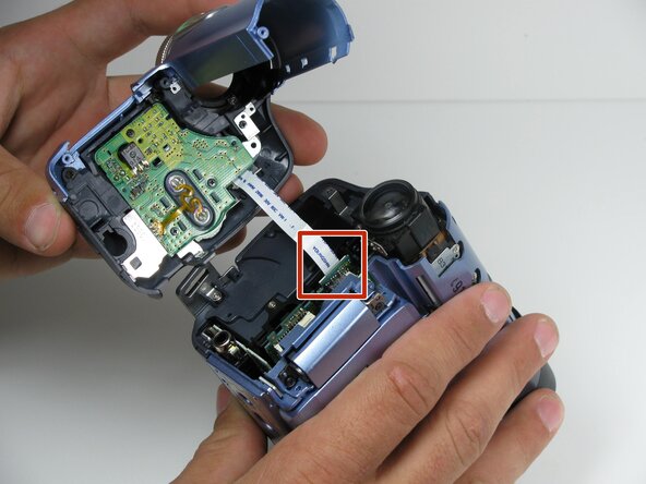

  9. Panasonic PV-GS9 LCD panel replacement: crwdns2935265:09crwdnd2935265:01crwdnd2935265:02crwdne2935265:0 Panasonic PV-GS9 LCD panel replacement: crwdns2935265:09crwdnd2935265:02crwdnd2935265:02crwdne2935265:0
    • Using your fingers, carefully pull the ribbon cable away from the logic board to disconnect it.

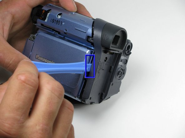

  11. Panasonic PV-GS9 LCD panel replacement: crwdns2935265:011crwdnd2935265:01crwdnd2935265:03crwdne2935265:0 Panasonic PV-GS9 LCD panel replacement: crwdns2935265:011crwdnd2935265:02crwdnd2935265:03crwdne2935265:0 Panasonic PV-GS9 LCD panel replacement: crwdns2935265:011crwdnd2935265:03crwdnd2935265:03crwdne2935265:0

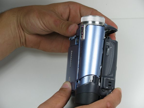

    • Place a plastic opening tool under the bottom of the blue panel beneath the camcorder.
    • Move the plastic opening tool up the side of the camcorder as shown. Carefully separate the LCD panel from the rest of the camcorder.
    • Remove the panel from the camcorder.
    • Using two tools can help for stability.

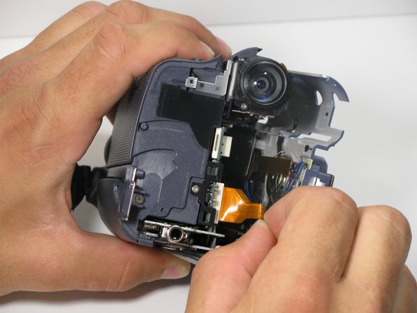

  12. Panasonic PV-GS9 LCD panel replacement: crwdns2935265:012crwdnd2935265:01crwdnd2935265:03crwdne2935265:0 Panasonic PV-GS9 LCD panel replacement: crwdns2935265:012crwdnd2935265:02crwdnd2935265:03crwdne2935265:0 Panasonic PV-GS9 LCD panel replacement: crwdns2935265:012crwdnd2935265:03crwdnd2935265:03crwdne2935265:0
    • Before removing the LCD panel from the camcorder, disconnect all the ribbon cables joining the LCD panel to the logic board.
    • There may be multiple ribbon cables attached to the same point on the logic board.
