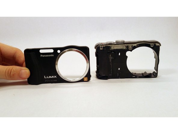

    • Using the plastic prying tool, remove the cover of the camera that is on the same side as your LCD screen. This cover should come off relatively easily, and will expose the motherboard that the screen is connected to.

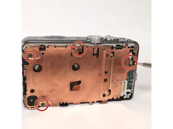

    • After the screen has been removed, the main motherboard is directly underneath it. There is a bronze, metal separation piece that separates the main motherboard from the one connected to the lens. This metal piece is held in with 4 screws. Remove these 4 screws and the metal piece will be free.

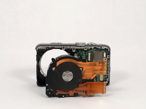

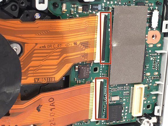

    • Once the plastic riser is removed, it is time to remove the lens. To do this, simply follow the data strips (2) that connect the lens to the main motherboard and unclip them by turning the black bar into a position that is perpendicular to the motherboard. Once these clips are open, the data strips and the lens should simply slide out.

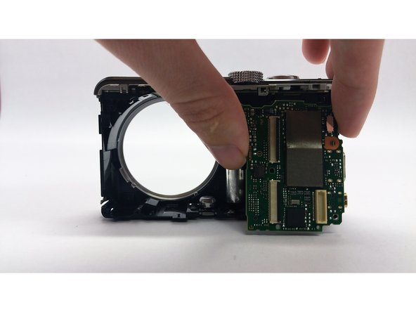

  8. Panasonic Lumx DMC-ZS19 Capture Button Replacement, Motherboard: crwdns2935265:08crwdnd2935265:01crwdnd2935265:01crwdne2935265:0
    • After the lens has been removed, there is only one screw that holds the main motherboard in place. Remove this screw, located on the right side of the motherboard, and remove it.
  9. Panasonic Lumx DMC-ZS19 Capture Button Replacement: crwdns2935265:09crwdnd2935265:01crwdnd2935265:03crwdne2935265:0 Panasonic Lumx DMC-ZS19 Capture Button Replacement: crwdns2935265:09crwdnd2935265:02crwdnd2935265:03crwdne2935265:0 Panasonic Lumx DMC-ZS19 Capture Button Replacement: crwdns2935265:09crwdnd2935265:03crwdnd2935265:03crwdne2935265:0
    • Once the screw has been removed, the motherboard should pop right out. If you're having difficulties, use the plastic prying tool.

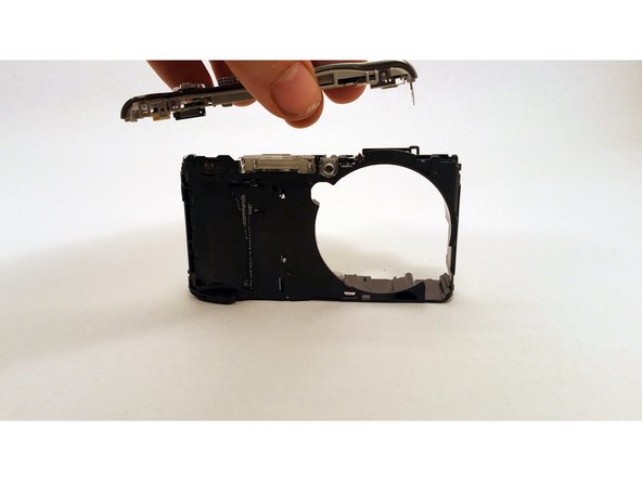

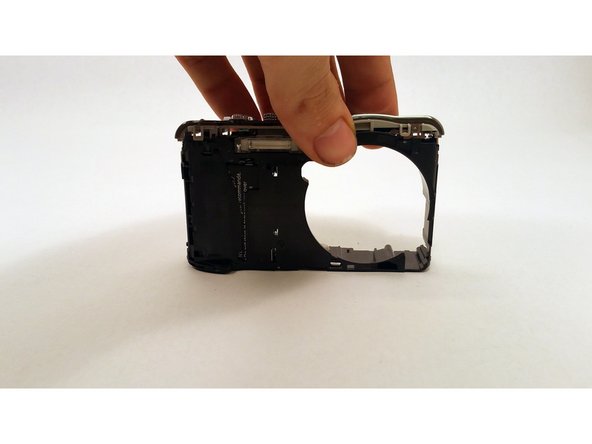

  10. Panasonic Lumx DMC-ZS19 Capture Button Replacement, Capture Button: crwdns2935265:010crwdnd2935265:01crwdnd2935265:03crwdne2935265:0 Panasonic Lumx DMC-ZS19 Capture Button Replacement, Capture Button: crwdns2935265:010crwdnd2935265:02crwdnd2935265:03crwdne2935265:0 Panasonic Lumx DMC-ZS19 Capture Button Replacement, Capture Button: crwdns2935265:010crwdnd2935265:03crwdnd2935265:03crwdne2935265:0

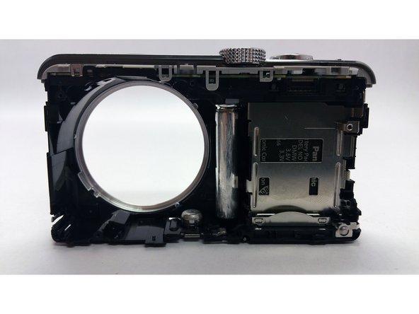

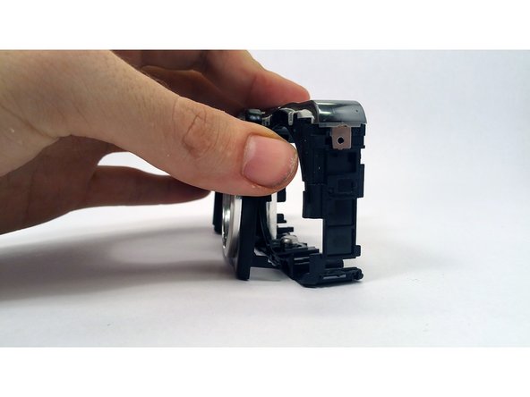

    • Once the motherboard has been removed, flip the camera over and remove the front panel.
  11. Panasonic Lumx DMC-ZS19 Capture Button Replacement: crwdns2935265:011crwdnd2935265:01crwdnd2935265:03crwdne2935265:0 Panasonic Lumx DMC-ZS19 Capture Button Replacement: crwdns2935265:011crwdnd2935265:02crwdnd2935265:03crwdne2935265:0 Panasonic Lumx DMC-ZS19 Capture Button Replacement: crwdns2935265:011crwdnd2935265:03crwdnd2935265:03crwdne2935265:0
    • After the front panel is removed, the buttons are connected by a simple string of clips. To remove the buttons, find the clip on the back and the two on the front that are connecting the buttons to the shell of the camera. Remove these clips and pull the buttons up from the back at an angle towards the front to remove them.
