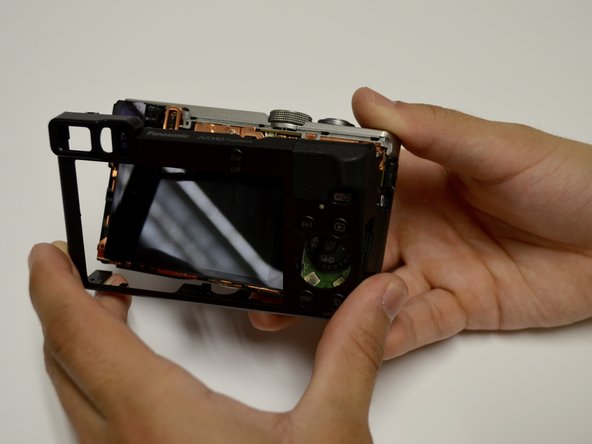

  5. Panasonic Lumix ZS50 Lens Assembly Replacement, LCD Screen: crwdns2935265:05crwdnd2935265:01crwdnd2935265:03crwdne2935265:0 Panasonic Lumix ZS50 Lens Assembly Replacement, LCD Screen: crwdns2935265:05crwdnd2935265:02crwdnd2935265:03crwdne2935265:0 Panasonic Lumix ZS50 Lens Assembly Replacement, LCD Screen: crwdns2935265:05crwdnd2935265:03crwdnd2935265:03crwdne2935265:0
    • Orient the camera so the bottom is facing up and the battery door is on the right side.
    • Remove four black screws from the bottom of the camera.
    • Remove two black screws from the right side of the camera.
    • Remove one black screw from the left side of the camera.
  6. Panasonic Lumix ZS50 Lens Assembly Replacement: crwdns2935265:06crwdnd2935265:01crwdnd2935265:02crwdne2935265:0 Panasonic Lumix ZS50 Lens Assembly Replacement: crwdns2935265:06crwdnd2935265:02crwdnd2935265:02crwdne2935265:0
    • Remove the casing from the camera by hand or using a plastic opening tool.
