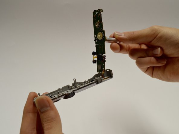

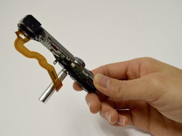

  13. Panasonic Lumix ZS50 Flash Assembly Replacement, Flash Assembly: crwdns2935265:013crwdnd2935265:01crwdnd2935265:03crwdne2935265:0 Panasonic Lumix ZS50 Flash Assembly Replacement, Flash Assembly: crwdns2935265:013crwdnd2935265:02crwdnd2935265:03crwdne2935265:0 Panasonic Lumix ZS50 Flash Assembly Replacement, Flash Assembly: crwdns2935265:013crwdnd2935265:03crwdnd2935265:03crwdne2935265:0
    • Remove the one screw holding the camera and the flash component together.
    • Gently pull the flash component out of the camera body.
  14. Panasonic Lumix ZS50 Flash Assembly Replacement: crwdns2935265:014crwdnd2935265:01crwdnd2935265:03crwdne2935265:0 Panasonic Lumix ZS50 Flash Assembly Replacement: crwdns2935265:014crwdnd2935265:02crwdnd2935265:03crwdne2935265:0 Panasonic Lumix ZS50 Flash Assembly Replacement: crwdns2935265:014crwdnd2935265:03crwdnd2935265:03crwdne2935265:0
    • Separate the top camera casing from the flash component by unscrewing the three surrounding screws.
    • Remove the flash assembly, including the circuit board, by detaching it and the ribbon cables from the casing.
