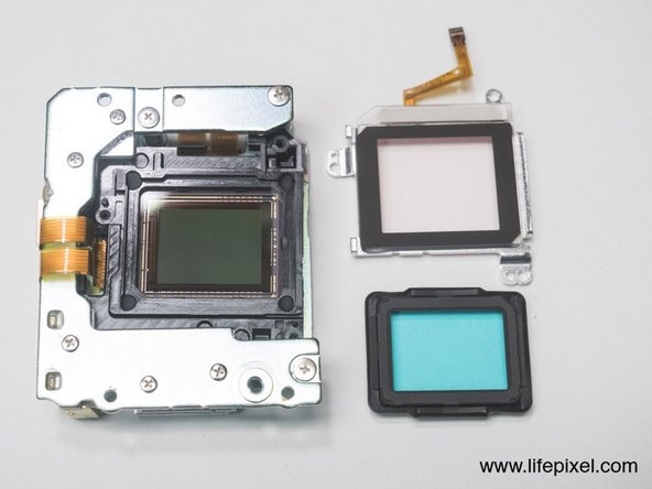

    • I have dust particles underneath the sensor glass, so sensor swabs didn't help me. I will try to get inside and under the glass. Additionally the EVF is overbright after a drop and maybe can be rearranged in the process.
    • You can spot dust marks yourself best if you set the camera to the "A" mode at f/22 and take a picture of the sky

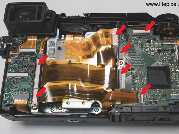

  6. Panasonic Lumix GX80/85 Teardown: crwdns2935265:06crwdnd2935265:01crwdnd2935265:02crwdne2935265:0 Panasonic Lumix GX80/85 Teardown: crwdns2935265:06crwdnd2935265:02crwdnd2935265:02crwdne2935265:0
    • remove the backplate and remove the ribbon cables

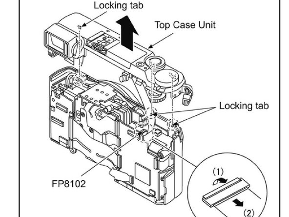

    • to remove the sensor more easily you can remove the top bar before

    • Remove the 3 screws to get the sensor cover glass off. Be Careful not to let them fall inside the housing. There are extremely strong magnets!

Hi, what exactly do you mean? I managed to wipe the sensor clean, but correct reassembly is difficult. I might have missaligned the magnets holding the sensor and now the camera sometimes seems to focus very slow.

How do you remove the top case unit or top bar?
Nigel - crwdns2934203:0crwdne2934203:0
