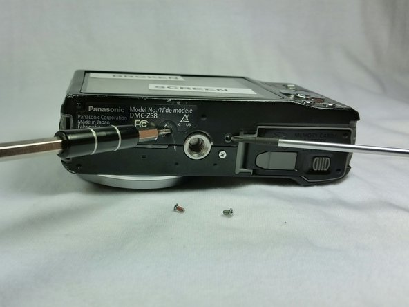

Panasonic Lumix DMC-ZS8 Screen Panel Replacement
  1. Panasonic Lumix DMC-ZS8 Screen Panel Replacement, Screen Panel: crwdns2935265:01crwdnd2935265:01crwdnd2935265:03crwdne2935265:0 Panasonic Lumix DMC-ZS8 Screen Panel Replacement, Screen Panel: crwdns2935265:01crwdnd2935265:02crwdnd2935265:03crwdne2935265:0 Panasonic Lumix DMC-ZS8 Screen Panel Replacement, Screen Panel: crwdns2935265:01crwdnd2935265:03crwdnd2935265:03crwdne2935265:0

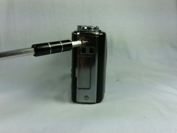

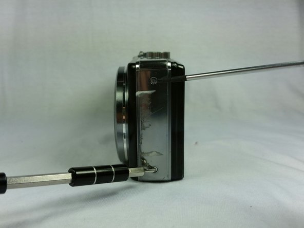

    • Remove all four screws from the side panels.

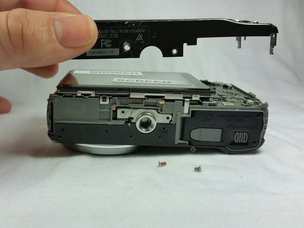

  2. Panasonic Lumix DMC-ZS8 Screen Panel Replacement: crwdns2935265:02crwdnd2935265:01crwdnd2935265:03crwdne2935265:0 Panasonic Lumix DMC-ZS8 Screen Panel Replacement: crwdns2935265:02crwdnd2935265:02crwdnd2935265:03crwdne2935265:0 Panasonic Lumix DMC-ZS8 Screen Panel Replacement: crwdns2935265:02crwdnd2935265:03crwdnd2935265:03crwdne2935265:0
    • Remove the two screws from the bottom of the back panel.

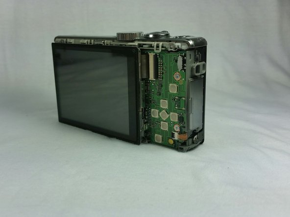

    • Remove the back panel as shown in the second and third pictures.

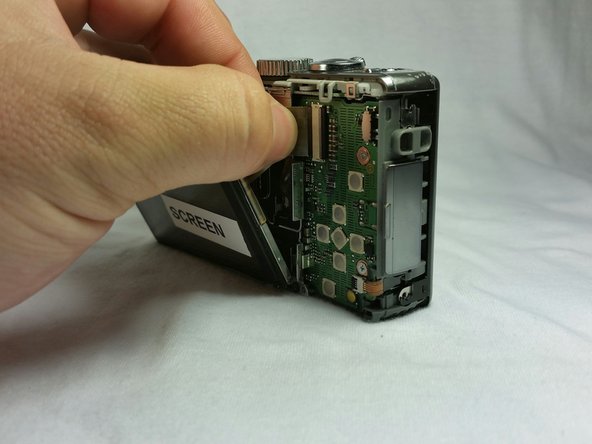

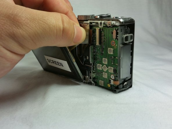

  3. Panasonic Lumix DMC-ZS8 Screen Panel Replacement: crwdns2935265:03crwdnd2935265:01crwdnd2935265:03crwdne2935265:0 Panasonic Lumix DMC-ZS8 Screen Panel Replacement: crwdns2935265:03crwdnd2935265:02crwdnd2935265:03crwdne2935265:0 Panasonic Lumix DMC-ZS8 Screen Panel Replacement: crwdns2935265:03crwdnd2935265:03crwdnd2935265:03crwdne2935265:0
    • Remove the screen from the mounting bracket.
    • Slide the wiring from the board connection.

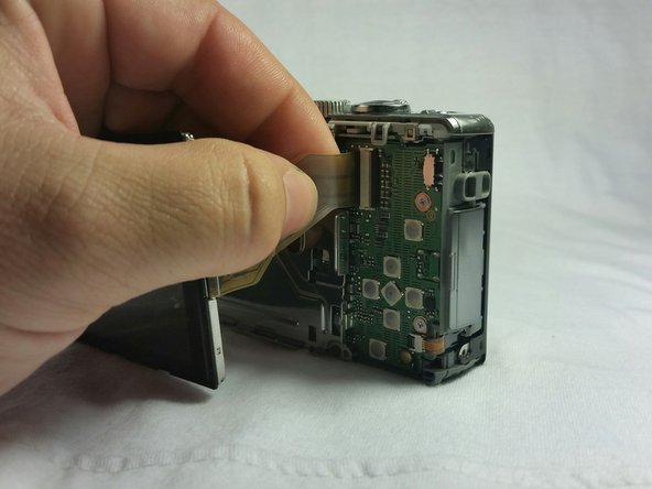

  4. Panasonic Lumix DMC-ZS8 Screen Panel Replacement: crwdns2935265:04crwdnd2935265:01crwdnd2935265:03crwdne2935265:0 Panasonic Lumix DMC-ZS8 Screen Panel Replacement: crwdns2935265:04crwdnd2935265:02crwdnd2935265:03crwdne2935265:0 Panasonic Lumix DMC-ZS8 Screen Panel Replacement: crwdns2935265:04crwdnd2935265:03crwdnd2935265:03crwdne2935265:0
    • Reconnect the new screen wiring into the motherboard as shown in the picture. Replace the new screen into the mounting bracket.
