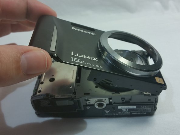

  3. Panasonic Lumix DMC-ZS8 Mounting Bracket Replacement: crwdns2935265:03crwdnd2935265:01crwdnd2935265:03crwdne2935265:0 Panasonic Lumix DMC-ZS8 Mounting Bracket Replacement: crwdns2935265:03crwdnd2935265:02crwdnd2935265:03crwdne2935265:0 Panasonic Lumix DMC-ZS8 Mounting Bracket Replacement: crwdns2935265:03crwdnd2935265:03crwdnd2935265:03crwdne2935265:0
    • Unscrew the Phillips head screw shown in the picture to remove the front panel.
    • Remove the front panel to expose the bracket at the bottom of the camera.

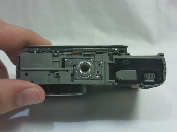

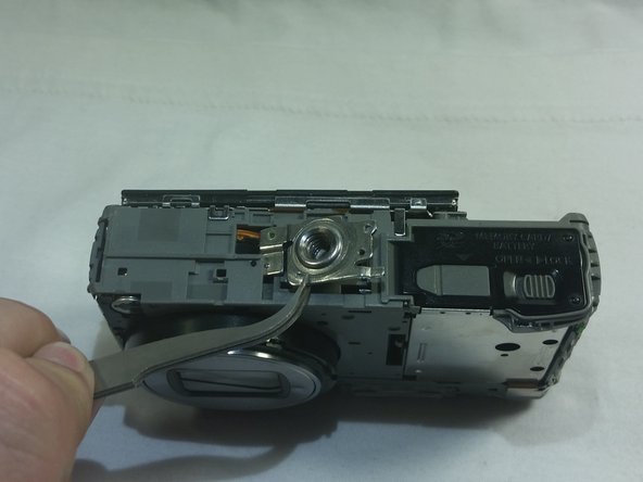

  4. Panasonic Lumix DMC-ZS8 Mounting Bracket Replacement: crwdns2935265:04crwdnd2935265:01crwdnd2935265:03crwdne2935265:0 Panasonic Lumix DMC-ZS8 Mounting Bracket Replacement: crwdns2935265:04crwdnd2935265:02crwdnd2935265:03crwdne2935265:0 Panasonic Lumix DMC-ZS8 Mounting Bracket Replacement: crwdns2935265:04crwdnd2935265:03crwdnd2935265:03crwdne2935265:0
    • Pry the right side of the bracket up to allow you to grab the bracket with tweezers.

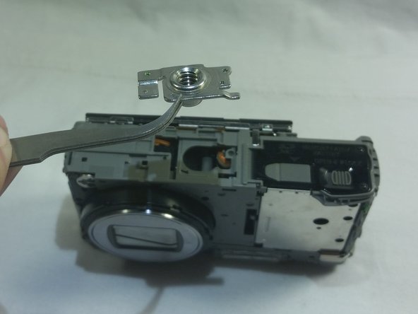

    • Grab the bracket with tweezers and slide it toward the battery door to remove it from the frame of the camera.
