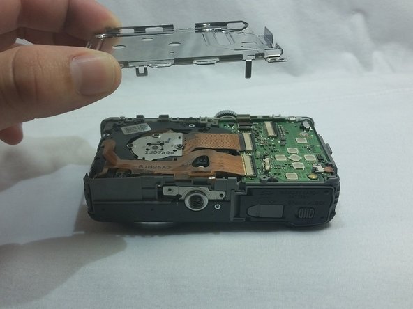

    • Lay the camera on the front side where the aluminum panel is facing up.
    • Once the camera is in the right position, lift up the aluminum plating.

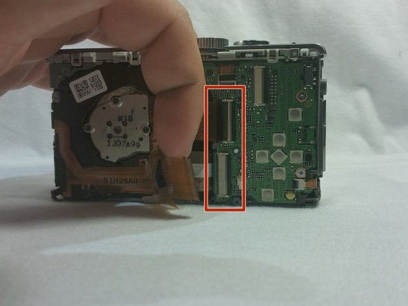

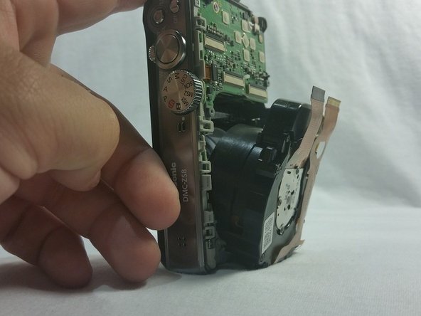

    • Stand the camera up in the upright position.
    • Unplug both copper wiring plugs from the motherboard.

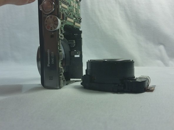

    • Lift your camera into the upright position
    • The camera lens should slide out. (Pry it out with a spudger or a plastic opening tool if needed)
