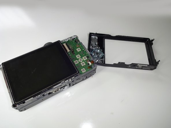

  3. Panasonic Lumix DMC-ZS8 LCD Display Screen Replacement, Removing the Rear Cover: crwdns2935265:03crwdnd2935265:01crwdnd2935265:02crwdne2935265:0 Panasonic Lumix DMC-ZS8 LCD Display Screen Replacement, Removing the Rear Cover: crwdns2935265:03crwdnd2935265:02crwdnd2935265:02crwdne2935265:0
    • Pry off rear cover. Make sure LCD remains in place.
    • There is a thin film of adhesive attaching the LCD to the rear cover. It releases easily with a little pressure. If necessary hold the LCD in place while removing the rear cover.

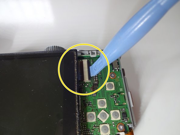

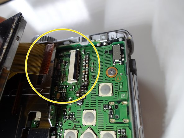

  4. Panasonic Lumix DMC-ZS8 LCD Display Screen Replacement, Removing the LCD: crwdns2935265:04crwdnd2935265:01crwdnd2935265:03crwdne2935265:0 Panasonic Lumix DMC-ZS8 LCD Display Screen Replacement, Removing the LCD: crwdns2935265:04crwdnd2935265:02crwdnd2935265:03crwdne2935265:0 Panasonic Lumix DMC-ZS8 LCD Display Screen Replacement, Removing the LCD: crwdns2935265:04crwdnd2935265:03crwdnd2935265:03crwdne2935265:0
    • Release the Ziff clamp holding the LCD cable. 1st photo shows clamp in closed position.
    • You can use a spudger to release the clamp. You can also use your finger nail, but be careful it is very fragile.
    • Remove the LCD Flex from the clamp

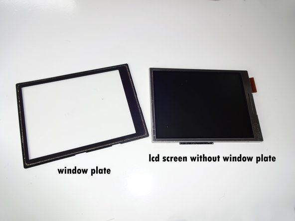

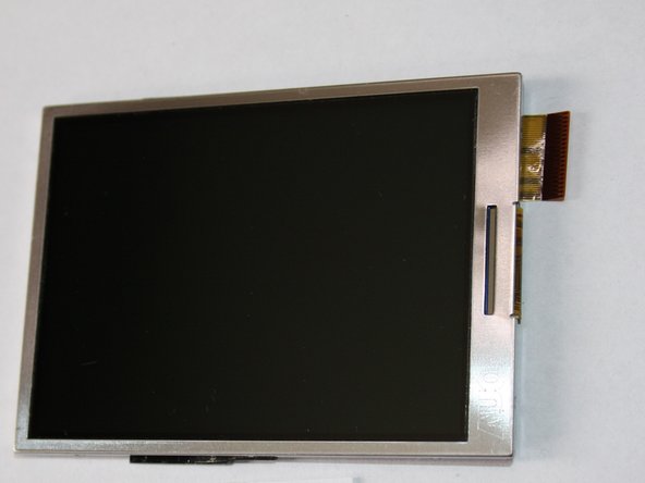

  5. Panasonic Lumix DMC-ZS8 LCD Display Screen Replacement: crwdns2935265:05crwdnd2935265:01crwdnd2935265:03crwdne2935265:0 Panasonic Lumix DMC-ZS8 LCD Display Screen Replacement: crwdns2935265:05crwdnd2935265:02crwdnd2935265:03crwdne2935265:0 Panasonic Lumix DMC-ZS8 LCD Display Screen Replacement: crwdns2935265:05crwdnd2935265:03crwdnd2935265:03crwdne2935265:0
    • You may need to pry off the window plate of your old screen if the new screen doesn't have one.
    • If required: Remove the window plate from your old screen if your new LCD doesn't have one. Save this part for re-install.

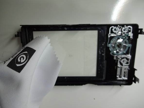

  6. Panasonic Lumix DMC-ZS8 LCD Display Screen Replacement, Clean up Window Plate and Reassemble: crwdns2935265:06crwdnd2935265:01crwdnd2935265:02crwdne2935265:0 Panasonic Lumix DMC-ZS8 LCD Display Screen Replacement, Clean up Window Plate and Reassemble: crwdns2935265:06crwdnd2935265:02crwdnd2935265:02crwdne2935265:0
    Microfiber Cleaning Cloths
    $3.99
    • If your new LCD does not come with a window plate: Tape your old window plate in place as shown in the photo. Make sure it lines up properly and fits into the grooves. This makes re-assembly much easier.
    • If necessary clean the window plate and LCD with a micro fiber dry cloth. Make sure there is no debris or dust before you re-install. DO NOT use any liquids.
    • Now just reverse the steps to re-assemble your camera with the new screen.
