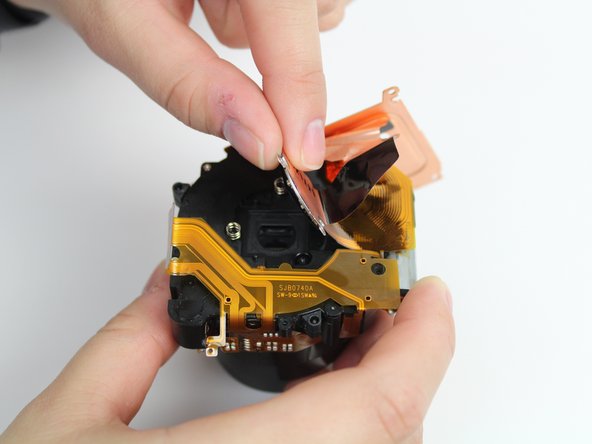

  12. Panasonic Lumix DMC-ZS60 Camera Sensor Replacement, Camera Lens: crwdns2935265:012crwdnd2935265:01crwdnd2935265:02crwdne2935265:0 Panasonic Lumix DMC-ZS60 Camera Sensor Replacement, Camera Lens: crwdns2935265:012crwdnd2935265:02crwdnd2935265:02crwdne2935265:0
    • Unscrew the three 3mm screws attached to the plate cover using a Phillips #000 Screwdriver.
    • Pull off the plate cover to uncover the camera lens.
  13. Panasonic Lumix DMC-ZS60 Camera Sensor Replacement: crwdns2935265:013crwdnd2935265:01crwdnd2935265:02crwdne2935265:0 Panasonic Lumix DMC-ZS60 Camera Sensor Replacement: crwdns2935265:013crwdnd2935265:02crwdnd2935265:02crwdne2935265:0
    • Lift the camera lens from the camera.

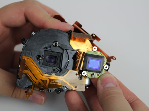

  14. Panasonic Lumix DMC-ZS60 Camera Sensor Replacement, Camera Sensor: crwdns2935265:014crwdnd2935265:01crwdnd2935265:03crwdne2935265:0 Panasonic Lumix DMC-ZS60 Camera Sensor Replacement, Camera Sensor: crwdns2935265:014crwdnd2935265:02crwdnd2935265:03crwdne2935265:0 Panasonic Lumix DMC-ZS60 Camera Sensor Replacement, Camera Sensor: crwdns2935265:014crwdnd2935265:03crwdnd2935265:03crwdne2935265:0
    • Unscrew three screws using the T2 Torx Screwdriver.
    • Remove the camera sensor.
