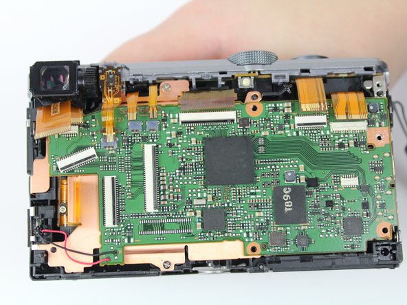

  9. Panasonic Lumix DMC-ZS60 Camera Lens Replacement, Motherboard: crwdns2935265:09crwdnd2935265:01crwdnd2935265:01crwdne2935265:0
    • Remove these three 3 mm screws with a Phillips #000 screwdriver.

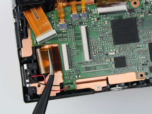

  10. Panasonic Lumix DMC-ZS60 Camera Lens Replacement: crwdns2935265:010crwdnd2935265:01crwdnd2935265:03crwdne2935265:0 Panasonic Lumix DMC-ZS60 Camera Lens Replacement: crwdns2935265:010crwdnd2935265:02crwdnd2935265:03crwdne2935265:0 Panasonic Lumix DMC-ZS60 Camera Lens Replacement: crwdns2935265:010crwdnd2935265:03crwdnd2935265:03crwdne2935265:0
    • Disconnect these 9 ribbon cables from the motherboard. One ribbon cable is hidden underneath the larger one on the left.
    • Use tweezers to first lift up the retaining flaps for each connector, then pull out the ribbon cable.

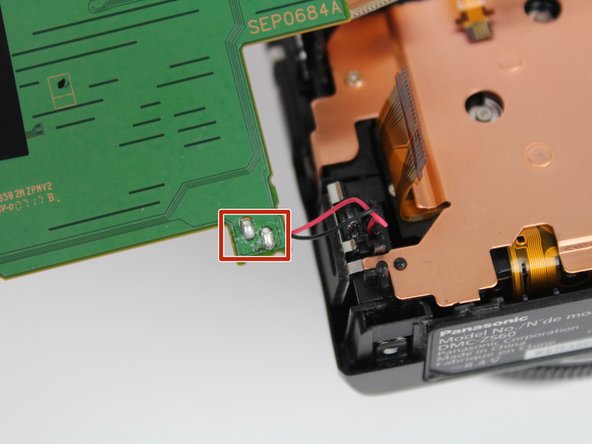

    • Now you will able to lift the motherboard up and it will only be connected by two cables.
    • To fully remove the motherboard, you will have to solder the metal in order to remove the wires.
    • For more information on soldering, please visit the How to Solder and Desolder Connections guide.

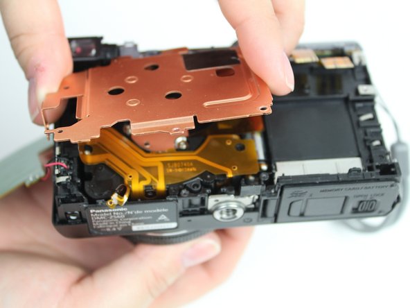

  12. Panasonic Lumix DMC-ZS60 Camera Lens Replacement, Camera Lens: crwdns2935265:012crwdnd2935265:01crwdnd2935265:02crwdne2935265:0 Panasonic Lumix DMC-ZS60 Camera Lens Replacement, Camera Lens: crwdns2935265:012crwdnd2935265:02crwdnd2935265:02crwdne2935265:0
    • Unscrew the three 3mm screws attached to the plate cover using a Phillips #000 Screwdriver.
    • Pull off the plate cover to uncover the camera lens.

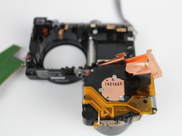

  13. Panasonic Lumix DMC-ZS60 Camera Lens Replacement: crwdns2935265:013crwdnd2935265:01crwdnd2935265:02crwdne2935265:0 Panasonic Lumix DMC-ZS60 Camera Lens Replacement: crwdns2935265:013crwdnd2935265:02crwdnd2935265:02crwdne2935265:0
    • Lift the camera lens from the camera.
