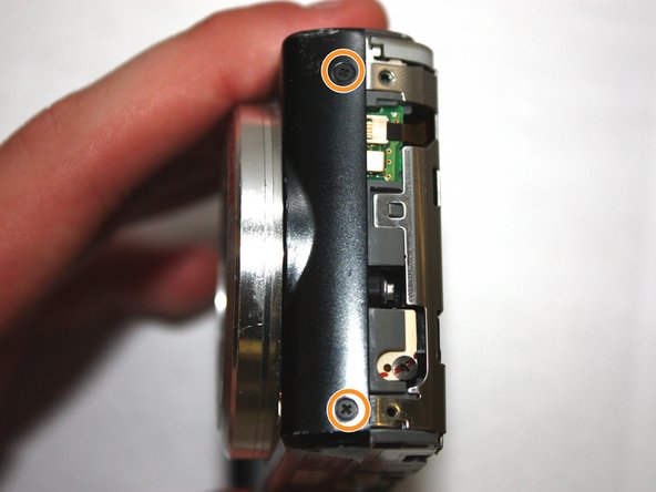

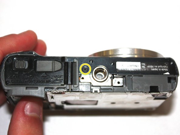

    • Remove the two bottom 1.0 mm screws with a Phillips #000 screwdriver.
    • Remove the two 1.0 mm screws on the left with a Phillips #000 screwdriver.
    • Remove the two 1.0 mm screws on the right with a Phillips #000 screwdriver.

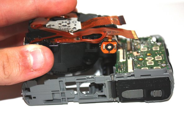

    • Carefully separate the back of the camera from the main body.
    • Do not apply excessive force. The LCD is connected by ribbon cables that can be easily damaged.

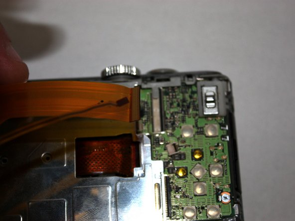

  4. Panasonic Lumix DMC-ZS6 Top Assembly Replacement: crwdns2935265:04crwdnd2935265:01crwdnd2935265:02crwdne2935265:0 Panasonic Lumix DMC-ZS6 Top Assembly Replacement: crwdns2935265:04crwdnd2935265:02crwdnd2935265:02crwdne2935265:0
    • Use the tip of a spudger to flip up the black tabs on the ribbon cables.
    • Pull the ribbon cables gently to unseat them.

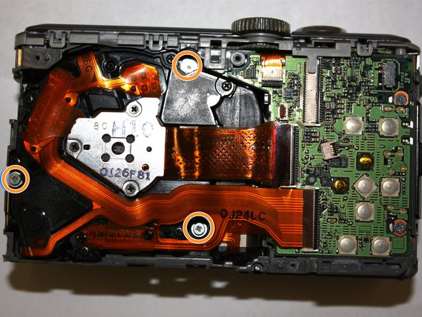

  5. Panasonic Lumix DMC-ZS6 Top Assembly Replacement: crwdns2935265:05crwdnd2935265:01crwdnd2935265:03crwdne2935265:0 Panasonic Lumix DMC-ZS6 Top Assembly Replacement: crwdns2935265:05crwdnd2935265:02crwdnd2935265:03crwdne2935265:0 Panasonic Lumix DMC-ZS6 Top Assembly Replacement: crwdns2935265:05crwdnd2935265:03crwdnd2935265:03crwdne2935265:0
    • Remove one 1.0 mm screw from the bottom with a Phillips #000 screwdriver.

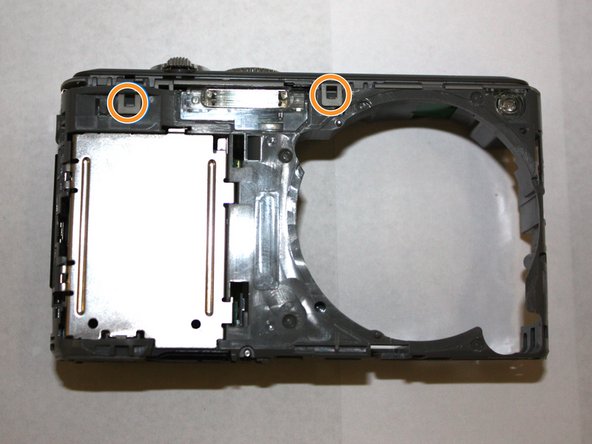

  6. Panasonic Lumix DMC-ZS6 Top Assembly Replacement: crwdns2935265:06crwdnd2935265:01crwdnd2935265:01crwdne2935265:0
    • Carefully separate the front of the camera from the main body.

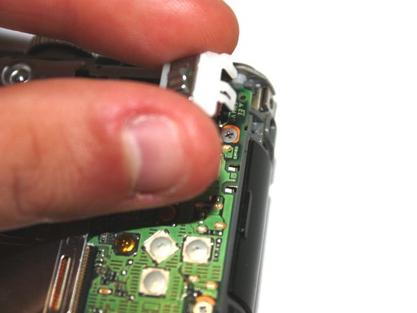

  7. Panasonic Lumix DMC-ZS6 Top Assembly Replacement: crwdns2935265:07crwdnd2935265:01crwdnd2935265:02crwdne2935265:0 Panasonic Lumix DMC-ZS6 Top Assembly Replacement: crwdns2935265:07crwdnd2935265:02crwdnd2935265:02crwdne2935265:0
    • Use the tip of the spudger to disengage the plastic tab.
    • Carefully lift the selector switch away from the motherboard.

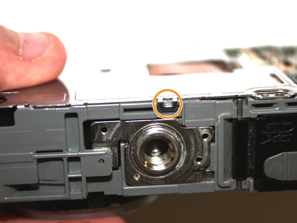

    • Insert the tip of the spudger into the center hole of the tripod mount. Apply force in the direction facing away from the button.
    • Carefully lift the tripod mount out of the camera body.

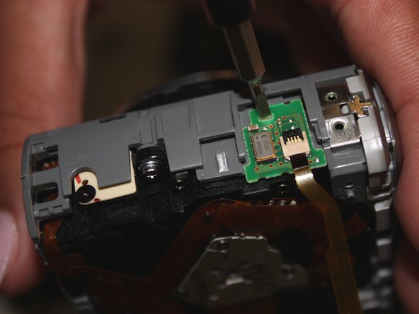

    • Use the spudger to flip up the brown tab on the motherboard. Carefully unseat the ribbon cable.
    • Insert the tip of the spudger into the hole on the daughterboard. Apply upward force to remove the daughterboard from the main case.

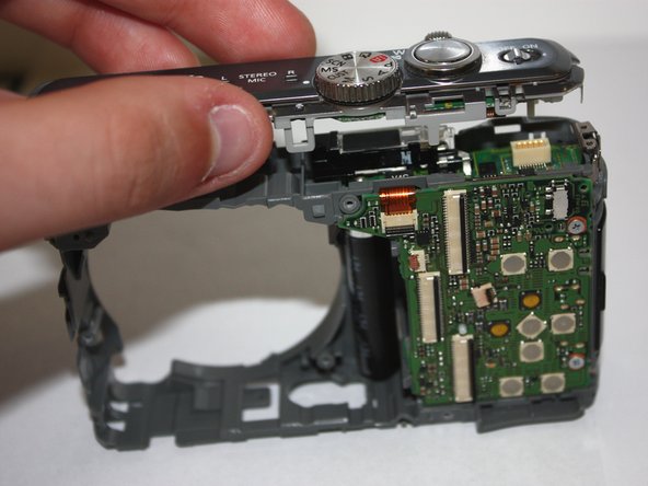

  12. Panasonic Lumix DMC-ZS6 Top Assembly Replacement: crwdns2935265:012crwdnd2935265:01crwdnd2935265:03crwdne2935265:0 Panasonic Lumix DMC-ZS6 Top Assembly Replacement: crwdns2935265:012crwdnd2935265:02crwdnd2935265:03crwdne2935265:0 Panasonic Lumix DMC-ZS6 Top Assembly Replacement: crwdns2935265:012crwdnd2935265:03crwdnd2935265:03crwdne2935265:0
    • Use the tip of the spudger to disengage the tab on the back of the camera.
    • Use the tip of the spudger to disengage the two tabs on the front of the camera.
    • Carefully lift the top assembly out of place.
