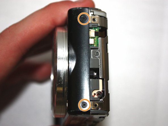

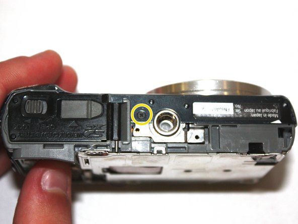

    • Unscrew the bottom two 1.0 mm screws with a Phillips #000 screwdriver.
    • Unscrew the two 1.0 mm screws on the right with a Phillips #000 screwdriver.
    • Unscrew the two 1.0 mm screws on the left with a Phillips #000 screwdriver.

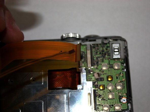

    • Carefully separate the back of the camera from the main body.
    • Do not apply excessive force. The LCD is connected by ribbon cables that can be easily damaged.
  4. Panasonic Lumix DMC-ZS6 SD Card Reader Replacement: crwdns2935265:04crwdnd2935265:01crwdnd2935265:02crwdne2935265:0 Panasonic Lumix DMC-ZS6 SD Card Reader Replacement: crwdns2935265:04crwdnd2935265:02crwdnd2935265:02crwdne2935265:0
    • Use the tip of the spudger to flip up the black tabs on the ribbon cables.
    • Pull gently on the ribbon cables to unseat them.

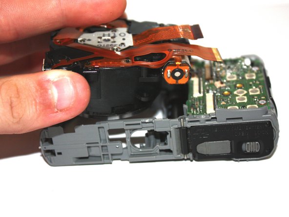

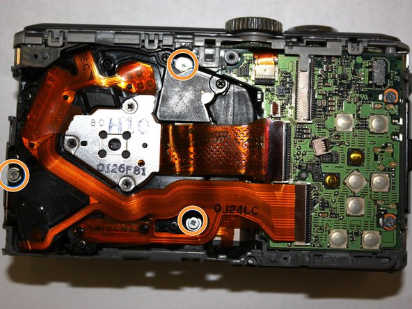

    • Use the spudger to flip up the two tabs on the motherboard and carefully unseat the ribbon cables.
    • Use the Phillips #000 screwdriver to remove the three 1.0 mm silver screws.
    • Carefully lift the lens assembly out of the camera.

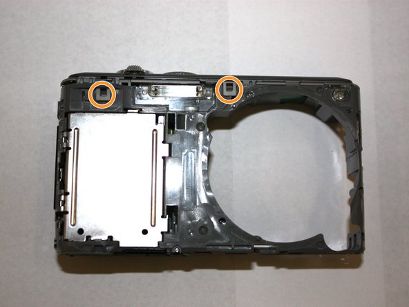

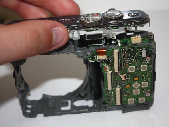

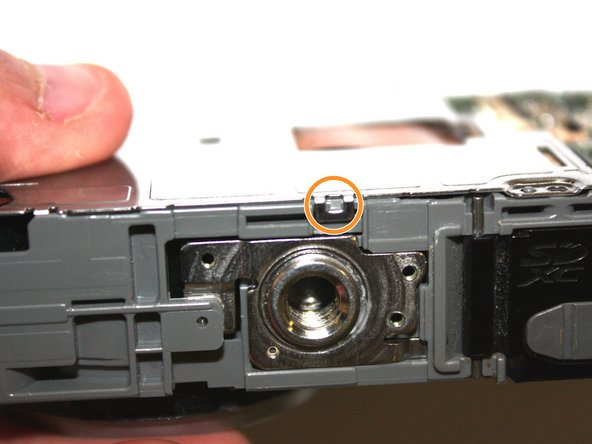

    • Use the tip of the spudger to disengage the tab on the back of the camera.
    • Use the tip of the spudger to disengage the two tabs on the front of the camera.
    • Carefully lift the top assembly out of place.

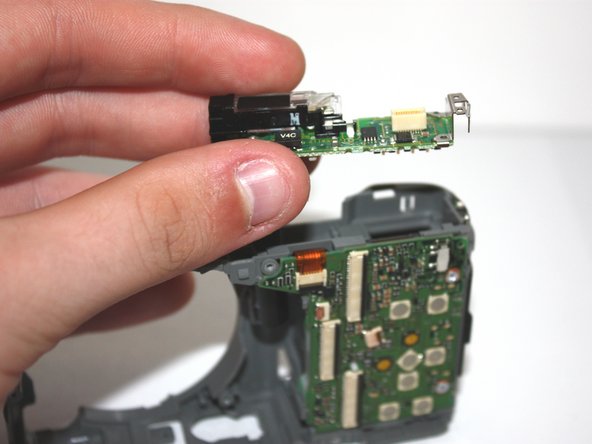

  13. Panasonic Lumix DMC-ZS6 SD Card Reader Replacement: crwdns2935265:013crwdnd2935265:01crwdnd2935265:02crwdne2935265:0 Panasonic Lumix DMC-ZS6 SD Card Reader Replacement: crwdns2935265:013crwdnd2935265:02crwdnd2935265:02crwdne2935265:0
    • Use the spudger to disengage the two tabs.
    • Carefully lift the flash assembly out of place.

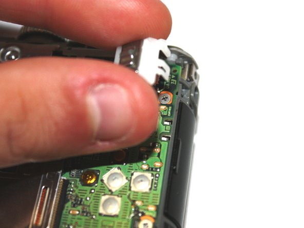

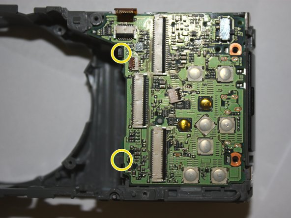

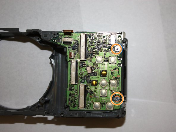

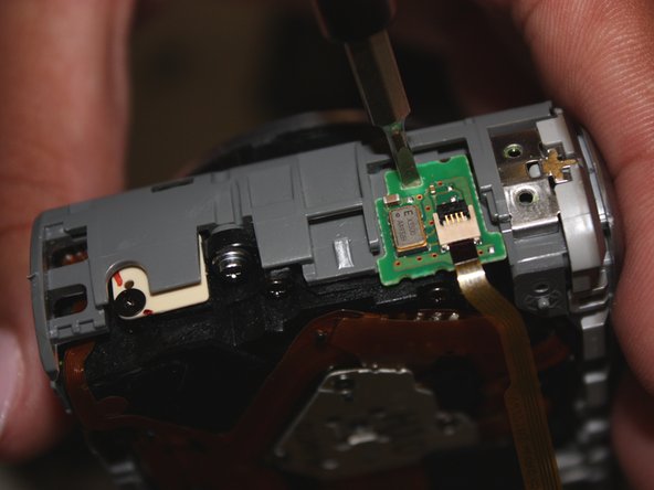

    • Use the tip of the spudger to flip up the tab to unseat the ribbon cable.
    • Unscrew the two silver 1.0 mm screws with a Phillips #000.
    • Use the tip of the spudger to disengage the two plastic tabs, and carefully lift the motherboard out of place.

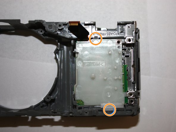

  15. Panasonic Lumix DMC-ZS6 SD Card Reader Replacement: crwdns2935265:015crwdnd2935265:01crwdnd2935265:02crwdne2935265:0 Panasonic Lumix DMC-ZS6 SD Card Reader Replacement: crwdns2935265:015crwdnd2935265:02crwdnd2935265:02crwdne2935265:0
    • Unscrew the one silver 1.0 mm screw with a Phillips #000 screwdriver.
    • Use to tip of the spudger to disengage the plastic tab, then carefully lift the plastic shield out of place.
