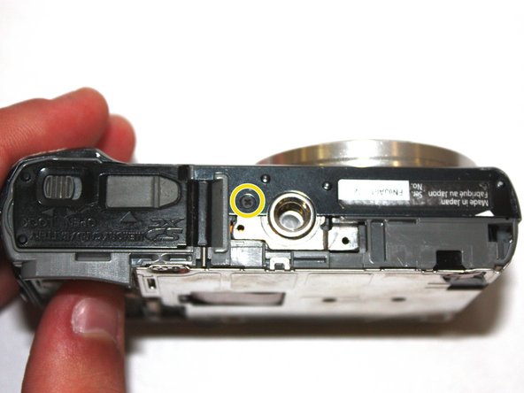

    • Unscrew the two bottom 1.0 mm screws with a Phillips #000 screwdriver.
    • Unscrew the two 1.0 mm screws to the left with a Phillips #000 screwdriver.
    • Unscrew the two 1.0 mm screws to the right with a Phillips #000 screwdriver.

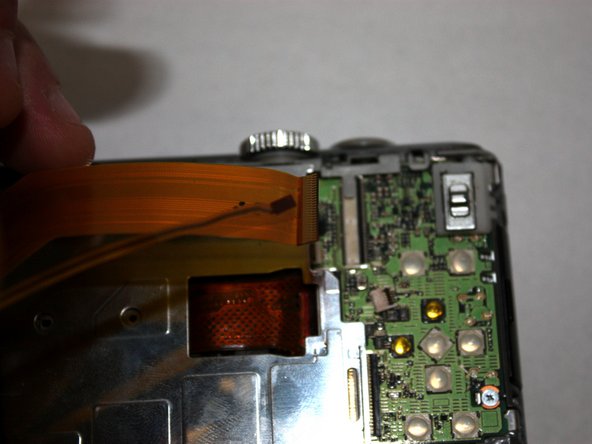

  4. Panasonic Lumix DMC-ZS6 Lens Assembly Replacement: crwdns2935265:04crwdnd2935265:01crwdnd2935265:02crwdne2935265:0 Panasonic Lumix DMC-ZS6 Lens Assembly Replacement: crwdns2935265:04crwdnd2935265:02crwdnd2935265:02crwdne2935265:0
    • Use the tip of the 2.0 mm flathead screwdriver to flip up the black tabs on the ribbon cables.
    • Pull gently on the ribbon cables to unseat them.
  5. Panasonic Lumix DMC-ZS6 Lens Assembly Replacement: crwdns2935265:05crwdnd2935265:01crwdnd2935265:03crwdne2935265:0 Panasonic Lumix DMC-ZS6 Lens Assembly Replacement: crwdns2935265:05crwdnd2935265:02crwdnd2935265:03crwdne2935265:0 Panasonic Lumix DMC-ZS6 Lens Assembly Replacement: crwdns2935265:05crwdnd2935265:03crwdnd2935265:03crwdne2935265:0

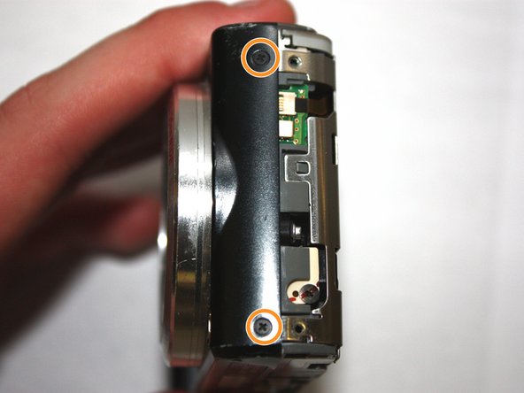

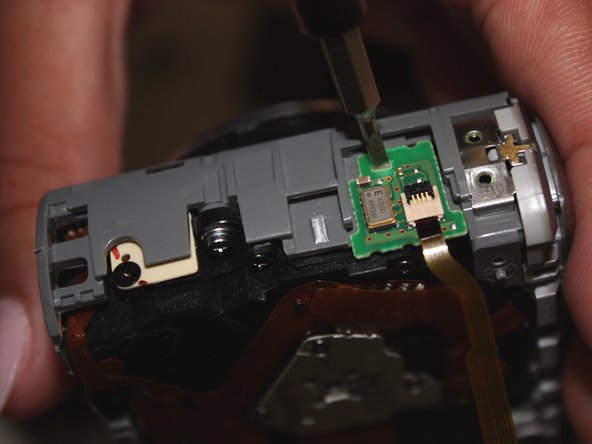

    • Use the tip of the 1.5 mm flathead screwdriver to disengage the plastic tab.
    • Carefully lift the selector switch away from the motherboard.

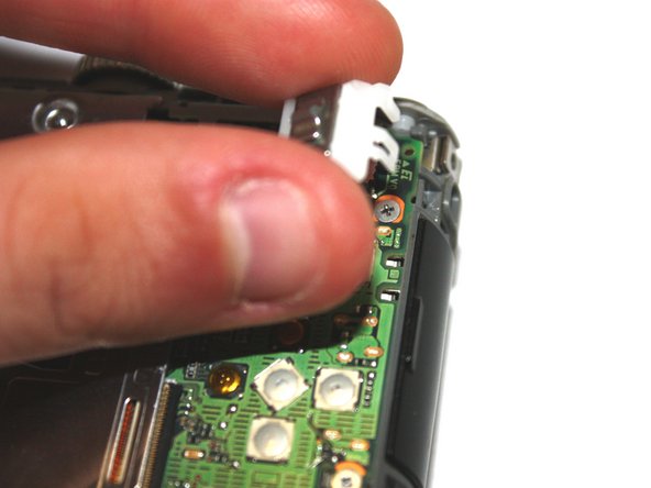

  9. Panasonic Lumix DMC-ZS6 Lens Assembly Replacement: crwdns2935265:09crwdnd2935265:01crwdnd2935265:01crwdne2935265:0

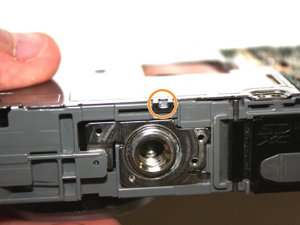

    • Insert the tip of the 2.0 mm flathead into the center hole of the tripod mount, and apply force in the direction facing away from the button.
    • Carefully lift the tripod mount out of the camera body.

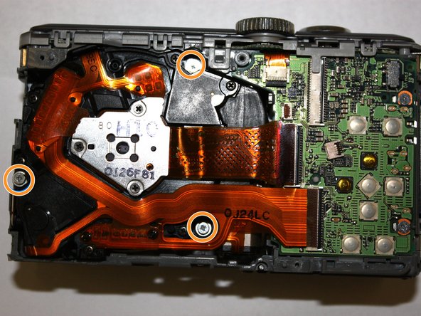

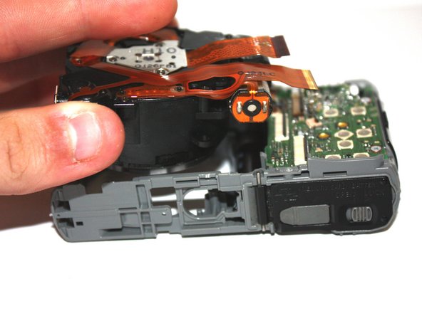

  11. Panasonic Lumix DMC-ZS6 Lens Assembly Replacement: crwdns2935265:011crwdnd2935265:01crwdnd2935265:03crwdne2935265:0 Panasonic Lumix DMC-ZS6 Lens Assembly Replacement: crwdns2935265:011crwdnd2935265:02crwdnd2935265:03crwdne2935265:0 Panasonic Lumix DMC-ZS6 Lens Assembly Replacement: crwdns2935265:011crwdnd2935265:03crwdnd2935265:03crwdne2935265:0
    • Use the 2.0 mm flathead to flip up the two tabs on the motherboard and carefully unseat the ribbon cables.
    • Unscrew the three silver 1.0 mm screws with a Phillips #000 screwdriver.
    • Carefully lift the lens assembly out of the camera.
