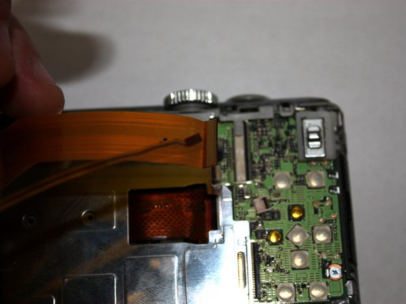

    • Separate the back of the camera from the main body carefully.
    • Do not apply excessive force. The LCD is connected by ribbon cables that can be easily damaged.
  4. Panasonic Lumix DMC-ZS6 LCD Assembly Replacement: crwdns2935265:04crwdnd2935265:01crwdnd2935265:02crwdne2935265:0 Panasonic Lumix DMC-ZS6 LCD Assembly Replacement: crwdns2935265:04crwdnd2935265:02crwdnd2935265:02crwdne2935265:0
    • Use the tip of the spudger to flip up the black tabs on the ribbon cables.
    • Pull gently on the ribbon cables to unseat them.
  5. Panasonic Lumix DMC-ZS6 LCD Assembly Replacement: crwdns2935265:05crwdnd2935265:01crwdnd2935265:01crwdne2935265:0
    • Use the tip of the spudger to flip up the metal tabs.
    • Lift the LCD panel out of place carefully.
