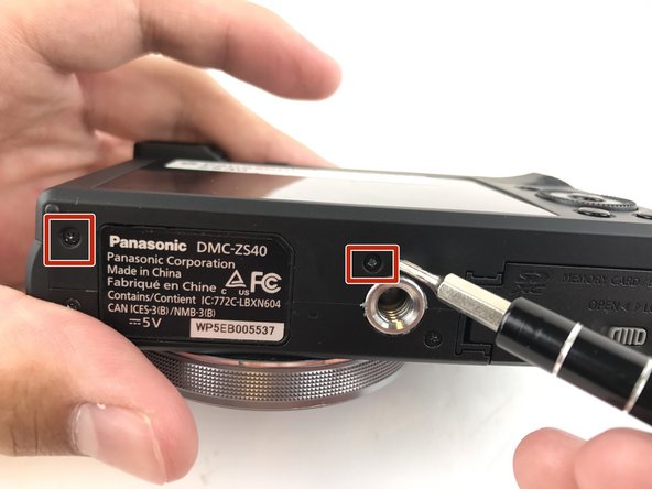

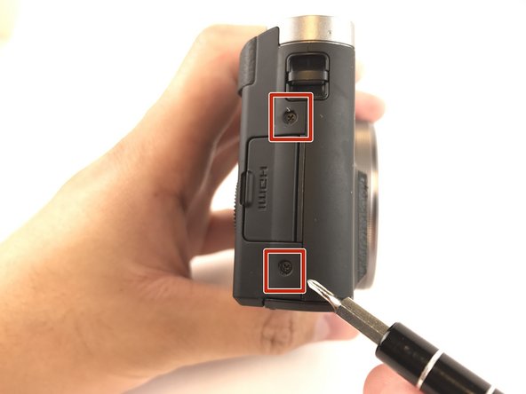

  4. Panasonic Lumix DMC-ZS40 Camera Sensor Replacement, Camera Sensor: crwdns2935265:04crwdnd2935265:01crwdnd2935265:03crwdne2935265:0 Panasonic Lumix DMC-ZS40 Camera Sensor Replacement, Camera Sensor: crwdns2935265:04crwdnd2935265:02crwdnd2935265:03crwdne2935265:0 Panasonic Lumix DMC-ZS40 Camera Sensor Replacement, Camera Sensor: crwdns2935265:04crwdnd2935265:03crwdnd2935265:03crwdne2935265:0
    • Unscrew these five 3mm screws located around the sides of the camera using a screw driver with a PH000 bit head.

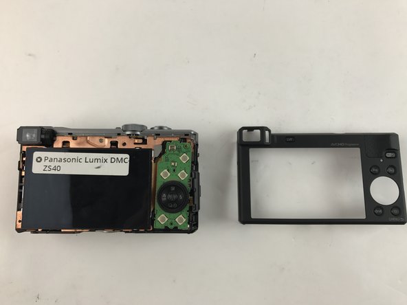

    • Pry off the back casing of the camera and place the camera face down.

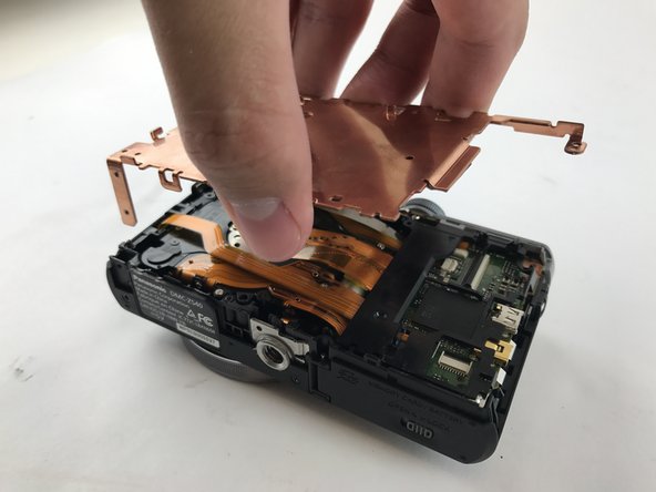

    • Place the LCD screen to the side while you remove the plate cover. The LCD has already been removed in this picture. It is not necessary to remove the LCD screen or the control dial for this guide.

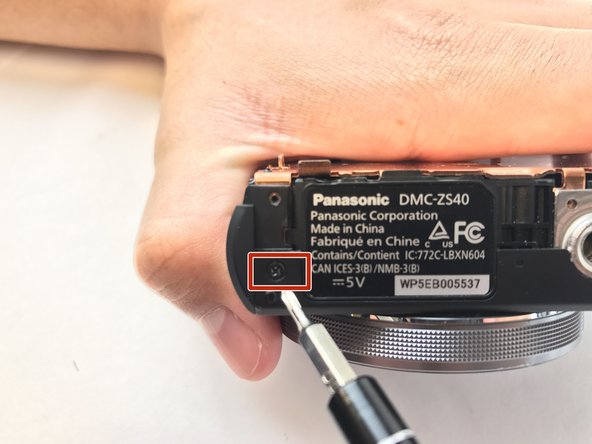

    • Remove these four 4mm screws and the 3mm screw on the top of the plate cover and on the side of the camera using a PH000 bit head. Once the screws are removed, the plate cover should lift right up.
    • Keep track of the different screw lengths and do not mix them up.

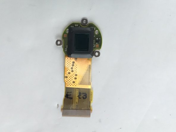

    • Using the T3 Phillips Screwdriver, unscrew the three Torx T3 2.5mm screws holding the sensor down.
  10. Panasonic Lumix DMC-ZS40 Camera Sensor Replacement: crwdns2935265:010crwdnd2935265:01crwdnd2935265:02crwdne2935265:0 Panasonic Lumix DMC-ZS40 Camera Sensor Replacement: crwdns2935265:010crwdnd2935265:02crwdnd2935265:02crwdne2935265:0
    • Gently lift the sensor off of the springs.
