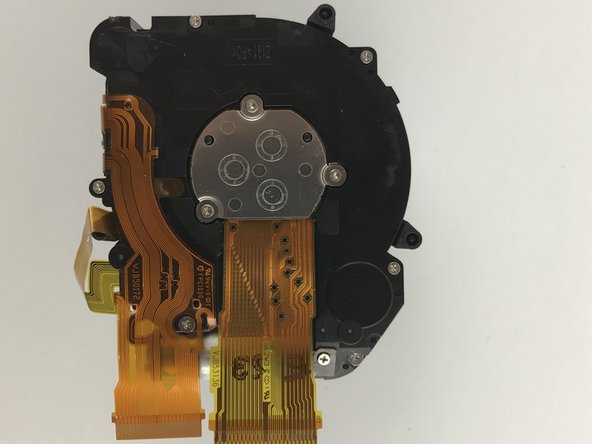

    • Pry the black cover shielding the ZIF connectors off with your hand.
  12. Panasonic Lumix DMC-ZS40 Camera Lens  Replacement: crwdns2935265:012crwdnd2935265:01crwdnd2935265:02crwdne2935265:0 Panasonic Lumix DMC-ZS40 Camera Lens  Replacement: crwdns2935265:012crwdnd2935265:02crwdnd2935265:02crwdne2935265:0
    • Disconnect these 6 ribbon cables from the motherboard. Use tweezers or a screw driver to lift up on the retaining flaps for each ZIF connector.
  13. Panasonic Lumix DMC-ZS40 Camera Lens  Replacement, Camera Lens: crwdns2935265:013crwdnd2935265:01crwdnd2935265:02crwdne2935265:0 Panasonic Lumix DMC-ZS40 Camera Lens  Replacement, Camera Lens: crwdns2935265:013crwdnd2935265:02crwdnd2935265:02crwdne2935265:0
    • Once the corresponding ribbon cables have been detached, the lens assembly can be lifted right up.

My Lumix is a bit older and so did not follow exactly. But this was helpful enough to allow me to work through the lens issue. In doing some reading, often the lens doesn't need replacing, just a good cleaning or even to reset it in the housing which worked for me. One thing I would say is refrain from taking the plastic clamps off. They are hard to get off and usually snap due to how brittle they get. Instead, leave in place and be careful with the cable.
