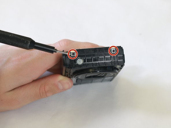

  1. Panasonic Lumix DMC-ZS35 Motherboard Replacement, Back Casing: crwdns2935265:01crwdnd2935265:01crwdnd2935265:03crwdne2935265:0 Panasonic Lumix DMC-ZS35 Motherboard Replacement, Back Casing: crwdns2935265:01crwdnd2935265:02crwdnd2935265:03crwdne2935265:0 Panasonic Lumix DMC-ZS35 Motherboard Replacement, Back Casing: crwdns2935265:01crwdnd2935265:03crwdnd2935265:03crwdne2935265:0
    • Remove the six 4mm screws located on the side and bottom of the camera casing using a Phillips #000 screwdriver.

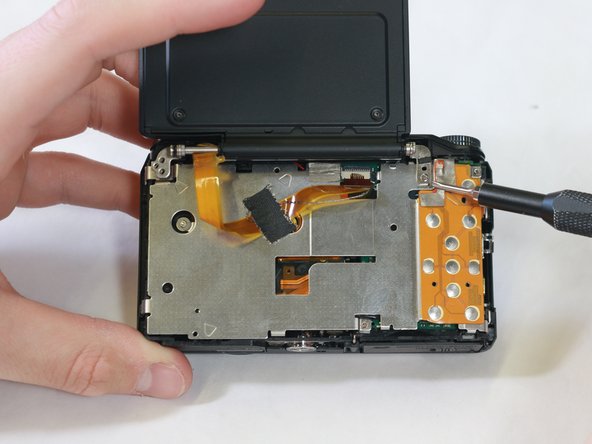

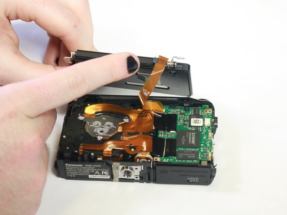

  4. Panasonic Lumix DMC-ZS35 Motherboard Replacement, Screen: crwdns2935265:04crwdnd2935265:01crwdnd2935265:02crwdne2935265:0 Panasonic Lumix DMC-ZS35 Motherboard Replacement, Screen: crwdns2935265:04crwdnd2935265:02crwdnd2935265:02crwdne2935265:0
    • Unscrew the four 3mm screws holding the LCD screen hinge in place using a Phillips #000 screwdriver.
  5. Panasonic Lumix DMC-ZS35 Motherboard Replacement: crwdns2935265:05crwdnd2935265:01crwdnd2935265:01crwdne2935265:0
    • Gently pull LCD screen ribbon cable from internal port to disconnect the screen and prevent unwanted damage.
    • Lift the freed LCD screen from the base camera to complete the process.

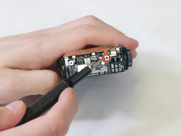

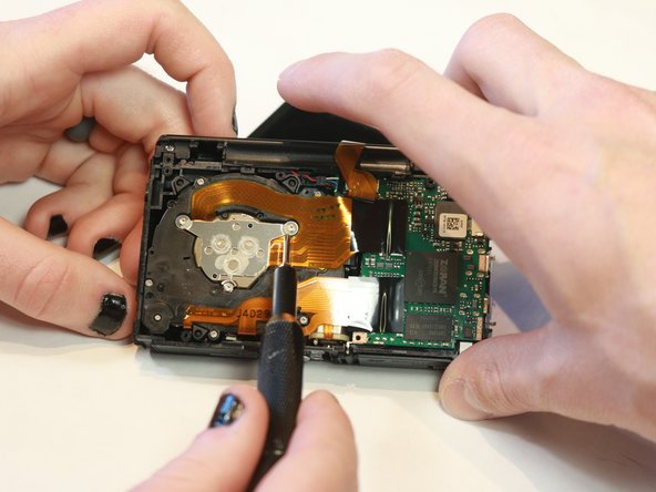

  6. Panasonic Lumix DMC-ZS35 Motherboard Replacement, Lens: crwdns2935265:06crwdnd2935265:01crwdnd2935265:03crwdne2935265:0 Panasonic Lumix DMC-ZS35 Motherboard Replacement, Lens: crwdns2935265:06crwdnd2935265:02crwdnd2935265:03crwdne2935265:0 Panasonic Lumix DMC-ZS35 Motherboard Replacement, Lens: crwdns2935265:06crwdnd2935265:03crwdnd2935265:03crwdne2935265:0
    • Remove the four 2mm Phillips #000 screws on the sides of the exposed internal metal plate within the camera.

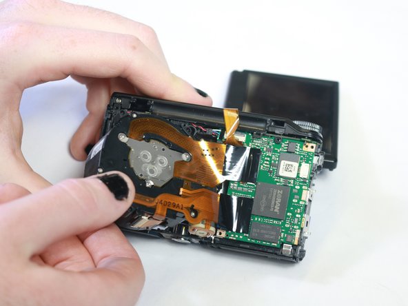

  7. Panasonic Lumix DMC-ZS35 Motherboard Replacement: crwdns2935265:07crwdnd2935265:01crwdnd2935265:03crwdne2935265:0 Panasonic Lumix DMC-ZS35 Motherboard Replacement: crwdns2935265:07crwdnd2935265:02crwdnd2935265:03crwdne2935265:0 Panasonic Lumix DMC-ZS35 Motherboard Replacement: crwdns2935265:07crwdnd2935265:03crwdnd2935265:03crwdne2935265:0
    • Using an iFixit opening tool, gently remove the plating.
    • Carefully remove the ribbon cable connecting the plating with the lens component.

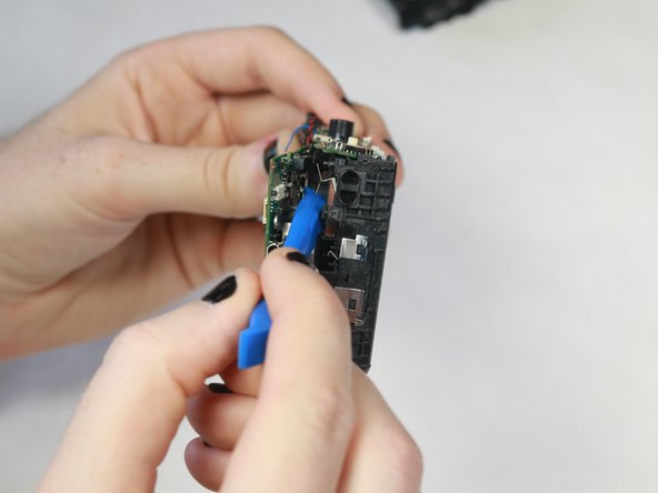

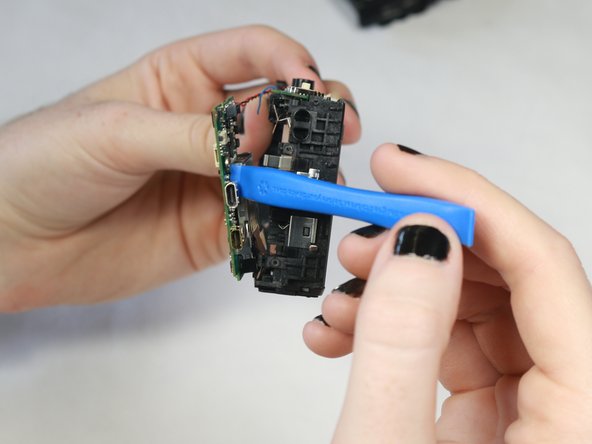

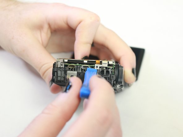

  10. Panasonic Lumix DMC-ZS35 Motherboard Replacement, Motherboard: crwdns2935265:010crwdnd2935265:01crwdnd2935265:03crwdne2935265:0 Panasonic Lumix DMC-ZS35 Motherboard Replacement, Motherboard: crwdns2935265:010crwdnd2935265:02crwdnd2935265:03crwdne2935265:0 Panasonic Lumix DMC-ZS35 Motherboard Replacement, Motherboard: crwdns2935265:010crwdnd2935265:03crwdnd2935265:03crwdne2935265:0
    • Using the opening tool, gently pry off the mother board. Run the opening tool along the outer edges of the motherboard as necessary to loosen it until it is fully removed.
    • Be sure to disconnect all cables before separating the motherboard from the camera, either by disconnecting the ZIF connectors or soldering if necessary.
