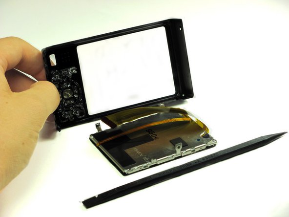

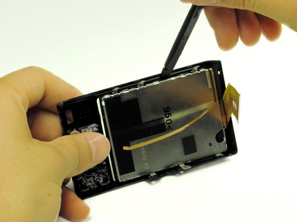

  5. Panasonic Lumix DMC-ZS3 LCD Screen Replacement, LCD Screen: crwdns2935265:05crwdnd2935265:01crwdnd2935265:03crwdne2935265:0 Panasonic Lumix DMC-ZS3 LCD Screen Replacement, LCD Screen: crwdns2935265:05crwdnd2935265:02crwdnd2935265:03crwdne2935265:0 Panasonic Lumix DMC-ZS3 LCD Screen Replacement, LCD Screen: crwdns2935265:05crwdnd2935265:03crwdnd2935265:03crwdne2935265:0
    • Take the back panel and use the flat end of the spudger to pry the LCD screen from the back cover.
    • It may be necessary to wiggle the spudger a little it to loosen the adhesive that holds the LCD screen to the back cover.
    • Be sure not to use excessive force in order to avoid damaging the components.

Really useful guide. However, it's not quite complete: you do have to take the screen assembly apart once you've removed it from the back cover. It's not that difficult to do with the spudger, as all the metal bits around the screen just prise apart, but the 10-15 minutes quoted turned into an hour or so for me once I'd got it all back together again.
