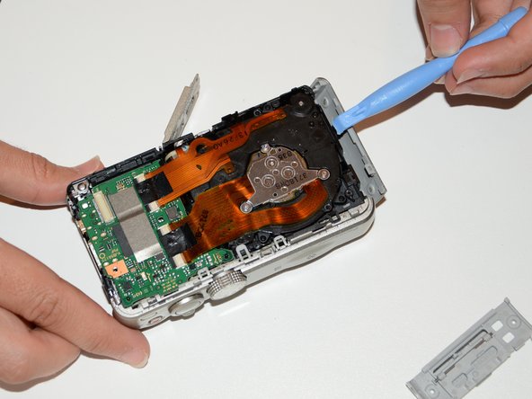

  2. Panasonic Lumix DMC-ZS25 Speaker Replacement: crwdns2935265:02crwdnd2935265:01crwdnd2935265:01crwdne2935265:0
    • Use the plastic opening tool to lift off the rear cover of your device. Go gently to avoid breaking anything.
    • The easiest place to open your device is from the HDMI port.
    • Gently does it.

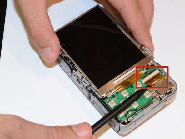

  3. Panasonic Lumix DMC-ZS25 Speaker Replacement: crwdns2935265:03crwdnd2935265:01crwdnd2935265:03crwdne2935265:0 Panasonic Lumix DMC-ZS25 Speaker Replacement: crwdns2935265:03crwdnd2935265:02crwdnd2935265:03crwdne2935265:0 Panasonic Lumix DMC-ZS25 Speaker Replacement: crwdns2935265:03crwdnd2935265:03crwdnd2935265:03crwdne2935265:0
    • Use a spudger to lift the LCD ribbon cable locking bar by angling it up, then withdraw the ribbon.
    • Take care not to break it.

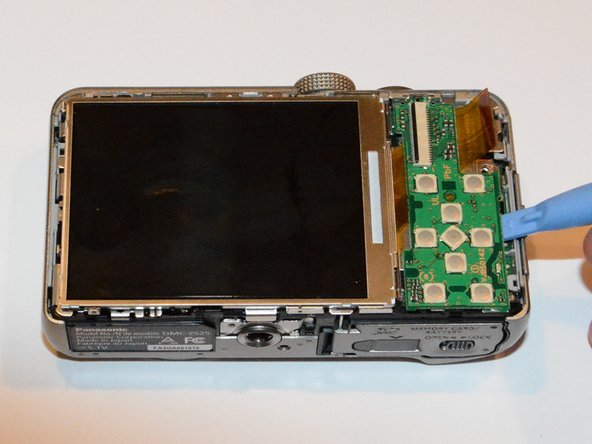

    • Use the plastic opening tool at the bottom right hand side of the button board to lift it up and out.
    • The buttons board comes out with a "click" as it snaps out of a connector below.

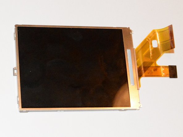

  4. Panasonic Lumix DMC-ZS25 Speaker Replacement: crwdns2935265:04crwdnd2935265:01crwdnd2935265:02crwdne2935265:0 Panasonic Lumix DMC-ZS25 Speaker Replacement: crwdns2935265:04crwdnd2935265:02crwdnd2935265:02crwdne2935265:0
    • The LCD is retained by a clip on the left hand side, which you can release with a plastic opening too.
    • Lift the LCD from the left hand side, disengaging it at the right hand side from two small tabs.

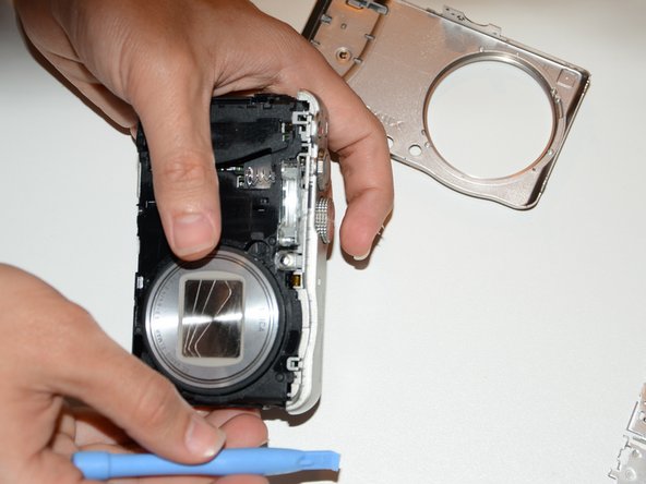

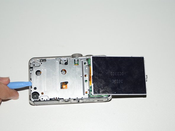

  5. Panasonic Lumix DMC-ZS25 Speaker Replacement: crwdns2935265:05crwdnd2935265:01crwdnd2935265:02crwdne2935265:0 Panasonic Lumix DMC-ZS25 Speaker Replacement: crwdns2935265:05crwdnd2935265:02crwdnd2935265:02crwdne2935265:0
    • Remove the two 4.2 mm screws in order to remove the inner cover located beneath the screen.
    • Having removed the screws, use the plastic opening tool to lift off the inner cover, releasing it from clips on the top and bottom edges.

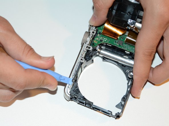

    • Remove the side covers using the plastic opening tool.
  7. Panasonic Lumix DMC-ZS25 Speaker Replacement: crwdns2935265:07crwdnd2935265:01crwdnd2935265:02crwdne2935265:0 Panasonic Lumix DMC-ZS25 Speaker Replacement: crwdns2935265:07crwdnd2935265:02crwdnd2935265:02crwdne2935265:0
    • After removing the side covers, you will be able to pull off the front cover.
    • Be careful when you pull the front cover to avoid breaking anything.

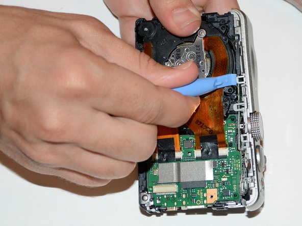

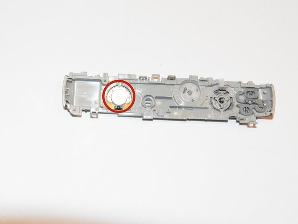

    • Release the top cover by lifting several tabs with the plastic opening tool. Go gently to avoid breaking them.
  10. Panasonic Lumix DMC-ZS25 Speaker Replacement: crwdns2935265:010crwdnd2935265:01crwdnd2935265:03crwdne2935265:0 Panasonic Lumix DMC-ZS25 Speaker Replacement: crwdns2935265:010crwdnd2935265:02crwdnd2935265:03crwdne2935265:0 Panasonic Lumix DMC-ZS25 Speaker Replacement: crwdns2935265:010crwdnd2935265:03crwdnd2935265:03crwdne2935265:0

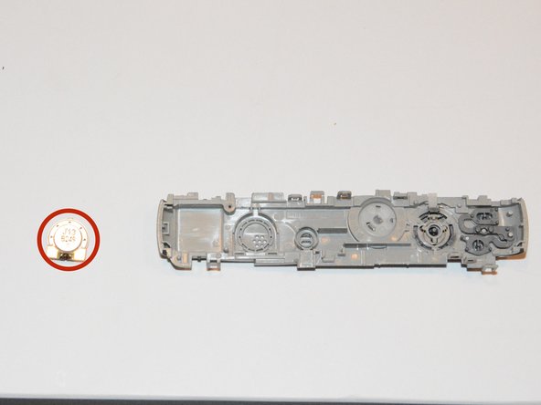

    • With the top cover removed the speaker can be very easily removed or replaced.

In step 5, comparing it with the similar DMC-TZ35 I rather think there should be 3 screws, not 2. A 3rd hole can be seen at the bottom.
