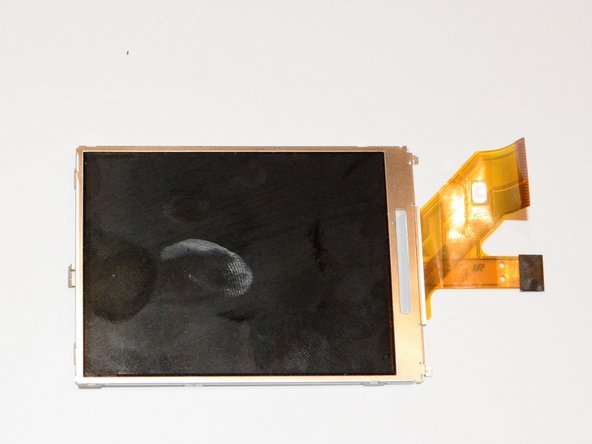

    • Using the spudger, pull upward on the screen cable to release it.

    • Using the plastic opening tool, lift the screen until it clicks.

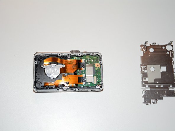

  8. Panasonic Lumix DMC-ZS25 Flash Replacement: crwdns2935265:08crwdnd2935265:01crwdnd2935265:01crwdne2935265:0
    • Using the plastic opening tool, remove the inner cover.
  9. Panasonic Lumix DMC-ZS25 Flash Replacement: crwdns2935265:09crwdnd2935265:01crwdnd2935265:02crwdne2935265:0 Panasonic Lumix DMC-ZS25 Flash Replacement: crwdns2935265:09crwdnd2935265:02crwdnd2935265:02crwdne2935265:0
    • Using your hands or the opening tool, separate the device into two pieces, as shown.

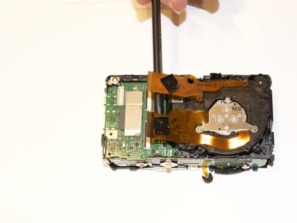

    • Using the spudger, unlock the screen cables from the circuit board.
    • Lift up the black clip to release the cables.

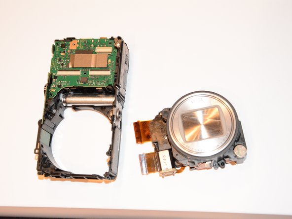

  13. Panasonic Lumix DMC-ZS25 Flash Replacement: crwdns2935265:013crwdnd2935265:01crwdnd2935265:01crwdne2935265:0
    • Using your hands, remove the lens.
  14. Panasonic Lumix DMC-ZS25 Flash Replacement: crwdns2935265:014crwdnd2935265:01crwdnd2935265:01crwdne2935265:0
    • Using the plastic opening tool, pull up on the edge of the circuit board until it clicks.
    • Remove the board.
