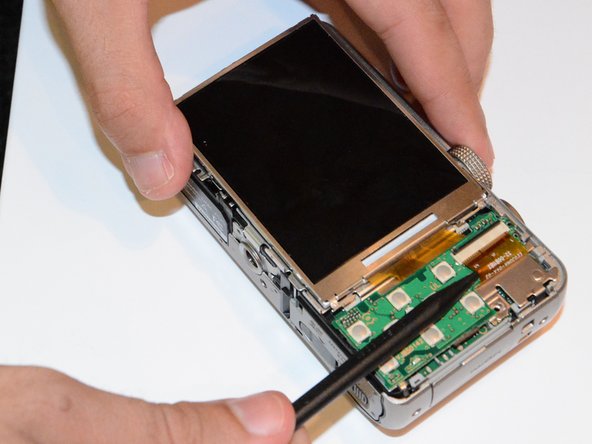

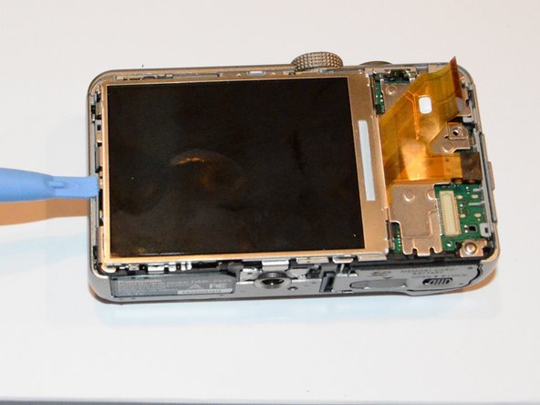

  4. Panasonic Lumix DMC-ZS25  Power Button Replacement: crwdns2935265:04crwdnd2935265:01crwdnd2935265:03crwdne2935265:0 Panasonic Lumix DMC-ZS25  Power Button Replacement: crwdns2935265:04crwdnd2935265:02crwdnd2935265:03crwdne2935265:0 Panasonic Lumix DMC-ZS25  Power Button Replacement: crwdns2935265:04crwdnd2935265:03crwdnd2935265:03crwdne2935265:0
    • Remove the button board using the plastic opening tool.

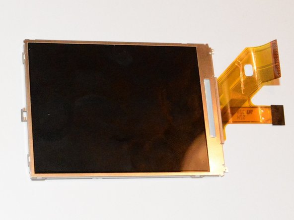

    • Remove the screen. Lift the screen from the right hand side.
    • After your hear a "click" sound, you have successfully opened the screen.

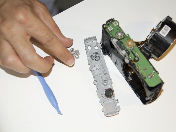

    • Remove the two black screws that are located beneath the screen.
    • Lift the metal cover using the plastic opening tool.
  6. Panasonic Lumix DMC-ZS25  Power Button Replacement: crwdns2935265:06crwdnd2935265:01crwdnd2935265:02crwdne2935265:0 Panasonic Lumix DMC-ZS25  Power Button Replacement: crwdns2935265:06crwdnd2935265:02crwdnd2935265:02crwdne2935265:0
    • Use the plastic opener to remove the side covers.
  7. Panasonic Lumix DMC-ZS25  Power Button Replacement: crwdns2935265:07crwdnd2935265:01crwdnd2935265:02crwdne2935265:0 Panasonic Lumix DMC-ZS25  Power Button Replacement: crwdns2935265:07crwdnd2935265:02crwdnd2935265:02crwdne2935265:0
    • After removing the side covers, you will be able to take away the front cover with your hands.
    • Do not apply too much pressure on the outer cover of your device to avoid damage.

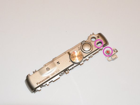

    • To release the top cover of the camera, you need to open the 3.70 mm screw shown in the picture.
  9. Panasonic Lumix DMC-ZS25  Power Button Replacement: crwdns2935265:09crwdnd2935265:01crwdnd2935265:01crwdne2935265:0
    • Remove the top cover using the plastic opening tool.
  10. Panasonic Lumix DMC-ZS25  Power Button Replacement: crwdns2935265:010crwdnd2935265:01crwdnd2935265:03crwdne2935265:0 Panasonic Lumix DMC-ZS25  Power Button Replacement: crwdns2935265:010crwdnd2935265:02crwdnd2935265:03crwdne2935265:0 Panasonic Lumix DMC-ZS25  Power Button Replacement: crwdns2935265:010crwdnd2935265:03crwdnd2935265:03crwdne2935265:0
    • After removing the top cover of the camera, you will be able to easily remove the power button with your hand.
