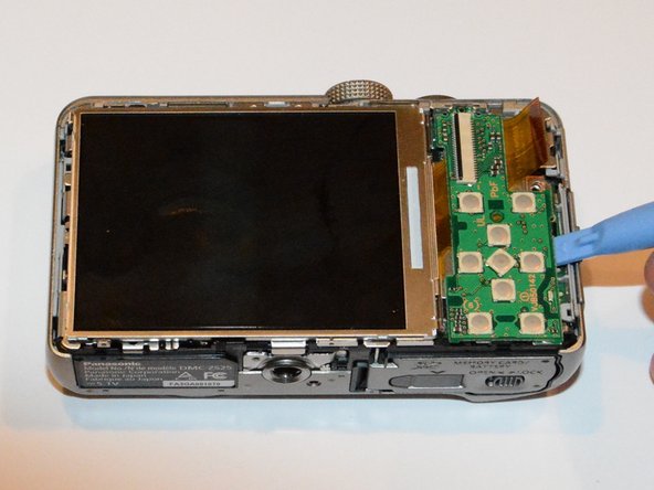

    2. Panasonic Lumix DMC-ZS25  Lens  Replacement: crwdns2935265:02crwdnd2935265:01crwdnd2935265:01crwdne2935265:0
      • Use the iFixit opening tool to open the outer cover of your device.
      • The easiest place to open your device is from the HDMI port.
      • Gently open it to avoid breaking the cover.

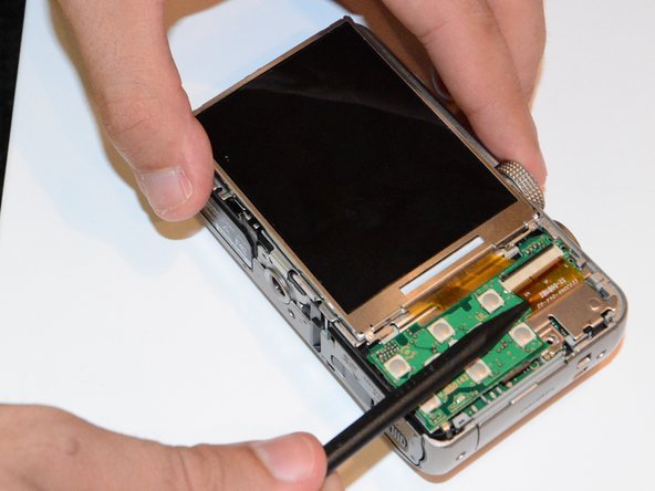

      • Use a spudger to detach the ribbon cable.
      • Be careful when using the spudger, as it can cause damage to the ribbon.
      • After releasing the screen cable, use the iFixit opening tool to lift the button board.
      • Once you hear a "click" sound, you have successfully opened the buttons board.

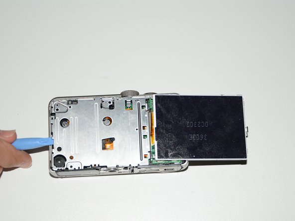

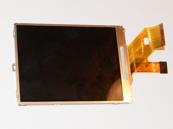

    4. Panasonic Lumix DMC-ZS25  Lens  Replacement: crwdns2935265:04crwdnd2935265:01crwdnd2935265:02crwdne2935265:0 Panasonic Lumix DMC-ZS25  Lens  Replacement: crwdns2935265:04crwdnd2935265:02crwdnd2935265:02crwdne2935265:0
      • Remove the screen using the iFixit opening tool.
    5. Panasonic Lumix DMC-ZS25  Lens  Replacement: crwdns2935265:05crwdnd2935265:01crwdnd2935265:02crwdne2935265:0 Panasonic Lumix DMC-ZS25  Lens  Replacement: crwdns2935265:05crwdnd2935265:02crwdnd2935265:02crwdne2935265:0

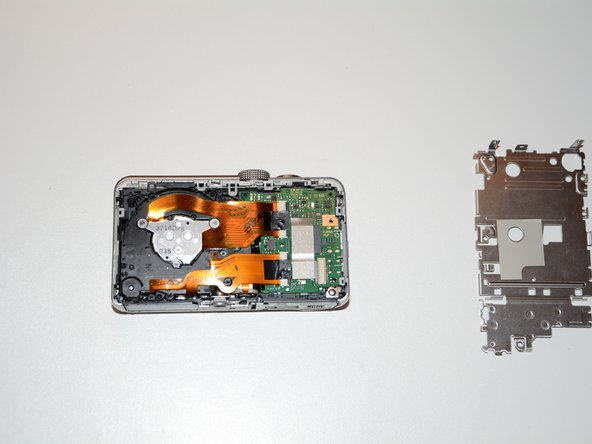

      • Open the two 4.20 mm screws to remove the inner cover located beneath the screen.
      • Use the iFixit opening tool to assist in safely removing the inner cover.

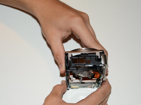

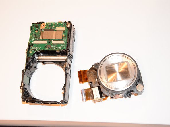

    6. Panasonic Lumix DMC-ZS25  Lens  Replacement: crwdns2935265:06crwdnd2935265:01crwdnd2935265:02crwdne2935265:0 Panasonic Lumix DMC-ZS25  Lens  Replacement: crwdns2935265:06crwdnd2935265:02crwdnd2935265:02crwdne2935265:0
      • Separate the device into two pieces as shown.

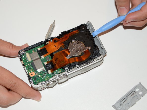

    7. Panasonic Lumix DMC-ZS25  Lens  Replacement: crwdns2935265:07crwdnd2935265:01crwdnd2935265:03crwdne2935265:0 Panasonic Lumix DMC-ZS25  Lens  Replacement: crwdns2935265:07crwdnd2935265:02crwdnd2935265:03crwdne2935265:0 Panasonic Lumix DMC-ZS25  Lens  Replacement: crwdns2935265:07crwdnd2935265:03crwdnd2935265:03crwdne2935265:0
      • Remove the side cover using the iFixit opening tool.
      • Exercise caution when you remove the front cover as damage to the device can occur.

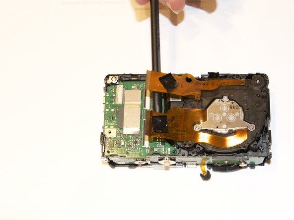

    8. Panasonic Lumix DMC-ZS25  Lens  Replacement: crwdns2935265:08crwdnd2935265:01crwdnd2935265:03crwdne2935265:0 Panasonic Lumix DMC-ZS25  Lens  Replacement: crwdns2935265:08crwdnd2935265:02crwdnd2935265:03crwdne2935265:0 Panasonic Lumix DMC-ZS25  Lens  Replacement: crwdns2935265:08crwdnd2935265:03crwdnd2935265:03crwdne2935265:0
      • Use the spudger to unlock the screen cables from the circuit bored. Carefully, lift up the black clip up to release the cables.
      • Use your hands to remove the lens.
