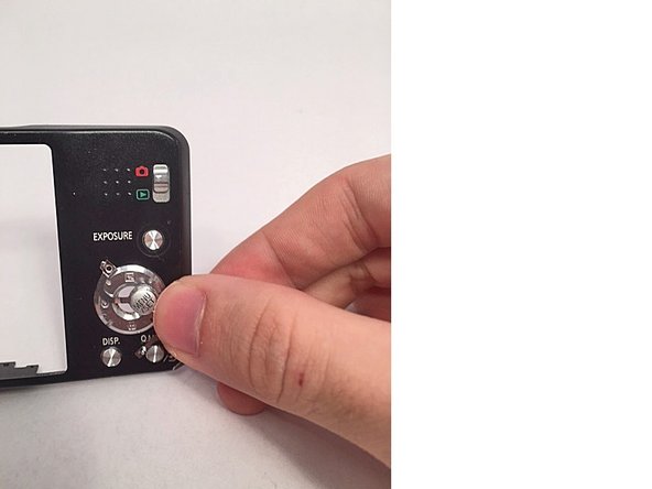

    • Start by removing the screws located on the left and right hand side panels of the camera (two sets of pairs of screws). Next remove the pair of screws on the bottom of the camera. (6 in total)
  2. Panasonic Lumix DMC-ZS19 Menu/Set Button  Replacement: crwdns2935265:02crwdnd2935265:01crwdnd2935265:01crwdne2935265:0
    • Gently remove the loosened panel from the LCD screen.

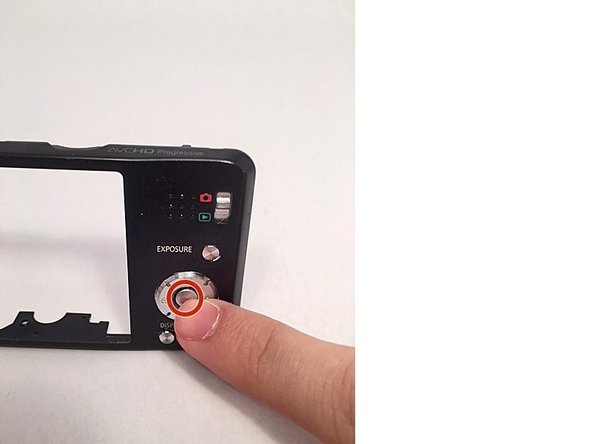

  3. Panasonic Lumix DMC-ZS19 Menu/Set Button  Replacement: crwdns2935265:03crwdnd2935265:01crwdnd2935265:03crwdne2935265:0 Panasonic Lumix DMC-ZS19 Menu/Set Button  Replacement: crwdns2935265:03crwdnd2935265:02crwdnd2935265:03crwdne2935265:0 Panasonic Lumix DMC-ZS19 Menu/Set Button  Replacement: crwdns2935265:03crwdnd2935265:03crwdnd2935265:03crwdne2935265:0
    • Carefully use a finger to pop out the Menu/Set button from the panel by pushing on it.
