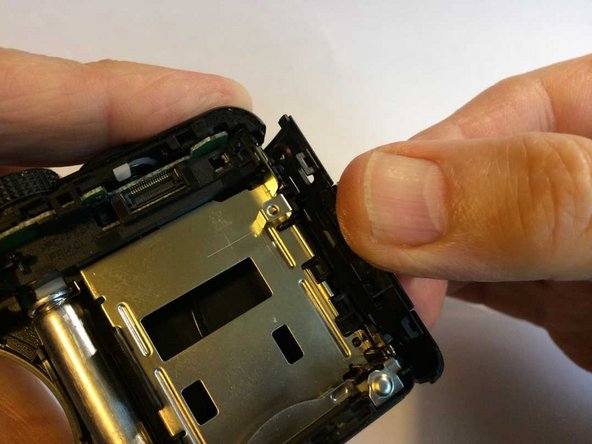

  9. Panasonic Lumix DMC-TZ35 Top assembly removal/replacement, Removing the side panels: crwdns2935265:09crwdnd2935265:01crwdnd2935265:03crwdne2935265:0 Panasonic Lumix DMC-TZ35 Top assembly removal/replacement, Removing the side panels: crwdns2935265:09crwdnd2935265:02crwdnd2935265:03crwdne2935265:0 Panasonic Lumix DMC-TZ35 Top assembly removal/replacement, Removing the side panels: crwdns2935265:09crwdnd2935265:03crwdnd2935265:03crwdne2935265:0
    • To remove the top assembly it is first necessary to remove the side pieces and the metal front. On reassembly these all snap together again very easily, provided only that they are correctly aligned.
    • Release two tabs on the right hand side
    • You can now angle the side piece away and lift it out.
    • In the left hand side, release one tab.
    • Now release a clip at the bottom in order to remove the side piece.

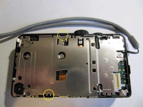

  10. Panasonic Lumix DMC-TZ35 Top assembly removal/replacement, Removing the camera front: crwdns2935265:010crwdnd2935265:01crwdnd2935265:01crwdne2935265:0
    • The metal camera front can now simply be pulled off. Ease it on all 4 sides with a spudger
  11. Panasonic Lumix DMC-TZ35 Top assembly removal/replacement, Removing the top assembly complete: crwdns2935265:011crwdnd2935265:01crwdnd2935265:02crwdne2935265:0 Panasonic Lumix DMC-TZ35 Top assembly removal/replacement, Removing the top assembly complete: crwdns2935265:011crwdnd2935265:02crwdnd2935265:02crwdne2935265:0

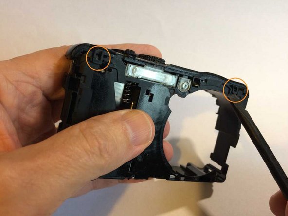

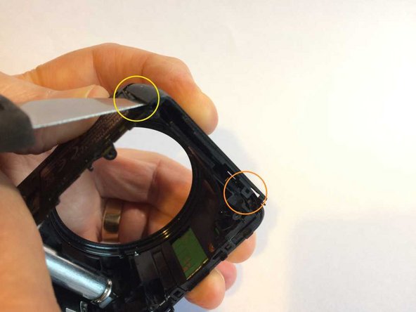

    • Release two clips retaining the rear of the top assembly.
    • Release two clips on the front of the top assembly, whilst trying not to let the clips on the rear re-engage.
  12. Panasonic Lumix DMC-TZ35 Top assembly removal/replacement, Top assembly - NB: Warning!: crwdns2935265:012crwdnd2935265:01crwdnd2935265:02crwdne2935265:0 Panasonic Lumix DMC-TZ35 Top assembly removal/replacement, Top assembly - NB: Warning!: crwdns2935265:012crwdnd2935265:02crwdnd2935265:02crwdne2935265:0
    • Lift off the top assembly. If it won't come then one or more of the clips has probably re-engaged
    • Note the large cylindrical flash capacitor. Even after many hours it may still retain a dangerous high voltage charge. Please read on!
    • The capacitor contacts are shown in the second photo. DO NOT TOUCH! You can discharge the capacitor by shorting them out with a small insulated handle screwdriver, but be prepared for a very healthy spark! (You really woudn't want that going through your fingers, would you?)
    • Or for preference, take two insulated crocodile clip leads, connect one end of each to a 100k resistor and hold the other ends on the contacts for at least 10 seconds. Take great care not to touch the metal of the crocodile clips or the resistor wires. Measure the voltage between the contacts and don't proceed unless it has fallen below 20V.

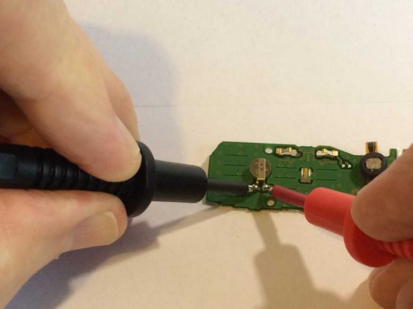

  13. Panasonic Lumix DMC-TZ35 Top assembly removal/replacement, Backup cell: crwdns2935265:013crwdnd2935265:01crwdnd2935265:03crwdne2935265:0 Panasonic Lumix DMC-TZ35 Top assembly removal/replacement, Backup cell: crwdns2935265:013crwdnd2935265:02crwdnd2935265:03crwdne2935265:0 Panasonic Lumix DMC-TZ35 Top assembly removal/replacement, Backup cell: crwdns2935265:013crwdnd2935265:03crwdnd2935265:03crwdne2935265:0
    • Remove a single screw from the controls board. (It is not necessary to release the small ribbon from its socket on the other side.)
    • With a spudger, the controls board can now be lifted off the pegs which retain it within the top assembly.
    • On the hidden side of the board is a small rechargeable lithium cell which maintains the time and settings when the main battery has been removed. Measure its voltage.
    • If the voltage reads less than 2V it may be permanently damaged and will be unable to maintain the time or settings across a main battery change. It is very important to replace it only by another rechargeable lithium cell, not a regular lithium button cell, which would probably leak and cause damage.
    • On reassembly you may have to rotate the function wheel until it engages with the function switch on the board.
