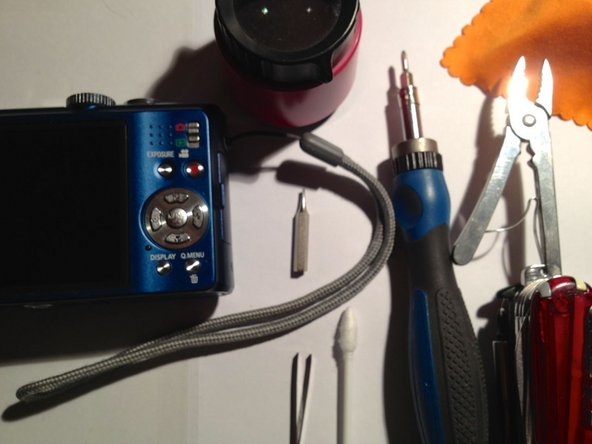

  2. Panasonic Lumix DMC-TZ10 Image Sensor Repair, Tools I used: crwdns2935265:02crwdnd2935265:01crwdnd2935265:01crwdne2935265:0
    • Magnifying Glas
    • Electronics Screwdriver set
    • Cloth and Q-Tips
    • tweezers
    • My Swiss-Army Knife :-)
    • TIP! have a sheet of letter paper to put the parts on as you remove them. You can keep them in removal order so it's easy to reverse the sequence on reassembly.

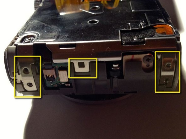

  3. Panasonic Lumix DMC-TZ10 Image Sensor Repair, Front panel removal: crwdns2935265:03crwdnd2935265:01crwdnd2935265:02crwdne2935265:0 Panasonic Lumix DMC-TZ10 Image Sensor Repair, Front panel removal: crwdns2935265:03crwdnd2935265:02crwdnd2935265:02crwdne2935265:0
    • Remove Bottom screws
    • 3 visible in the picture
    • 2 off screen
    • Only for the DMC-ZS10: there are 4 extra screws to remove, two on each end.
    • Remove front panel

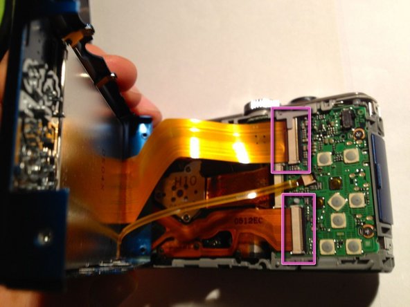

  5. Panasonic Lumix DMC-TZ10 Image Sensor Repair, Lift back cover: crwdns2935265:05crwdnd2935265:01crwdnd2935265:03crwdne2935265:0 Panasonic Lumix DMC-TZ10 Image Sensor Repair, Lift back cover: crwdns2935265:05crwdnd2935265:02crwdnd2935265:03crwdne2935265:0 Panasonic Lumix DMC-TZ10 Image Sensor Repair, Lift back cover: crwdns2935265:05crwdnd2935265:03crwdnd2935265:03crwdne2935265:0
    • Carefully lift the cover slightly upwards
    • Remove the switch
    • It's only secured with a clip at one side and might fall off during handling, if not removed now. However, this step is - optional-
    • Lift sideways and remove the two PCB connectors
    • Best use your fingernail or a soft plastic spudger to gently flip the black plastic on the side of the connector to the right until it flips over
    • Then gently pull the PCB to the left outwards without damaging it or bending it too sharply
    • Remove back cover completely

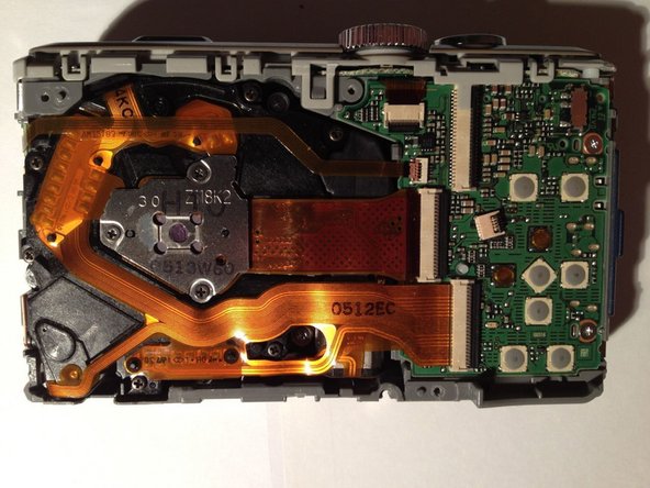

  6. Panasonic Lumix DMC-TZ10 Image Sensor Repair, Remove protective metal cover: crwdns2935265:06crwdnd2935265:01crwdnd2935265:03crwdne2935265:0 Panasonic Lumix DMC-TZ10 Image Sensor Repair, Remove protective metal cover: crwdns2935265:06crwdnd2935265:02crwdnd2935265:03crwdne2935265:0 Panasonic Lumix DMC-TZ10 Image Sensor Repair, Remove protective metal cover: crwdns2935265:06crwdnd2935265:03crwdnd2935265:03crwdne2935265:0
    • Remove screws
    • Lift metal clamps gently
    • Remove metal cover

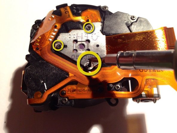

  7. Panasonic Lumix DMC-TZ10 Image Sensor Repair, Remove Imaging Chip: crwdns2935265:07crwdnd2935265:01crwdnd2935265:03crwdne2935265:0 Panasonic Lumix DMC-TZ10 Image Sensor Repair, Remove Imaging Chip: crwdns2935265:07crwdnd2935265:02crwdnd2935265:03crwdne2935265:0 Panasonic Lumix DMC-TZ10 Image Sensor Repair, Remove Imaging Chip: crwdns2935265:07crwdnd2935265:03crwdnd2935265:03crwdne2935265:0
    • Remove screws holding the Chip assembly
    • Remove PCB Connector (optional) or simply and carefully flip the assembly over

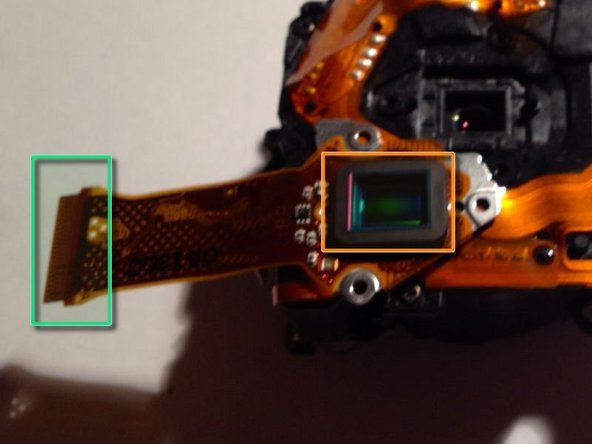

    • Now the Chip with its protective cover is accessible
    • Note: The last two images show the whole imaging subassembly removed - this is NOT required if you only want to access the chip
  8. Panasonic Lumix DMC-TZ10 Image Sensor Repair, Clean the protective cover: crwdns2935265:08crwdnd2935265:01crwdnd2935265:02crwdne2935265:0 Panasonic Lumix DMC-TZ10 Image Sensor Repair, Clean the protective cover: crwdns2935265:08crwdnd2935265:02crwdnd2935265:02crwdne2935265:0
    • Clean the protective cover (without any cleaning fluid so to not leave residue on the glass)
    • Use a Q-Tip or a lint-free cloth like for glases and check with the magnifier for success
    • This is a delicate procedure that requires much care and a dust free environment

Step 3: there are only 3 screws in the bottom; as commented by others, there are 2 screws on each side plate. Note that each side plate slides in at the top.
Step 5: there are three PCB connectors; 1 wide, 2 narrow. NOTE: one of the narrow ones (on mine) had the gold connector side facing down, the other 2 had the gold facing up. (I learned this the hard way after putting all with gold up, reassembling the camera, and the screen did not work.)
Step 5: the display screen did not stay with the camera back when I removed the back; it is clipped into the body. There is some black sticky gasket material around most of the inside of the back piece; a small part of this pulled away from the back piece, so I used a tiny amount of glue stick to stick it back down. I figure this helps keep dust out.

(continued from previous) a. the side piece screws had some thread lock on them, and were very difficult to remove. I resorted to using a small pliers on the jewelers screwdriver while pressing down to break each one loose. Be careful. (I also used a teeny amount of locktite on each one when I put it back together.)

c. Some instructions for these jobs suggests a bulb-type air blower to get dust out. I used a rubber ear irrigator bulb that I happen to have - just be certain that it is dry inside!

From outside it looks very similar to the TZ-10 pictured here. I encountered the same problem with the narrow PCB connector as Paul Fishman. It was quite hard to stick it back into the connector. The golden side is also facing the other way.
Also the side plates need to be removed for this camera.

Only one comment about PCB connector, I disconnected it to make it easier but not so easy to replug during reassembling! But it's done. So if you can avoid it, my recomendation is to not disconnect any cable.

Be carefull when cleaning the IR filter - you will blow it away easily.
