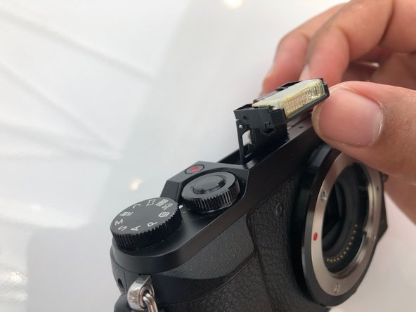

    • Orient the camera so that the display screen is facing you.
    • Press the flash button to reveal the camera's pop-up flash.

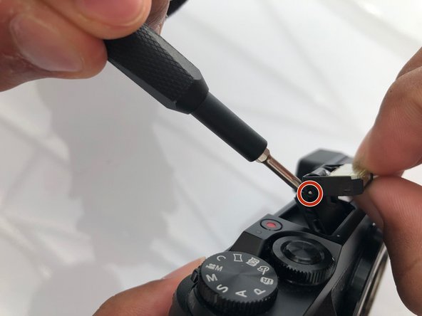

    • Orient the camera so that the lens is facing you.
    • Remove two 2mm Phillips #0 screws on the sides of the flash.
  3. Panasonic Lumix DMC-GX85 Pop-up Flash Spring Replacement: crwdns2935265:03crwdnd2935265:01crwdnd2935265:02crwdne2935265:0 Panasonic Lumix DMC-GX85 Pop-up Flash Spring Replacement: crwdns2935265:03crwdnd2935265:02crwdnd2935265:02crwdne2935265:0
    • Remove the cover of the flash.

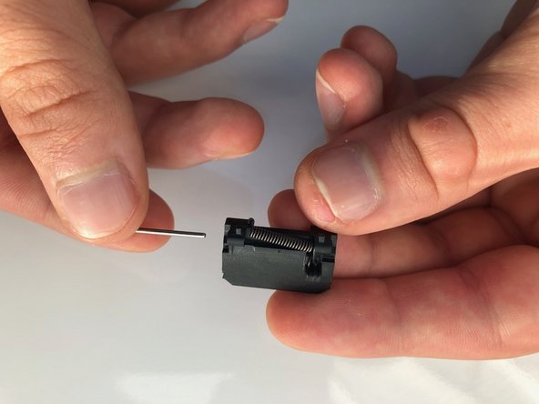

    • Remove the 19mm pin by simply pushing from one side using the pointed end of a spudger.
    • Once the pin is removed, the bottom housing of the flash can be taken off from the camera by hand.
  5. Panasonic Lumix DMC-GX85 Pop-up Flash Spring Replacement: crwdns2935265:05crwdnd2935265:01crwdnd2935265:02crwdne2935265:0 Panasonic Lumix DMC-GX85 Pop-up Flash Spring Replacement: crwdns2935265:05crwdnd2935265:02crwdnd2935265:02crwdne2935265:0
    • Similar to the previous step, remove the 19mm pin by pushing it from one side using the pointed end of a spudger.

Hello,
sorry to bother you, but i would like to ask you for an expert opinion - help.
I had to replace the flash spring on my device / camera. After installation, the flash works as it should, but when closing the flash and turning off the camera, the camera tells me to insert the flash (then it turns off classically). I noticed that there was a small magnet in the flash, which I assume a function to confirm the closing of the flash door.
I would just like to ask where exactly to place it? I've already tried all the places where it should be stored, but I'm still groping ... (see photo)
I will be very grateful for your advice.
Regards and good health, Martin
