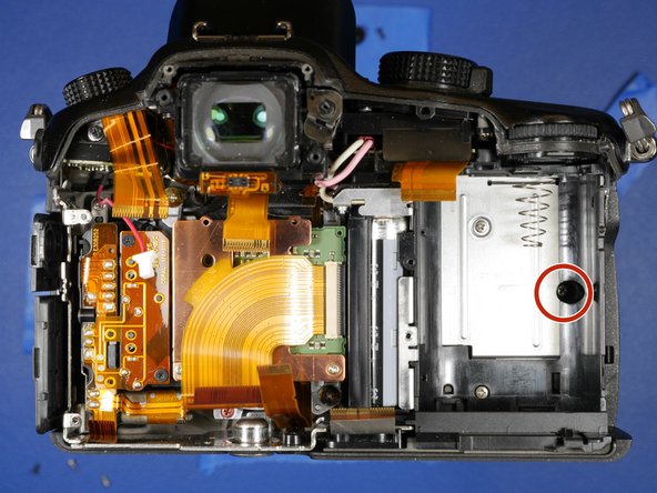

    • There are 6 screws on the bottom of the camera. One is hidden in the battery compartment.
  6. Panasonic Lumix DMC-GH3 Disassembly: crwdns2935265:06crwdnd2935265:01crwdnd2935265:01crwdne2935265:0
    • This screw is a bit of a pain to remove as it requires a long shaft screw driver.
    • From here on in, it is strongly recommended to use tape to keep track of the screws as you disassemble the camera. Screws are not always uniform in length or thread type, and some are aluminum, so tape works best here.

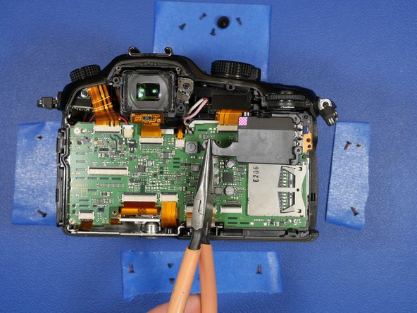

  8. Panasonic Lumix DMC-GH3 Disassembly: crwdns2935265:08crwdnd2935265:01crwdnd2935265:01crwdne2935265:0
    • Once the electronics are exposed, it is highly recommended that you remain ESD safe. ESD can fry your precious electronics, and pass thousands of volts through components only rated for a few V DC. ESD can sure ruin your day if you are not careful.
    • Use an ESD mat and wrist strap, and make sure you are grounded for the remaining of the teardown. Make sure your ESD mat is connected to the ground of a nearby outlet, and make sure your house actually has a ground. Consult an electrician if you are unsure.

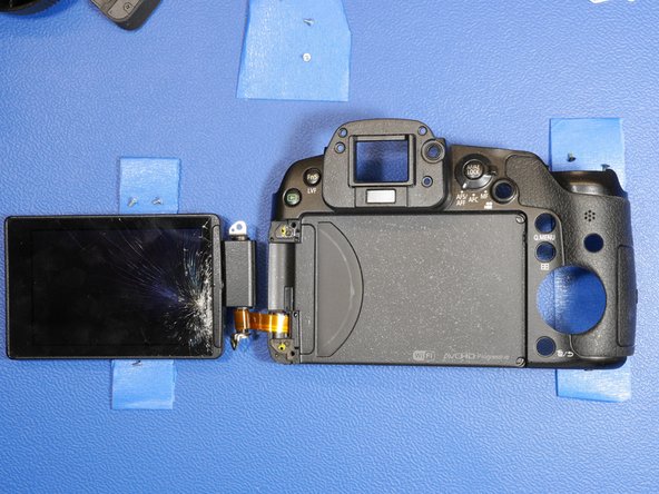

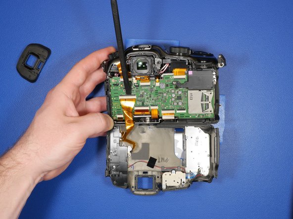

  9. Panasonic Lumix DMC-GH3 Disassembly: crwdns2935265:09crwdnd2935265:01crwdnd2935265:02crwdne2935265:0 Panasonic Lumix DMC-GH3 Disassembly: crwdns2935265:09crwdnd2935265:02crwdnd2935265:02crwdne2935265:0
    • The rear LCD shell can be rotated away from the rest of the shell like a hinge.
    • Be careful not to pull too hard on the ribbon cables!
    • The back LCD and button assembly attached to the main PCB through 2 ribbon cables.
    • Use a plastic spudger to remove the ribbon cables from the LCD ribbon connectors.

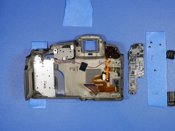

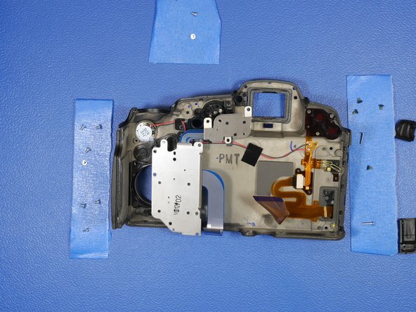

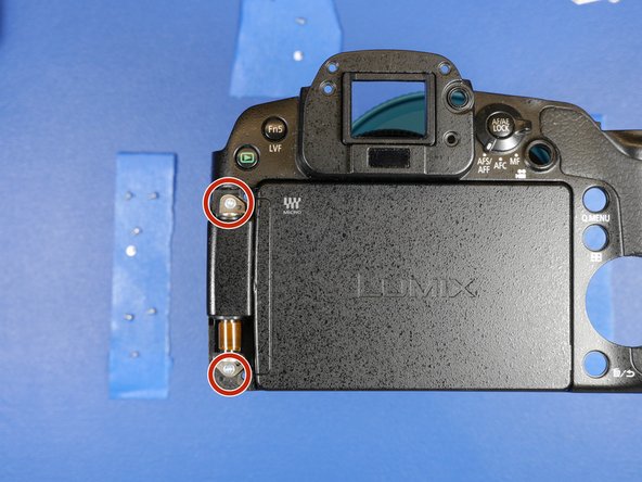

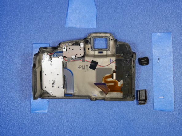

    • This is the rear shell assembly of the GH3. This contains the LCD sub-assembly buttons and switches.
    • To remove the LCD hinge covers, remove the two screws circled on the right.
    • The hinge covers will simply drop out from the other side.

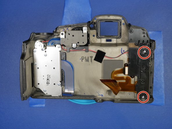

  11. Panasonic Lumix DMC-GH3 Disassembly: crwdns2935265:011crwdnd2935265:01crwdnd2935265:03crwdne2935265:0 Panasonic Lumix DMC-GH3 Disassembly: crwdns2935265:011crwdnd2935265:02crwdnd2935265:03crwdne2935265:0 Panasonic Lumix DMC-GH3 Disassembly: crwdns2935265:011crwdnd2935265:03crwdnd2935265:03crwdne2935265:0
    • Here's what the rear shell looks like without the LCD hinge covers.
    • To get further access to the LCD, Remove the 4 screws holding on the plastic cover to the back of the unit.
    • This reveals the ribbon cables from the LCD.

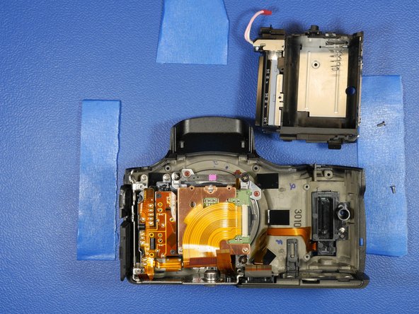

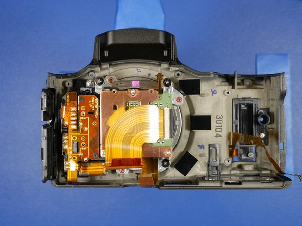

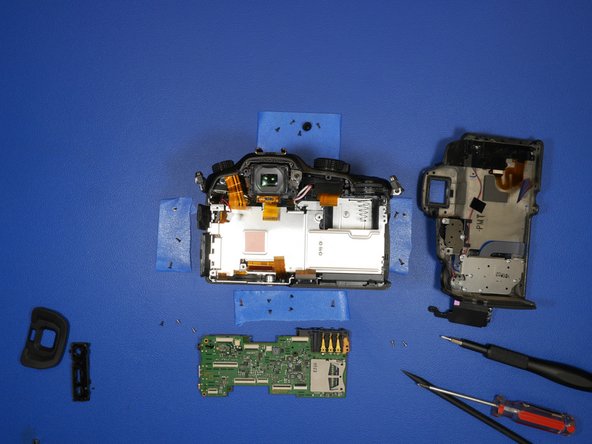

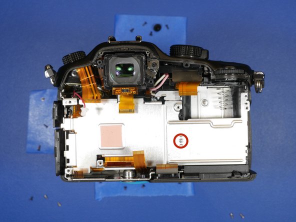

    • Back to the rest of the camera. With the back LCD shell assembly removed from the body of the camera, It's time to remove the main PCB.
    • Remove the 5 circled screws. There is a back plastic cover that protects the battery PCB terminals. That should come free once these screws are removed.

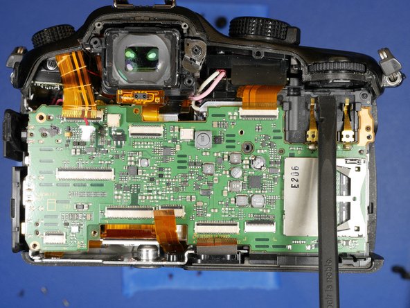

  15. Panasonic Lumix DMC-GH3 Disassembly: crwdns2935265:015crwdnd2935265:01crwdnd2935265:03crwdne2935265:0 Panasonic Lumix DMC-GH3 Disassembly: crwdns2935265:015crwdnd2935265:02crwdnd2935265:03crwdne2935265:0 Panasonic Lumix DMC-GH3 Disassembly: crwdns2935265:015crwdnd2935265:03crwdnd2935265:03crwdne2935265:0
    • With the cover removed, go ahead and begin removing all the ribbon cables from the PCB. Remove the 2 pin connector as well.
    • There is one more screw holding in the PCB. Remove the screw on the left hand side of the camera which holds the I/O cover to the PCB.
    • The PCB should now be relatively lose inside the camera.
  16. Panasonic Lumix DMC-GH3 Disassembly: crwdns2935265:016crwdnd2935265:01crwdnd2935265:03crwdne2935265:0 Panasonic Lumix DMC-GH3 Disassembly: crwdns2935265:016crwdnd2935265:02crwdnd2935265:03crwdne2935265:0 Panasonic Lumix DMC-GH3 Disassembly: crwdns2935265:016crwdnd2935265:03crwdnd2935265:03crwdne2935265:0
    • There are 2 black plastic tabs that hold in the PCB. Use a plastic spudger to depress the tabs.
    • The PCB should now come out freely.

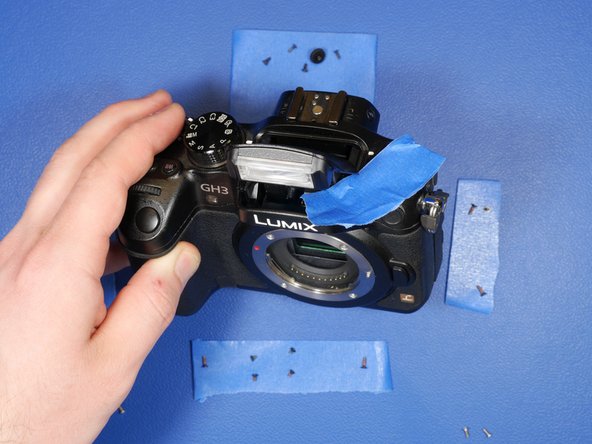

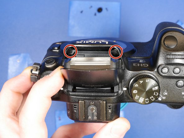

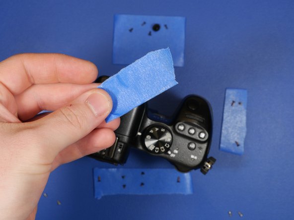

  18. Panasonic Lumix DMC-GH3 Disassembly: crwdns2935265:018crwdnd2935265:01crwdnd2935265:03crwdne2935265:0 Panasonic Lumix DMC-GH3 Disassembly: crwdns2935265:018crwdnd2935265:02crwdnd2935265:03crwdne2935265:0 Panasonic Lumix DMC-GH3 Disassembly: crwdns2935265:018crwdnd2935265:03crwdnd2935265:03crwdne2935265:0
    • Since the camera is powered off and the battery is removed, the electronically controlled pop-up flash is non-operational. Thus, continuing the repair a bit of a hassle as getting to the two screws is impossible.
    • This means you would have to pop-up the flash before starting the entire diassembly process! This is rather silly, because the pop-up flash gets in the way when disassembling the rest of the camera and it is a delicate assembly.
    • I discovered an easy solution. Take a piece of blue tape, fold it over and shove it between the flash assembly and the shell of the camera.

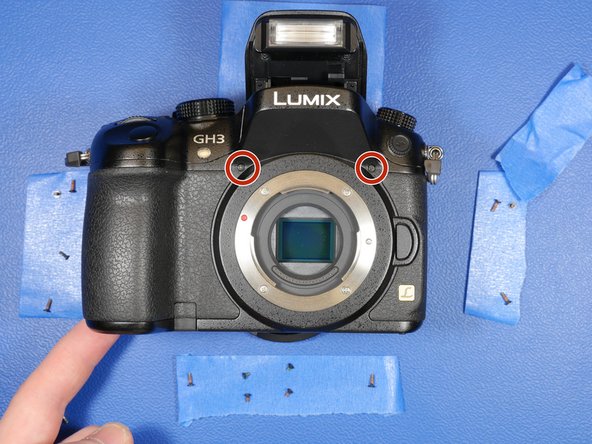

  19. Panasonic Lumix DMC-GH3 Disassembly: crwdns2935265:019crwdnd2935265:01crwdnd2935265:03crwdne2935265:0 Panasonic Lumix DMC-GH3 Disassembly: crwdns2935265:019crwdnd2935265:02crwdnd2935265:03crwdne2935265:0 Panasonic Lumix DMC-GH3 Disassembly: crwdns2935265:019crwdnd2935265:03crwdnd2935265:03crwdne2935265:0
    • Take this doubled over piece of tape and forcefully shove it toward the back of the flash camera unit. This will trigger the pop-up flash latch release inside the camera and allow you to continue the disassembly without ever needing power!
    • Those two little screws are the culprit! The funny thing is the previous camera, the Lumix GH2, also featured screws here, but the pop-up flash had a manual switch! I guess the designers forgot about this when they implemented an electronic flash trigger switch.
  20. Panasonic Lumix DMC-GH3 Disassembly: crwdns2935265:020crwdnd2935265:01crwdnd2935265:03crwdne2935265:0 Panasonic Lumix DMC-GH3 Disassembly: crwdns2935265:020crwdnd2935265:02crwdnd2935265:03crwdne2935265:0 Panasonic Lumix DMC-GH3 Disassembly: crwdns2935265:020crwdnd2935265:03crwdnd2935265:03crwdne2935265:0
    • You will need a long shaft JIS screwdriver here too! I didn't have one long enough, so I cheated and used a Phillips to remove these two screws
    • Remove the two screws from the front face of the camera as well.
    • Remove the one screw holding in the aluminum heatsink to the remainder of the camera.

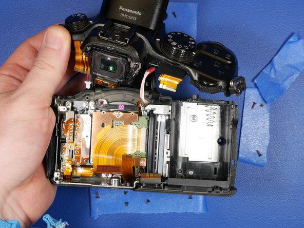

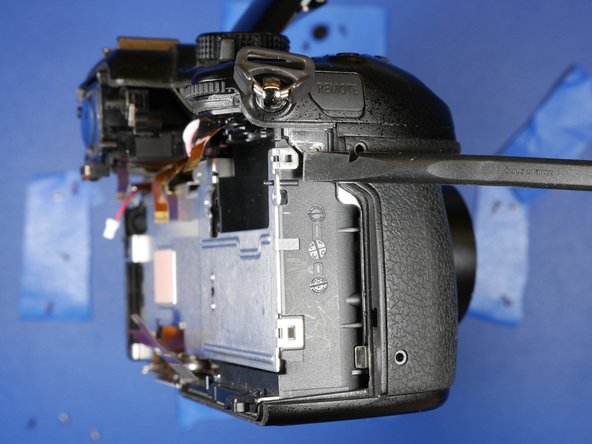

  22. Panasonic Lumix DMC-GH3 Disassembly: crwdns2935265:022crwdnd2935265:01crwdnd2935265:03crwdne2935265:0 Panasonic Lumix DMC-GH3 Disassembly: crwdns2935265:022crwdnd2935265:02crwdnd2935265:03crwdne2935265:0 Panasonic Lumix DMC-GH3 Disassembly: crwdns2935265:022crwdnd2935265:03crwdnd2935265:03crwdne2935265:0
    • The grip should now be free and come off the camera easily.
    • Panasonic hid the wifi unit under the grip. This is quite clever since the grip is entirely plastic and electromagnetic waves have little trouble passing through plastic. If they buried the antenna unit further inside the camera, the performance would be greatly hindered by the other metal shelled components.
    • The top unit should now be loose and come free from the camera.

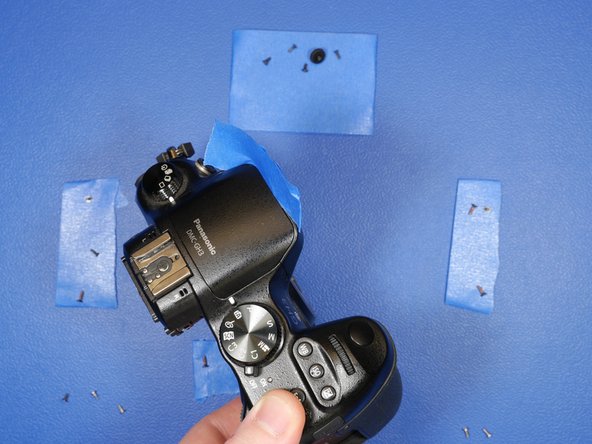

  23. Panasonic Lumix DMC-GH3 Disassembly: crwdns2935265:023crwdnd2935265:01crwdnd2935265:03crwdne2935265:0 Panasonic Lumix DMC-GH3 Disassembly: crwdns2935265:023crwdnd2935265:02crwdnd2935265:03crwdne2935265:0 Panasonic Lumix DMC-GH3 Disassembly: crwdns2935265:023crwdnd2935265:03crwdnd2935265:03crwdne2935265:0

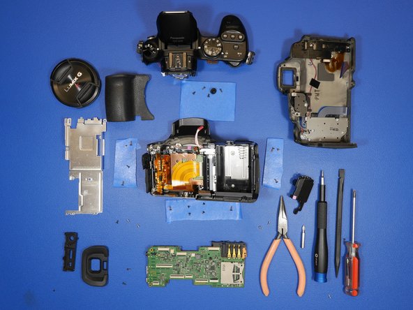

    • The top unit should be held on only by the flash unit cable. Disconnect this cable and the top unit is now free.
    • If your workbench is a mess at this point you're heading in the right direction!

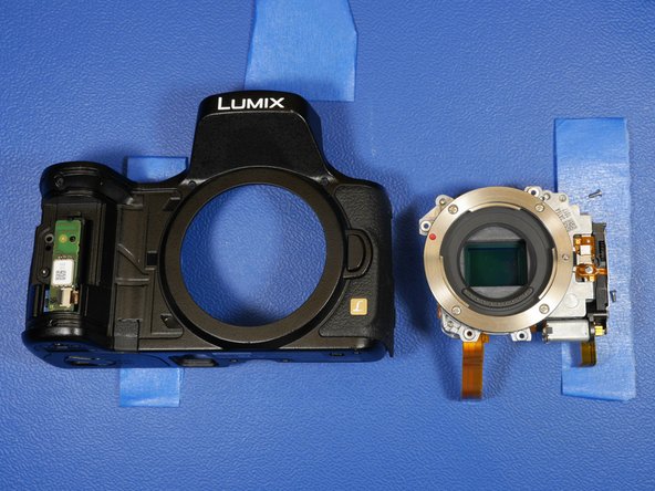

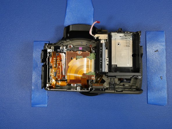

  24. Panasonic Lumix DMC-GH3 Disassembly: crwdns2935265:024crwdnd2935265:01crwdnd2935265:03crwdne2935265:0 Panasonic Lumix DMC-GH3 Disassembly: crwdns2935265:024crwdnd2935265:02crwdnd2935265:03crwdne2935265:0 Panasonic Lumix DMC-GH3 Disassembly: crwdns2935265:024crwdnd2935265:03crwdnd2935265:03crwdne2935265:0

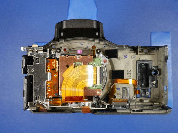

    • The sensor block assembly, front shell and battery compartment are all that's left of this camera.
    • Let's start with the battery compartment. Remove the two circled screws.
    • The battery compartment should just slide up and out of the camera shell.
  25. Panasonic Lumix DMC-GH3 Disassembly: crwdns2935265:025crwdnd2935265:01crwdnd2935265:03crwdne2935265:0 Panasonic Lumix DMC-GH3 Disassembly: crwdns2935265:025crwdnd2935265:02crwdnd2935265:03crwdne2935265:0 Panasonic Lumix DMC-GH3 Disassembly: crwdns2935265:025crwdnd2935265:03crwdnd2935265:03crwdne2935265:0

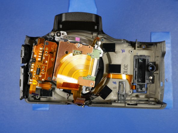

    • Before removing the sensor block assembly, the sub frame assembly must be removed.
    • Remove the two screws circled. This will provide full access to the sensor block assembly mount screws.
  26. Panasonic Lumix DMC-GH3 Disassembly: crwdns2935265:026crwdnd2935265:01crwdnd2935265:03crwdne2935265:0 Panasonic Lumix DMC-GH3 Disassembly: crwdns2935265:026crwdnd2935265:02crwdnd2935265:03crwdne2935265:0 Panasonic Lumix DMC-GH3 Disassembly: crwdns2935265:026crwdnd2935265:03crwdnd2935265:03crwdne2935265:0
    • This is the most important step in the entire repair disassembly process. This is the sensor block unit. Do not touch any part of this assembly other than the screw mount flanges on the magnesium machined assembly. In this case, I bent up the sensor ribbon cable lightly. I didn't touch any surface or place additional force on any sensor block part.
    • Placing pressure on any part of this unit will change the sensor characteristic and and will require re-calibration and reprogramming of the sensor EEPROM. The tools for reprogramming the sensor calibration EEPROM are not publicly available to my knowledge.
    • It is important to only unscrew the purple-tinted screws which are circled. Do not adjust or touch the spring loaded screws on the sensor block. These screws are adjusted at time of sensor calibration in the Panasonic assembly and testing factory.
    • The plane of the sensor is calibrated to the plane of the lens elements or lens mount. Adjusting the tension on any sensor box mount screw makes the sensor and elements out of orthogonal alignment.
    • That's it! Remember to keep track of those screws!
