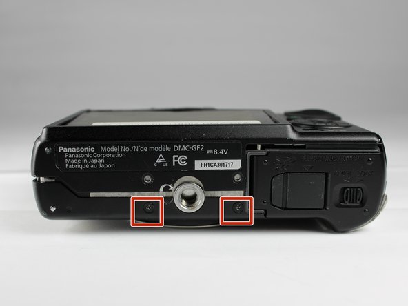

    • On the bottom of the camera, use your finger to push the lock button to the open position which will cause the hinged door to swing open.
  2. Panasonic Lumix DMC-GF2 Front Cover Replacement: crwdns2935265:02crwdnd2935265:01crwdnd2935265:02crwdne2935265:0 Panasonic Lumix DMC-GF2 Front Cover Replacement: crwdns2935265:02crwdnd2935265:02crwdnd2935265:02crwdne2935265:0
    • Push the small black tab that holds the battery with your finger to release the battery.
    • Use your fingers to pull the battery out of the camera.
  3. Panasonic Lumix DMC-GF2 Front Cover Replacement, Front Cover: crwdns2935265:03crwdnd2935265:01crwdnd2935265:03crwdne2935265:0 Panasonic Lumix DMC-GF2 Front Cover Replacement, Front Cover: crwdns2935265:03crwdnd2935265:02crwdnd2935265:03crwdne2935265:0 Panasonic Lumix DMC-GF2 Front Cover Replacement, Front Cover: crwdns2935265:03crwdnd2935265:03crwdnd2935265:03crwdne2935265:0
    • Using a Philips #00 screwdriver, remove six 2.69 mm screws located on the two short sides and on the bottom of the camera.
    • To loosen a screw, turn the screwdriver to the left. To tighten a screw, turn the screwdriver to the right.
  4. Panasonic Lumix DMC-GF2 Front Cover Replacement: crwdns2935265:04crwdnd2935265:01crwdnd2935265:01crwdne2935265:0
    • Using a Phillips #00 screwdriver, remove four black 2.69 mm screws from the front of the camera.
  5. Panasonic Lumix DMC-GF2 Front Cover Replacement: crwdns2935265:05crwdnd2935265:01crwdnd2935265:01crwdne2935265:0
    • Using your hand, gently lift up the front cover and separate it from the camera.
