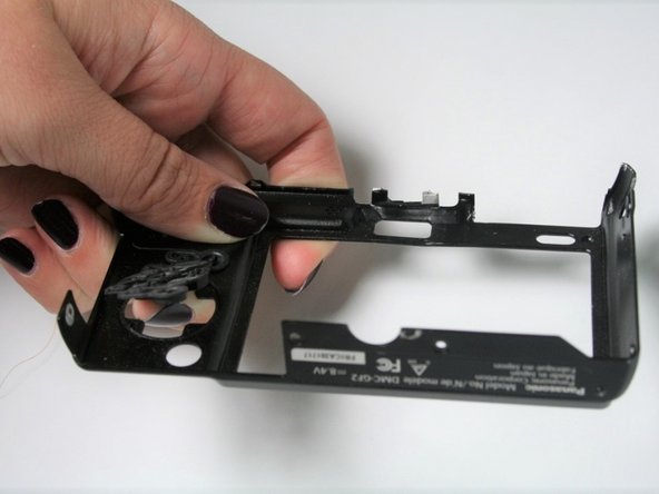

  9. Panasonic Lumix DMC-GF2 Back Panel Buttons Replacement: crwdns2935265:09crwdnd2935265:01crwdnd2935265:01crwdne2935265:0
    • Using a spudger, lift up and separate the heavier metal cover from the light, plastic back cover.
    • Metal cover may fall off without prying.
  10. Panasonic Lumix DMC-GF2 Back Panel Buttons Replacement, Back Panel Buttons: crwdns2935265:010crwdnd2935265:01crwdnd2935265:02crwdne2935265:0 Panasonic Lumix DMC-GF2 Back Panel Buttons Replacement, Back Panel Buttons: crwdns2935265:010crwdnd2935265:02crwdnd2935265:02crwdne2935265:0
    • Push on the back panel buttons from the frontside of the back cover.
    • There might be some adhesives holding the back panel buttons to the cover. Extra force may be necessary.
