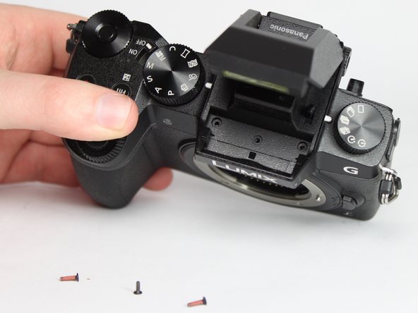

    • Use a Phillips PH0 screwdriver to remove the two indicated black 6.0mm long screws from top of camera, underneath the flash mechanism.
    • Remove the indicated black 4.0mm long screw from the top of the camera.

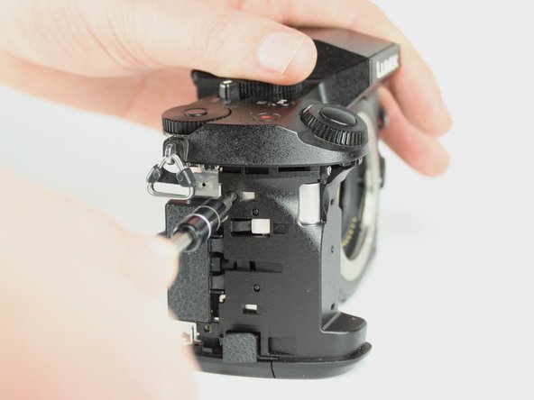

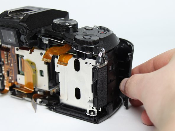

  13. Panasonic Lumix DMC-G7 Rear Thumbwheel Replacement: crwdns2935265:013crwdnd2935265:01crwdnd2935265:03crwdne2935265:0 Panasonic Lumix DMC-G7 Rear Thumbwheel Replacement: crwdns2935265:013crwdnd2935265:02crwdnd2935265:03crwdne2935265:0 Panasonic Lumix DMC-G7 Rear Thumbwheel Replacement: crwdns2935265:013crwdnd2935265:03crwdnd2935265:03crwdne2935265:0

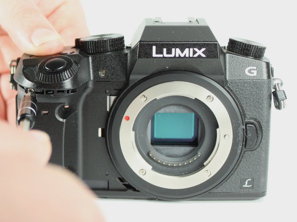

    • Remove the front grip from the camera by pulling it forward and out.
  14. Panasonic Lumix DMC-G7 Rear Thumbwheel Replacement: crwdns2935265:014crwdnd2935265:01crwdnd2935265:02crwdne2935265:0 Panasonic Lumix DMC-G7 Rear Thumbwheel Replacement: crwdns2935265:014crwdnd2935265:02crwdnd2935265:02crwdne2935265:0

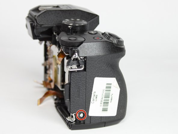

    • Remove the indicated black 4.0mm long screw from the side under the front cover using a Phillips PH0 screwdriver.
  15. Panasonic Lumix DMC-G7 Rear Thumbwheel Replacement: crwdns2935265:015crwdnd2935265:01crwdnd2935265:02crwdne2935265:0 Panasonic Lumix DMC-G7 Rear Thumbwheel Replacement: crwdns2935265:015crwdnd2935265:02crwdnd2935265:02crwdne2935265:0
    • Remove the indicated silver 5.0mm long screw from under the front cover using a Phillips PH0 screwdriver.

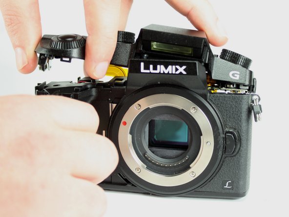

  16. Panasonic Lumix DMC-G7 Rear Thumbwheel Replacement: crwdns2935265:016crwdnd2935265:01crwdnd2935265:03crwdne2935265:0 Panasonic Lumix DMC-G7 Rear Thumbwheel Replacement: crwdns2935265:016crwdnd2935265:02crwdnd2935265:03crwdne2935265:0 Panasonic Lumix DMC-G7 Rear Thumbwheel Replacement: crwdns2935265:016crwdnd2935265:03crwdnd2935265:03crwdne2935265:0

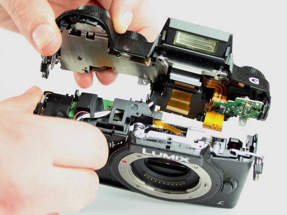

    • Lift the top unit away, separating it from the rest of the unit.

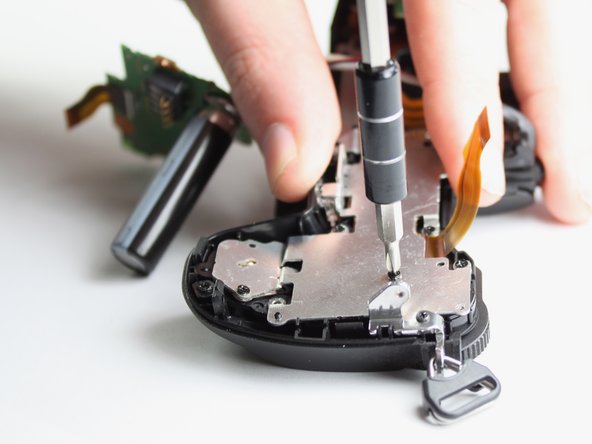

  17. Panasonic Lumix DMC-G7 Rear Thumbwheel Replacement: crwdns2935265:017crwdnd2935265:01crwdnd2935265:03crwdne2935265:0 Panasonic Lumix DMC-G7 Rear Thumbwheel Replacement: crwdns2935265:017crwdnd2935265:02crwdnd2935265:03crwdne2935265:0 Panasonic Lumix DMC-G7 Rear Thumbwheel Replacement: crwdns2935265:017crwdnd2935265:03crwdnd2935265:03crwdne2935265:0

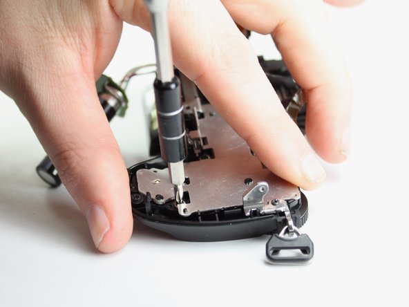

    • Remove the five indicated black 4.0mm long screws from the top plate shield using a Phillips PH0 screwdriver.
    • Remove the black 6.0 mm long screw from shoulder strap eyelet.
  18. Panasonic Lumix DMC-G7 Rear Thumbwheel Replacement: crwdns2935265:018crwdnd2935265:01crwdnd2935265:01crwdne2935265:0
    • Lift away the shoulder strap eyelet.
    • Lift away the metal shield plate.

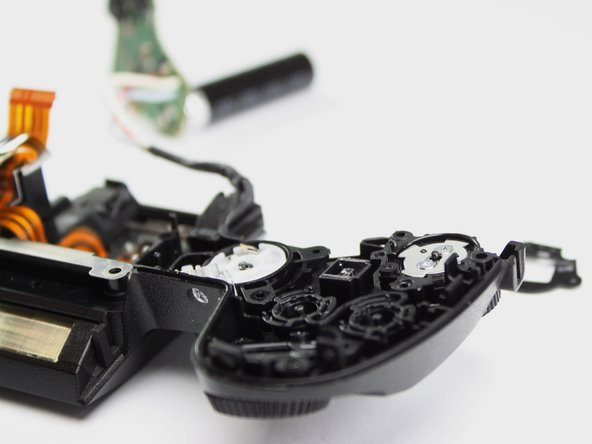

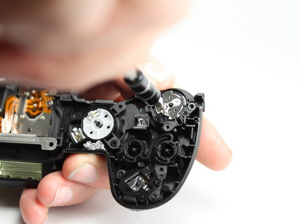

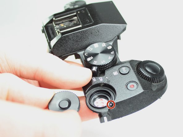

  19. Panasonic Lumix DMC-G7 Rear Thumbwheel Replacement: crwdns2935265:019crwdnd2935265:01crwdnd2935265:03crwdne2935265:0 Panasonic Lumix DMC-G7 Rear Thumbwheel Replacement: crwdns2935265:019crwdnd2935265:02crwdnd2935265:03crwdne2935265:0 Panasonic Lumix DMC-G7 Rear Thumbwheel Replacement: crwdns2935265:019crwdnd2935265:03crwdnd2935265:03crwdne2935265:0
    • Remove the indicated black 4.0 mm long screw using a Phillips PH0 screwdriver.
    • Lift away the circular plastic cover.
    • The parts indicated in orange are not retained and can fall out.

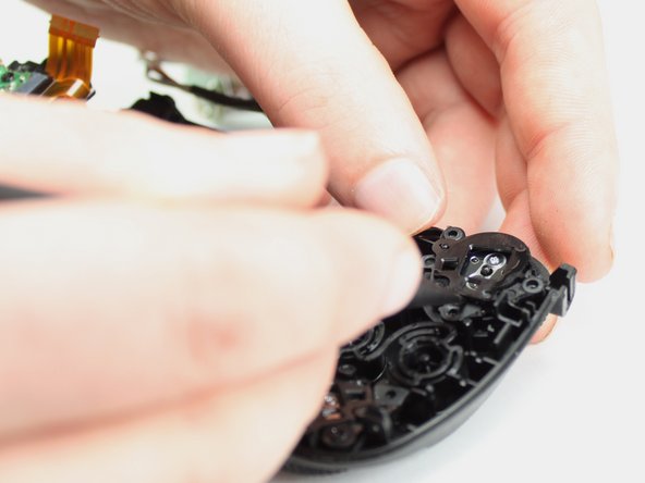

  20. Panasonic Lumix DMC-G7 Rear Thumbwheel Replacement: crwdns2935265:020crwdnd2935265:01crwdnd2935265:02crwdne2935265:0 Panasonic Lumix DMC-G7 Rear Thumbwheel Replacement: crwdns2935265:020crwdnd2935265:02crwdnd2935265:02crwdne2935265:0
    • Remove the two silver 4.0 mm long screws using a Phillips PH00 screwdriver.
    • Hold the wheel in place while unscrewing to prevent the wheel from spinning and hampering the removal of the screw.
    • Once the screws are removed, the metal lower and plastic upper are no longer retained. Pressure should be applied to prevent the pieces from falling apart.

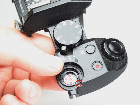

  21. Panasonic Lumix DMC-G7 Rear Thumbwheel Replacement: crwdns2935265:021crwdnd2935265:01crwdnd2935265:03crwdne2935265:0 Panasonic Lumix DMC-G7 Rear Thumbwheel Replacement: crwdns2935265:021crwdnd2935265:02crwdnd2935265:03crwdne2935265:0 Panasonic Lumix DMC-G7 Rear Thumbwheel Replacement: crwdns2935265:021crwdnd2935265:03crwdnd2935265:03crwdne2935265:0
    • Rotate the upper cover so that the plastic section of the rear thumbwheel is upright.
    • Carefully remove the plastic upper cover.
    • There is a small ball bearing, indicated in red, underneath the plastic cover. The bearing is spring loaded and can be lost easily if the cover is not upright.
