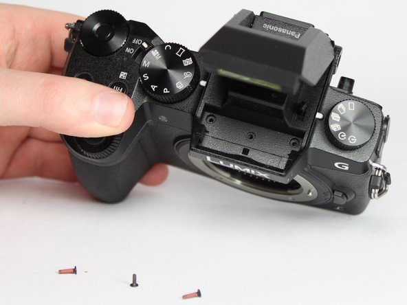

    • Use a PH0 Phillips screwdriver to remove the two indicated black 6.0mm long screws from the top of the camera, underneath the flash mechanism.
    • Remove the indicated black 4.0mm long screw from the top of the camera
  12. Panasonic Lumix DMC-G7 Flash Capacitor/Fuse Replacement: crwdns2935265:012crwdnd2935265:01crwdnd2935265:02crwdne2935265:0 Panasonic Lumix DMC-G7 Flash Capacitor/Fuse Replacement: crwdns2935265:012crwdnd2935265:02crwdnd2935265:02crwdne2935265:0
    • Remove the three indicated silver 5.0mm long screws from the back of the camera and the right side using a Phillips PH0 screwdriver.
    • The two screws on the back require a very thin screwdriver as they are only accessible through the holes on the back shield.

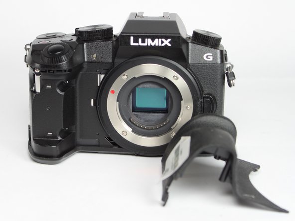

    • Remove the front grip from the camera by pulling it forward and out.

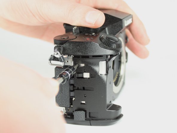

  14. Panasonic Lumix DMC-G7 Flash Capacitor/Fuse Replacement: crwdns2935265:014crwdnd2935265:01crwdnd2935265:02crwdne2935265:0 Panasonic Lumix DMC-G7 Flash Capacitor/Fuse Replacement: crwdns2935265:014crwdnd2935265:02crwdnd2935265:02crwdne2935265:0

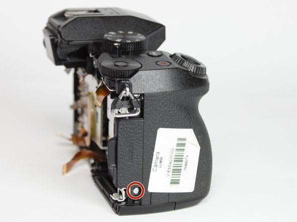

    • Remove the indicated black 4.0mm long screw from the side under the front cover using a Phillips PH0 screwdriver.
  15. Panasonic Lumix DMC-G7 Flash Capacitor/Fuse Replacement: crwdns2935265:015crwdnd2935265:01crwdnd2935265:02crwdne2935265:0 Panasonic Lumix DMC-G7 Flash Capacitor/Fuse Replacement: crwdns2935265:015crwdnd2935265:02crwdnd2935265:02crwdne2935265:0
    • Remove the indicated silver 5.0mm long screw from under the front cover using a Phillips PH0 screwdriver.

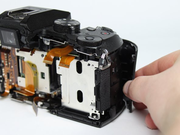

  16. Panasonic Lumix DMC-G7 Flash Capacitor/Fuse Replacement: crwdns2935265:016crwdnd2935265:01crwdnd2935265:03crwdne2935265:0 Panasonic Lumix DMC-G7 Flash Capacitor/Fuse Replacement: crwdns2935265:016crwdnd2935265:02crwdnd2935265:03crwdne2935265:0 Panasonic Lumix DMC-G7 Flash Capacitor/Fuse Replacement: crwdns2935265:016crwdnd2935265:03crwdnd2935265:03crwdne2935265:0

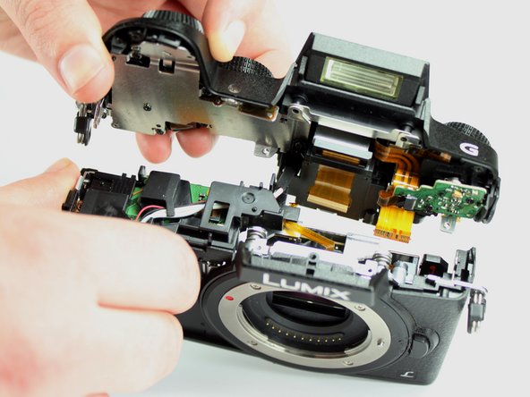

    • Lift the top unit away, separating it from the rest of the unit.

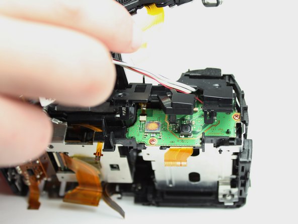

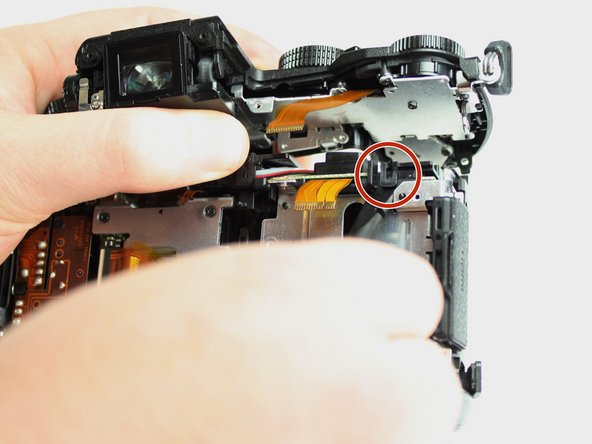

  17. Panasonic Lumix DMC-G7 Flash Capacitor/Fuse Replacement: crwdns2935265:017crwdnd2935265:01crwdnd2935265:03crwdne2935265:0 Panasonic Lumix DMC-G7 Flash Capacitor/Fuse Replacement: crwdns2935265:017crwdnd2935265:02crwdnd2935265:03crwdne2935265:0 Panasonic Lumix DMC-G7 Flash Capacitor/Fuse Replacement: crwdns2935265:017crwdnd2935265:03crwdnd2935265:03crwdne2935265:0
    • Pull the top panel away from the rest of the camera to reveal the flash wire and plastic cover.
    • Use a spudger (or other small prying tool) to release the locking tab on the plastic cover.
    • Pull the flash wire out under the plastic capacitor PCB cover. At the same time lift the cover away.
  18. Panasonic Lumix DMC-G7 Flash Capacitor/Fuse Replacement: crwdns2935265:018crwdnd2935265:01crwdnd2935265:03crwdne2935265:0 Panasonic Lumix DMC-G7 Flash Capacitor/Fuse Replacement: crwdns2935265:018crwdnd2935265:02crwdnd2935265:03crwdne2935265:0 Panasonic Lumix DMC-G7 Flash Capacitor/Fuse Replacement: crwdns2935265:018crwdnd2935265:03crwdnd2935265:03crwdne2935265:0
    • Remove the two indicated red 3.0mm long screws using a Phillips PH0 screwdriver.
    • Lift away the flash PCB.

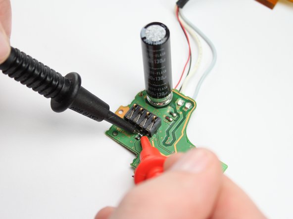

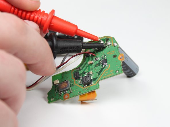

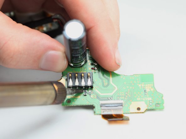

  19. Panasonic Lumix DMC-G7 Flash Capacitor/Fuse Replacement: crwdns2935265:019crwdnd2935265:01crwdnd2935265:03crwdne2935265:0 Panasonic Lumix DMC-G7 Flash Capacitor/Fuse Replacement: crwdns2935265:019crwdnd2935265:02crwdnd2935265:03crwdne2935265:0 Panasonic Lumix DMC-G7 Flash Capacitor/Fuse Replacement: crwdns2935265:019crwdnd2935265:03crwdnd2935265:03crwdne2935265:0
    • Caution: Be careful not to touch the capacitor wires as you work. If possible, use a capacitor discharge probe to safely rid the capacitors of dangerous charges.
    • Determine if the capacitor or the fuse has failed. Using a Capacitance meter measure the capacitor, it should report a value of 130µF.
    • If the capacitor value reported is close, then use a voltmeter with continuity testing to probe the fuse. If there is no continuity, then the fuse is broken.
    • If the capacitor is the failure point, go to step 20 and stop there. Otherwise, if it is the fuse, skip to step 21.

    • Heat and remove the indicated solder on the two capacitor contact points.
    • Solder wick or a solder pump is recommended for removing solder.
    • Pull the flash capacitor away from the PCB.
