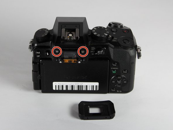

  4. Panasonic Lumix DMC-G7 Electronic Viewfinder Replacement: crwdns2935265:04crwdnd2935265:01crwdnd2935265:03crwdne2935265:0 Panasonic Lumix DMC-G7 Electronic Viewfinder Replacement: crwdns2935265:04crwdnd2935265:02crwdnd2935265:03crwdne2935265:0 Panasonic Lumix DMC-G7 Electronic Viewfinder Replacement: crwdns2935265:04crwdnd2935265:03crwdnd2935265:03crwdne2935265:0
    • Remove the viewfinder eye cup by pulling up and out from the bottom to separate the locking clips from the camera.
    • Do not flex the eye cup too aggressively as it may lose its shape.
    • Remove the two indicated silver 3.5mm long screws adjacent to the viewfinder screen using a PH0 Phillips screwdriver.

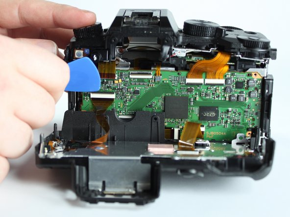

    • Use an iFixit opening tool (or similarly long and thin object) to insert into the gap between the two camera halves and pry the camera apart from the top.

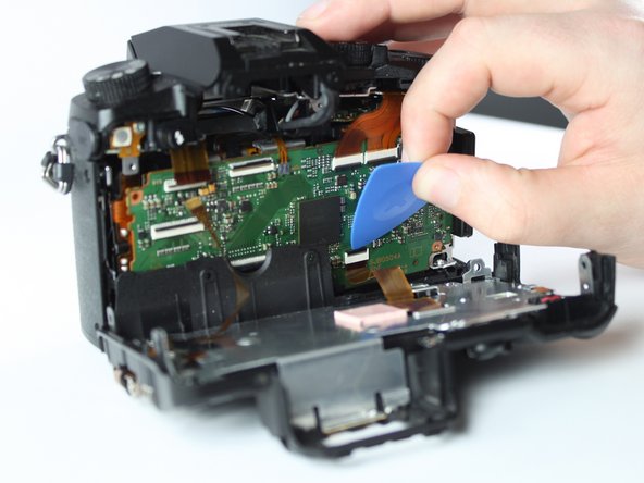

    • Remove the two indicated ribbon cables before separating the two halves of the camera.
    • Using a flat object, pry open the black tabs above the ribbon cable connectors by gently pulling away from the motherboard.
    • An opening pick is recommended, but any equally small and flat object will work.
    • Ribbon cables are fragile, so put as little stress on them as possible.

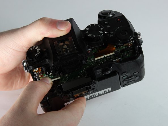

  7. Panasonic Lumix DMC-G7 Electronic Viewfinder Replacement: crwdns2935265:07crwdnd2935265:01crwdnd2935265:02crwdne2935265:0 Panasonic Lumix DMC-G7 Electronic Viewfinder Replacement: crwdns2935265:07crwdnd2935265:02crwdnd2935265:02crwdne2935265:0
    • Remove the 4 indicated flex cables from top of mainboard
    • Remove the indicated small flex cable from top of mainboard.
    • The small flex cable does not have a lock: simply pull to disconnect it.

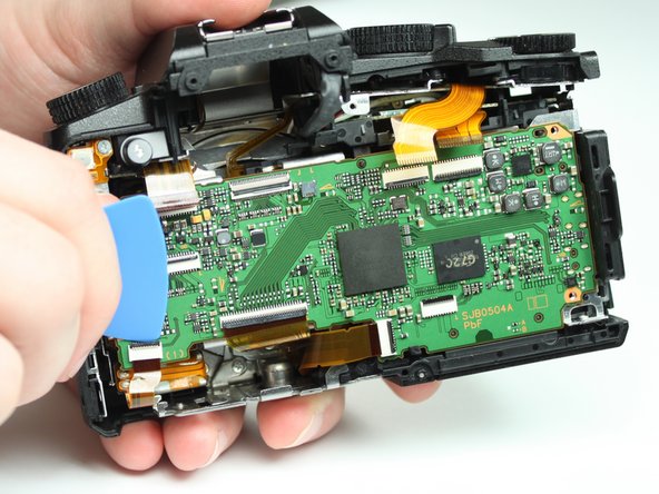

    • Remove the 4 indicated red 3.0mm long screws from the corners of mainboard using a Phillips PH0 screwdriver.
    • With the eyepiece facing away from you, pull up on the main PCB from the left side and then pull it away from the chassis.
    • There is a plastic locking tab on the bottom of the camera that holds the mainboard PCB.
    • A replacement mainboard can be purchased from AliExpress here

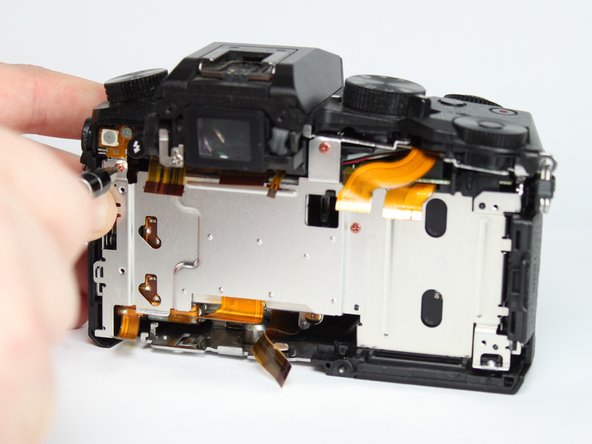

    • Remove the three indicated silver 5.0mm long screws from the back of the camera and the right side using a Phillips PH0 screwdriver.
    • The two screws on the back require a very thin screwdriver as they are only accessible through the holes on the back shield.

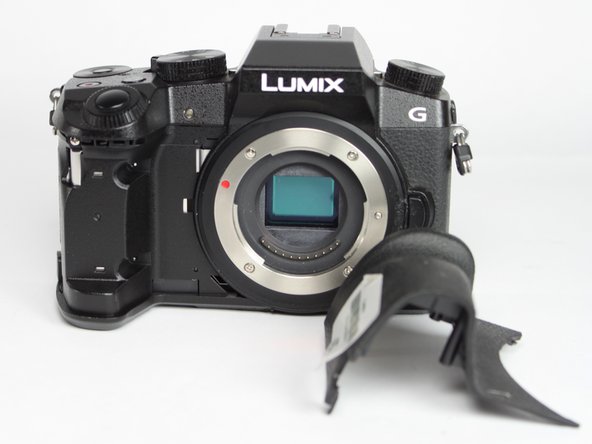

  13. Panasonic Lumix DMC-G7 Electronic Viewfinder Replacement: crwdns2935265:013crwdnd2935265:01crwdnd2935265:03crwdne2935265:0 Panasonic Lumix DMC-G7 Electronic Viewfinder Replacement: crwdns2935265:013crwdnd2935265:02crwdnd2935265:03crwdne2935265:0 Panasonic Lumix DMC-G7 Electronic Viewfinder Replacement: crwdns2935265:013crwdnd2935265:03crwdnd2935265:03crwdne2935265:0

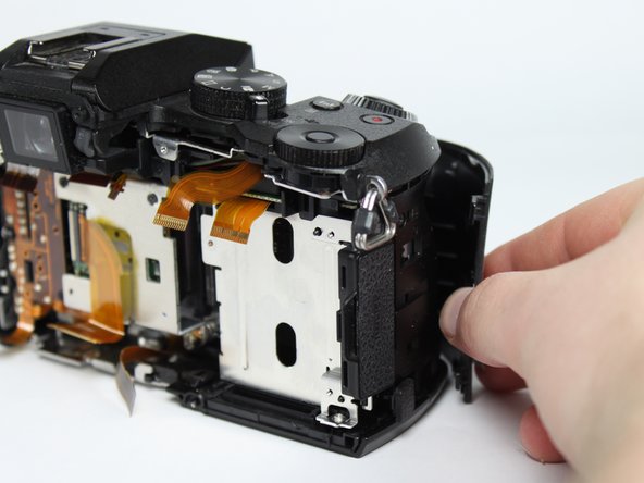

    • Remove the front grip from the camera by pulling it forward and out.

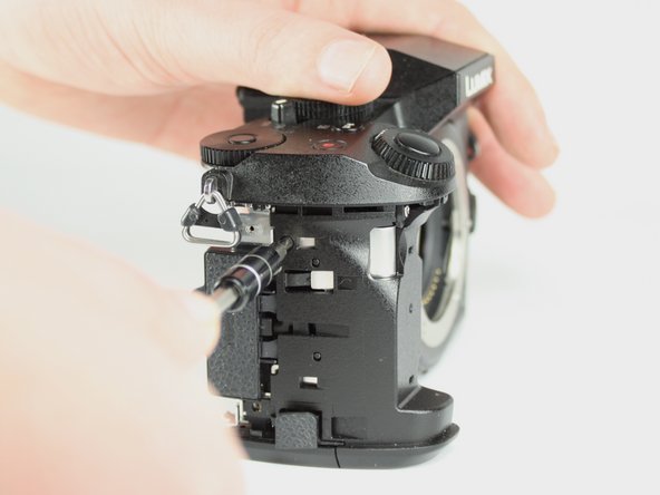

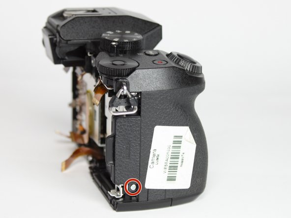

  14. Panasonic Lumix DMC-G7 Electronic Viewfinder Replacement: crwdns2935265:014crwdnd2935265:01crwdnd2935265:02crwdne2935265:0 Panasonic Lumix DMC-G7 Electronic Viewfinder Replacement: crwdns2935265:014crwdnd2935265:02crwdnd2935265:02crwdne2935265:0
    • Remove the indicated black 4.0mm long screw from the side under the front cover using a Phillips PH0 screwdriver.

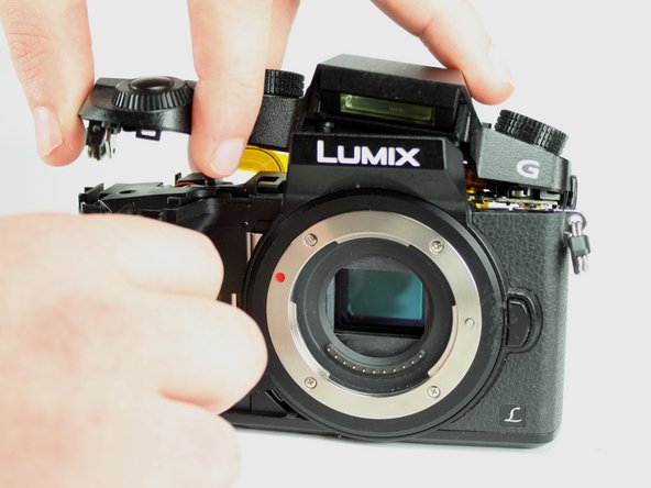

  16. Panasonic Lumix DMC-G7 Electronic Viewfinder Replacement: crwdns2935265:016crwdnd2935265:01crwdnd2935265:03crwdne2935265:0 Panasonic Lumix DMC-G7 Electronic Viewfinder Replacement: crwdns2935265:016crwdnd2935265:02crwdnd2935265:03crwdne2935265:0 Panasonic Lumix DMC-G7 Electronic Viewfinder Replacement: crwdns2935265:016crwdnd2935265:03crwdnd2935265:03crwdne2935265:0

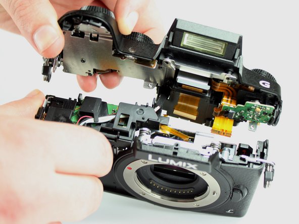

    • Lift the top unit away, separating it from the rest of the unit.

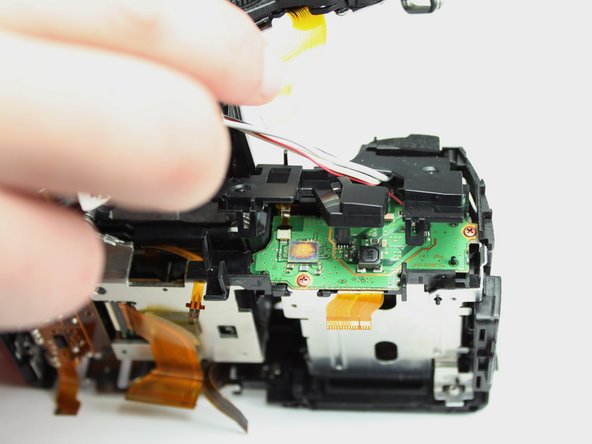

  17. Panasonic Lumix DMC-G7 Electronic Viewfinder Replacement: crwdns2935265:017crwdnd2935265:01crwdnd2935265:03crwdne2935265:0 Panasonic Lumix DMC-G7 Electronic Viewfinder Replacement: crwdns2935265:017crwdnd2935265:02crwdnd2935265:03crwdne2935265:0 Panasonic Lumix DMC-G7 Electronic Viewfinder Replacement: crwdns2935265:017crwdnd2935265:03crwdnd2935265:03crwdne2935265:0
    • Pull the top panel away from the rest of the camera to reveal the flash wire and plastic cover.
    • Use a spudger (or other small prying tool) to release the locking tab on the plastic cover.
    • Pull the flash wire out under the plastic capacitor PCB cover. At the same time lift the cover away.

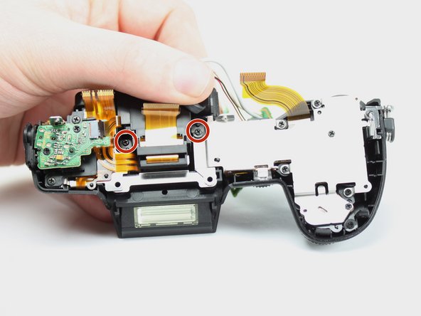

    • Remove the two indicated black 6.0mm long screws next to the viewfinder unit using a Phillips PH0 screwdriver.

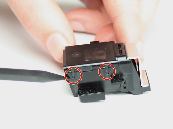

  20. Panasonic Lumix DMC-G7 Electronic Viewfinder Replacement: crwdns2935265:020crwdnd2935265:01crwdnd2935265:03crwdne2935265:0 Panasonic Lumix DMC-G7 Electronic Viewfinder Replacement: crwdns2935265:020crwdnd2935265:02crwdnd2935265:03crwdne2935265:0 Panasonic Lumix DMC-G7 Electronic Viewfinder Replacement: crwdns2935265:020crwdnd2935265:03crwdnd2935265:03crwdne2935265:0

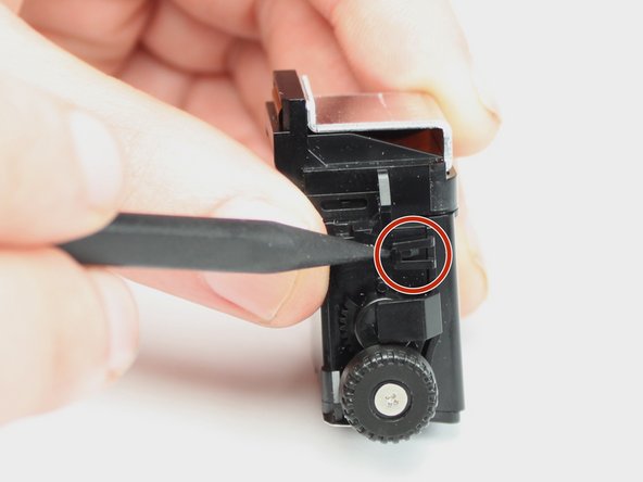

    • Disconnect the four indicated locking tabs and remove the LVF module from the mounting unit using a spudger (or other small prying tool).
