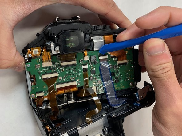

  5. Panasonic Lumix DMC-G5 Motherboard Replacement: crwdns2935265:05crwdnd2935265:01crwdnd2935265:03crwdne2935265:0 Panasonic Lumix DMC-G5 Motherboard Replacement: crwdns2935265:05crwdnd2935265:02crwdnd2935265:03crwdne2935265:0 Panasonic Lumix DMC-G5 Motherboard Replacement: crwdns2935265:05crwdnd2935265:03crwdnd2935265:03crwdne2935265:0
    • Gently remove the back panel from the camera.
    • Unclip the ribbon cable from the motherboard using Wide Plastic Opening Tools and pull the cable gently.
  6. Panasonic Lumix DMC-G5 Motherboard Replacement, Motherboard: crwdns2935265:06crwdnd2935265:01crwdnd2935265:01crwdne2935265:0
    • Remove the JIS #000 screws on the motherboard.
  7. Panasonic Lumix DMC-G5 Motherboard Replacement: crwdns2935265:07crwdnd2935265:01crwdnd2935265:02crwdne2935265:0 Panasonic Lumix DMC-G5 Motherboard Replacement: crwdns2935265:07crwdnd2935265:02crwdnd2935265:02crwdne2935265:0
    • Unclip the ribbon cable using the Wide Plastic Opening Tool on the motherboard.
    • Gently pull out the cable.
  8. Panasonic Lumix DMC-G5 Motherboard Replacement: crwdns2935265:08crwdnd2935265:01crwdnd2935265:01crwdne2935265:0
    • Pull out the motherboard from the camera.
