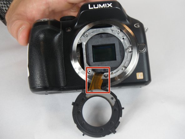

    • Use the Thin Plastic Opening Tool to release the black connection ring.
    • Insert the tool underneath the right side of the black ring to improve leverage.
    • Let the ring fall forward to reveal its underside.
    • Take care not to disconnect the filament connections from the camera as they can be very difficult to reconnect.
  4. Panasonic Lumix DMC-G5 Lens Connection Assembly Replacement: crwdns2935265:04crwdnd2935265:01crwdnd2935265:02crwdne2935265:0 Panasonic Lumix DMC-G5 Lens Connection Assembly Replacement: crwdns2935265:04crwdnd2935265:02crwdnd2935265:02crwdne2935265:0

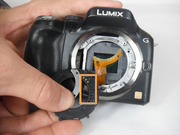

    • Remove the two 2.7mm J000 phillips screws from the mount ring which connect to the ribbon of filament connections.
    • There are many small golden-colored springs and rivets within the black ring connector. They will fall out if held upside down. When reassembling, they should be in contact with the gold plating of the filament connection.
