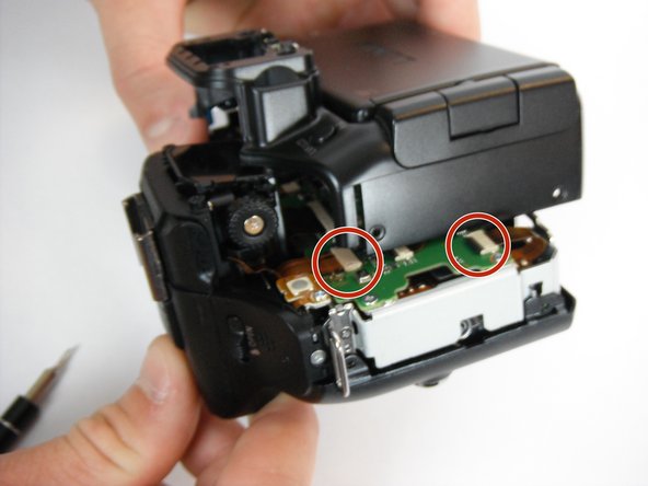

    • Remove the four 4.6mm J000 Phillips screws from the sides and two 3.2mm J000 Phillips screws along the bottom.

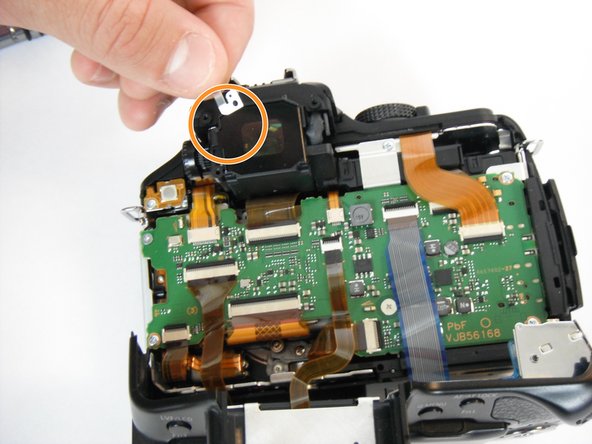

  2. Panasonic Lumix DMC-G5 Diopter Adjustment Dial Replacement: crwdns2935265:02crwdnd2935265:01crwdnd2935265:03crwdne2935265:0 Panasonic Lumix DMC-G5 Diopter Adjustment Dial Replacement: crwdns2935265:02crwdnd2935265:02crwdnd2935265:03crwdne2935265:0 Panasonic Lumix DMC-G5 Diopter Adjustment Dial Replacement: crwdns2935265:02crwdnd2935265:03crwdnd2935265:03crwdne2935265:0
    • Remove the two 3.2mm J000 Phillips screws located on the bottom edge of the viewfinder cover.
    • Carefully remove the viewfinder cover.
    • Remove the two 4.4mm J000 Phillips screws located near the top edge of the viewfinder.

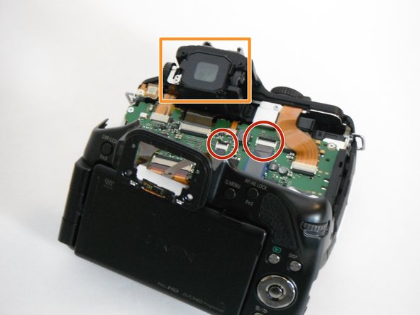

  3. Panasonic Lumix DMC-G5 Diopter Adjustment Dial Replacement: crwdns2935265:03crwdnd2935265:01crwdnd2935265:03crwdne2935265:0 Panasonic Lumix DMC-G5 Diopter Adjustment Dial Replacement: crwdns2935265:03crwdnd2935265:02crwdnd2935265:03crwdne2935265:0 Panasonic Lumix DMC-G5 Diopter Adjustment Dial Replacement: crwdns2935265:03crwdnd2935265:03crwdnd2935265:03crwdne2935265:0
    • Slide the Wide Plastic Opening Tool upwards along the underside of the rear casing.
    • Be careful not to disconnect the filament connections. Reinserting them can be difficult.
    • Slowly lower the casing into the position shown.

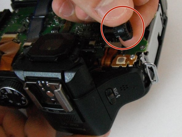

  4. Panasonic Lumix DMC-G5 Diopter Adjustment Dial Replacement: crwdns2935265:04crwdnd2935265:01crwdnd2935265:02crwdne2935265:0 Panasonic Lumix DMC-G5 Diopter Adjustment Dial Replacement: crwdns2935265:04crwdnd2935265:02crwdnd2935265:02crwdne2935265:0
    • Use the Screwdriver J000 Phillips Head to remove the screw located at the lower-left corner of the face of the viewfinder glass.
    • Carefully lift the L-shaped clicker underneath the previously removed screw.
  5. Panasonic Lumix DMC-G5 Diopter Adjustment Dial Replacement: crwdns2935265:05crwdnd2935265:01crwdnd2935265:02crwdne2935265:0 Panasonic Lumix DMC-G5 Diopter Adjustment Dial Replacement: crwdns2935265:05crwdnd2935265:02crwdnd2935265:02crwdne2935265:0
    • Slide the faulty diopter adjustment dial off the rod.
    • Replace the diopter dial with a 1-cm wheel.
