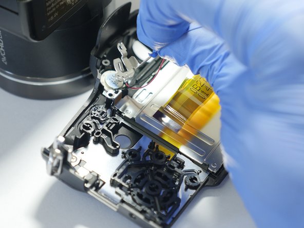

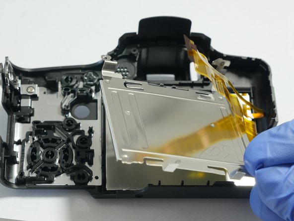

  5. Panasonic Lumix DMC-FZ35 LCD Replacement, Accessing the flex cables: crwdns2935265:05crwdnd2935265:01crwdnd2935265:02crwdne2935265:0 Panasonic Lumix DMC-FZ35 LCD Replacement, Accessing the flex cables: crwdns2935265:05crwdnd2935265:02crwdnd2935265:02crwdne2935265:0
    • Please be careful. Do not lift the cover fully because it is still attached to the Main Board via flex cables.
    • Lift the cover slightly as shown in picture # 1
    • Tilt the back cover as shown in picture #2. Be careful because the flex cables are still attached.

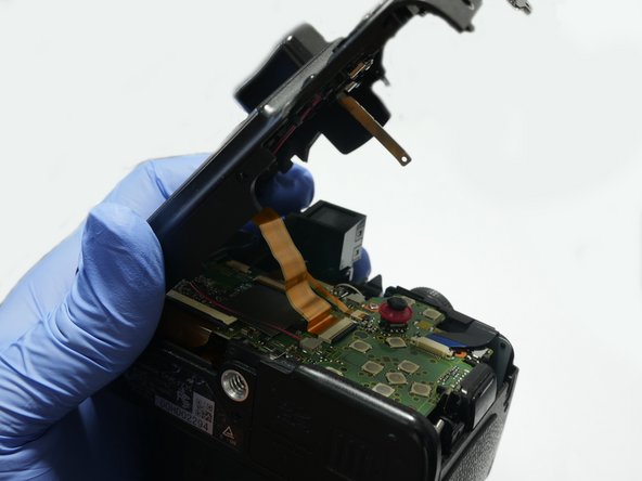

  6. Panasonic Lumix DMC-FZ35 LCD Replacement, Release the Flex cables: crwdns2935265:06crwdnd2935265:01crwdnd2935265:03crwdne2935265:0 Panasonic Lumix DMC-FZ35 LCD Replacement, Release the Flex cables: crwdns2935265:06crwdnd2935265:02crwdnd2935265:03crwdne2935265:0 Panasonic Lumix DMC-FZ35 LCD Replacement, Release the Flex cables: crwdns2935265:06crwdnd2935265:03crwdnd2935265:03crwdne2935265:0
    • Flip up LCD cable clamp with a spudger or other tool.
    • Flip up backlite cable clamp with a spudger or other tool
    • Removal of the mic wire is optional. My suggestion is to leave it attached. The mic can get damaged if you pull on the wire.

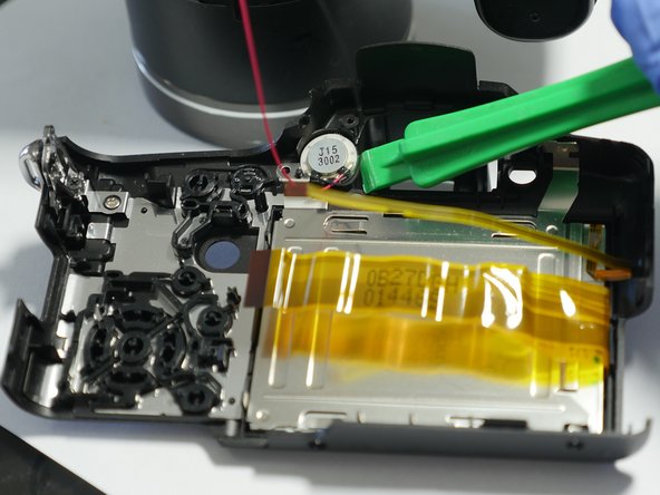

  7. Panasonic Lumix DMC-FZ35 LCD Replacement, Remove the mic: crwdns2935265:07crwdnd2935265:01crwdnd2935265:03crwdne2935265:0 Panasonic Lumix DMC-FZ35 LCD Replacement, Remove the mic: crwdns2935265:07crwdnd2935265:02crwdnd2935265:03crwdne2935265:0 Panasonic Lumix DMC-FZ35 LCD Replacement, Remove the mic: crwdns2935265:07crwdnd2935265:03crwdnd2935265:03crwdne2935265:0
    • Remove the 2 screws (0.4mm) that are holding the mic assembly
    • Next step (shown in picture #2) remove the metal mic hold part.
    • Next step (shown in picture #3) use a spudger to pry off the mic. Careful not to damage the wiring.

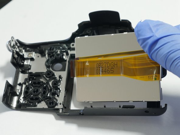

  8. Panasonic Lumix DMC-FZ35 LCD Replacement, Remove the LCD: crwdns2935265:08crwdnd2935265:01crwdnd2935265:03crwdne2935265:0 Panasonic Lumix DMC-FZ35 LCD Replacement, Remove the LCD: crwdns2935265:08crwdnd2935265:02crwdnd2935265:03crwdne2935265:0 Panasonic Lumix DMC-FZ35 LCD Replacement, Remove the LCD: crwdns2935265:08crwdnd2935265:03crwdnd2935265:03crwdne2935265:0
    • Release the hold clips that hold the LCD retainer in place.
    • Remove the LCD metal retainer plate as shown in picture #2
    • Remove the LCD as shown in picture # 3
  9. Panasonic Lumix DMC-FZ35 LCD Replacement, Swap out Old LCD: crwdns2935265:09crwdnd2935265:01crwdnd2935265:01crwdne2935265:0
    • Swap out your old LCD with the new one.
    • If your backlite is ok you can buy only the LCD Display. But it is easier to purchase the LCD with the backlite attached. Replacement LCD Display VYQ5034
