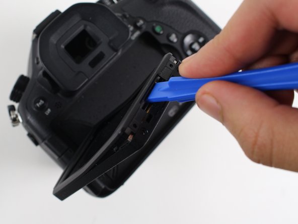

  4. Panasonic Lumix DMC-FZ1000 Screen Replacement: crwdns2935265:04crwdnd2935265:01crwdnd2935265:03crwdne2935265:0 Panasonic Lumix DMC-FZ1000 Screen Replacement: crwdns2935265:04crwdnd2935265:02crwdnd2935265:03crwdne2935265:0 Panasonic Lumix DMC-FZ1000 Screen Replacement: crwdns2935265:04crwdnd2935265:03crwdnd2935265:03crwdne2935265:0
    • In this step you will pry off the two sides of the screen's plastic casing. Do not yank off the side that holds the glass screen. If you do, you will tear the electronic ribbon attached to the screen and the screen axle.
    • Use a plastic opening tool to pry open the plastic screen casing. It might be easiest to start prying near the screen mount, and then work your way around the casing.
    • Hold on to the side that houses the glass screen. Set down the side that says LUMIX.
