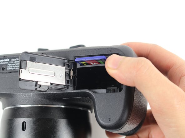

    • Slide the switch on the bottom of your camera from the right (LOCK) to the left (OPEN).
    • The battery door will swing open.
  2. Panasonic Lumix DMC-FZ1000 Motherboard Replacement: crwdns2935265:02crwdnd2935265:01crwdnd2935265:02crwdne2935265:0 Panasonic Lumix DMC-FZ1000 Motherboard Replacement: crwdns2935265:02crwdnd2935265:02crwdnd2935265:02crwdne2935265:0
    • Pull down on the lever that holds the battery.
    • The battery will pop out of its casing.
  3. Panasonic Lumix DMC-FZ1000 Motherboard Replacement: crwdns2935265:03crwdnd2935265:01crwdnd2935265:01crwdne2935265:0
    • Pull out the battery.
  4. Panasonic Lumix DMC-FZ1000 Motherboard Replacement, Motherboard: crwdns2935265:04crwdnd2935265:01crwdnd2935265:03crwdne2935265:0 Panasonic Lumix DMC-FZ1000 Motherboard Replacement, Motherboard: crwdns2935265:04crwdnd2935265:02crwdnd2935265:03crwdne2935265:0 Panasonic Lumix DMC-FZ1000 Motherboard Replacement, Motherboard: crwdns2935265:04crwdnd2935265:03crwdnd2935265:03crwdne2935265:0

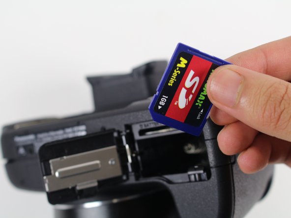

    • Push in on the SD card inside the battery housing.
    • The SD card will pop out.
    • Pull out the SD card.
    • Close the battery housing door.

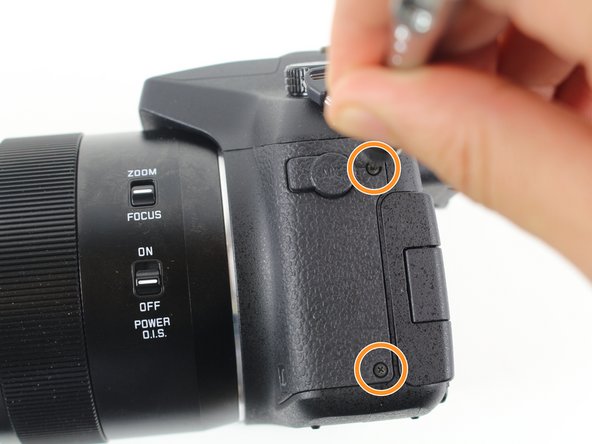

    • Remove the two 5.2 mm Phillips #00 screws that are 1) below the label and 2) above the tripod mount hole on the bottom of the camera.
    • You may ignore the screw below the tripod mount hole.
    • Remove the two 5.5 mm Phillips #00 screws on the side of the camera with the MIC jack.
    • Remove the two 7.0 mm Phillips #00 screws that are 1) above and 2) below the HDMI panel.
    • You may ignore the screw that goes through the leather material to the right of the HDMI panel.
    • There are two screws that hold the eye piece on to the main housing, just underneath. Remove these. Once these have been removed, gently pull and remove the eye piece and remove the now accessible top two screws.

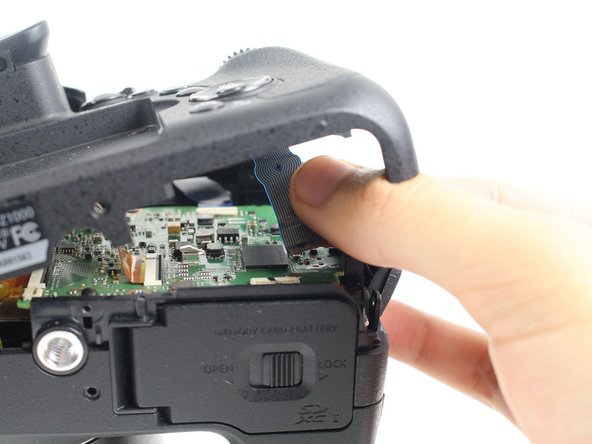

    • Do not yank off the back plate. If you do, you will tear the electronic ribbons attached to the inside of the camera and the back plate.
    • Gently lift up the back plate, being careful not to damage any ribbons.
    • Do not yank out the electronic ribbons attached to the motherboard and the back plate, or you may damage them. To properly detach these ZIF connector ribbons, see this technique on disconnecting ZIF connectors.
    • Pull to disconnect from the motherboard the two ZIF connector ribbons attached to the back plate.
    • Set aside the back plate.

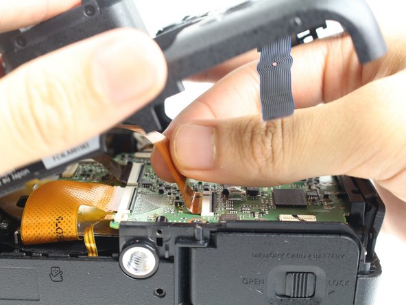

  7. Panasonic Lumix DMC-FZ1000 Motherboard Replacement: crwdns2935265:08crwdnd2935265:01crwdnd2935265:01crwdne2935265:0
    • Do not yank out the electronic ribbons attached to the motherboard, or you may damage them. To properly detach these ZIF connector ribbons, see this technique on disconnecting ZIF connectors.
    • Pull to disconnect from the motherboard the seven ZIF connector ribbons.

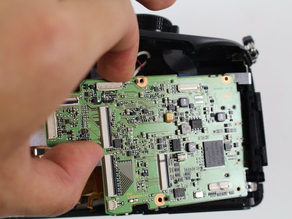

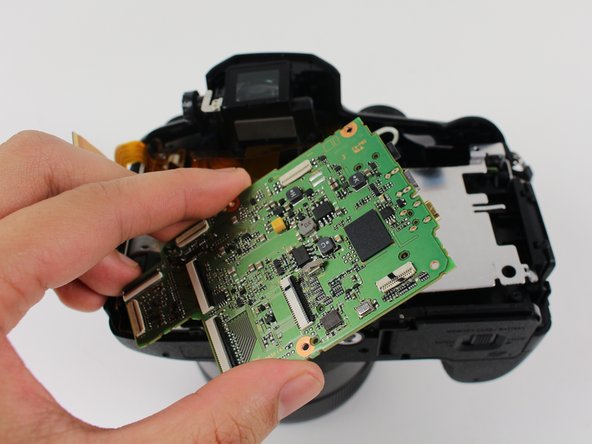

    • Firmly grasp the left side of the motherboard.
    • Pull out the motherboard.
    • If you find it difficult to remove the motherboard, pull it away from the HDMI panel while pulling it out.
