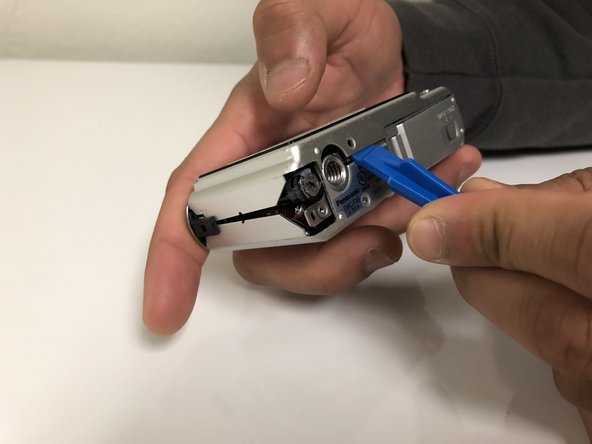

    • Remove the screws on the bottom side of the camera using the Philips #00 Screwdriver.
    • Separate the covers by gently applying force upwards, carefully placing the opening tool between the two covers.

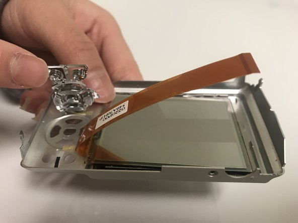

    • Lift the ZIF tabs up with the opening tool and carefully remove the digitizer ribbon cables.
    • Remove the LCD Screen from the glass frame carefully with the opening tool.
  6. Panasonic Lumix DMC-FX9 Selector Buttons Replacement: crwdns2935265:06crwdnd2935265:01crwdnd2935265:02crwdne2935265:0 Panasonic Lumix DMC-FX9 Selector Buttons Replacement: crwdns2935265:06crwdnd2935265:02crwdnd2935265:02crwdne2935265:0
    • Push on the back panel buttons on the front side to remove the buttons.
    • Be cautious of the adhesive holding the button panels to the cover. Apply extra force if necessary.
