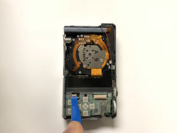

  5. Panasonic Lumix DMC-FX9 Screen Replacement: crwdns2935265:05crwdnd2935265:01crwdnd2935265:03crwdne2935265:0 Panasonic Lumix DMC-FX9 Screen Replacement: crwdns2935265:05crwdnd2935265:02crwdnd2935265:03crwdne2935265:0 Panasonic Lumix DMC-FX9 Screen Replacement: crwdns2935265:05crwdnd2935265:03crwdnd2935265:03crwdne2935265:0
    • There are two digitizer cables that connect the LCD Screen to the camera motherboard.
    • The digitizer cables are held down by retaining flats.
    • Carefully use the opening tool to push the retaining flats upward to allow the digitizer cables to disconnect.
